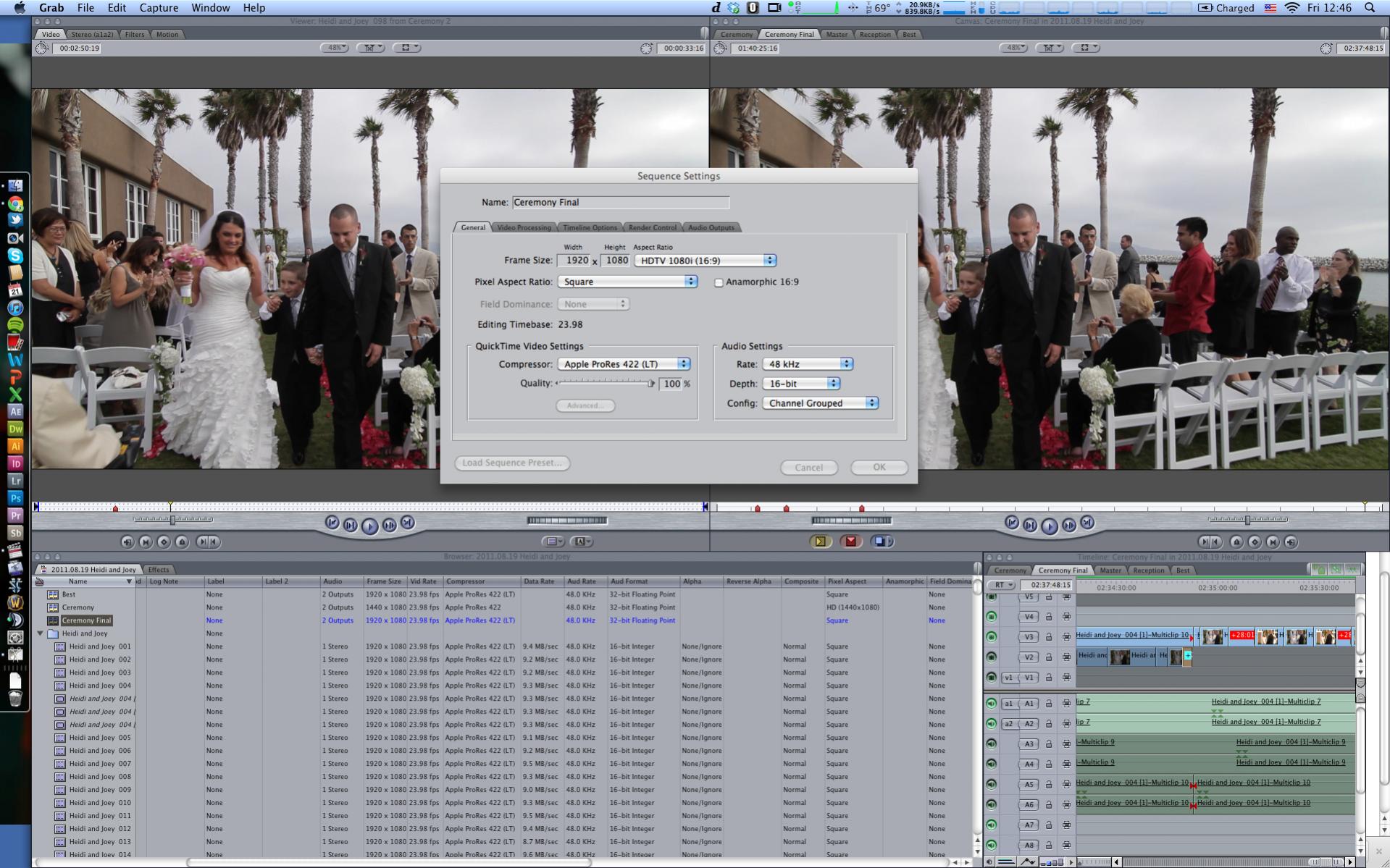

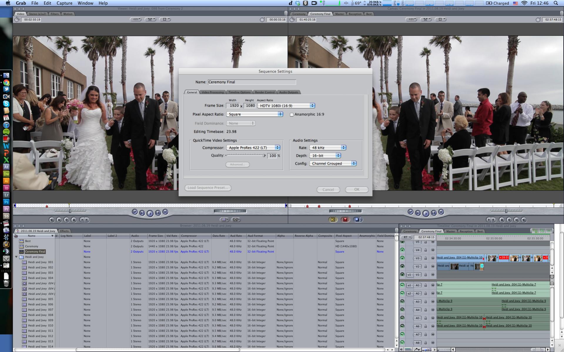

I'm using Prores 422 LT and I'm getting the dropped frames warning every few min. I'm on a esata connection so I should be getting any at all. When I look at my disk activity, I'm barely 35 MB/s. Can anyone help me?
2011 MBP 2.2 i7 Quad Core. Playback settings? And yea, it's 1080p but it's not even getting close to the limit of esata.
Playback settings?

Odds are, there's nothing wrong with your machine. What you have should chew through this kind of footage. Check your sequence settings by going to Sequence -> Settings in the menu bar. Make sure that the settings exactly match the footage you're using. If it doesn't, final cut will be trying to transpose each frame to the new format during playback.
An easy way to check the correct settings for your footage is to make a new sequence and immediately drag a piece of footage into the timeline. FCP will ask you if you want to change sequence settings to match the footage. You say yes, then check that sequence's settings.
Your settings look fine. Doesn't look like that's your problem.

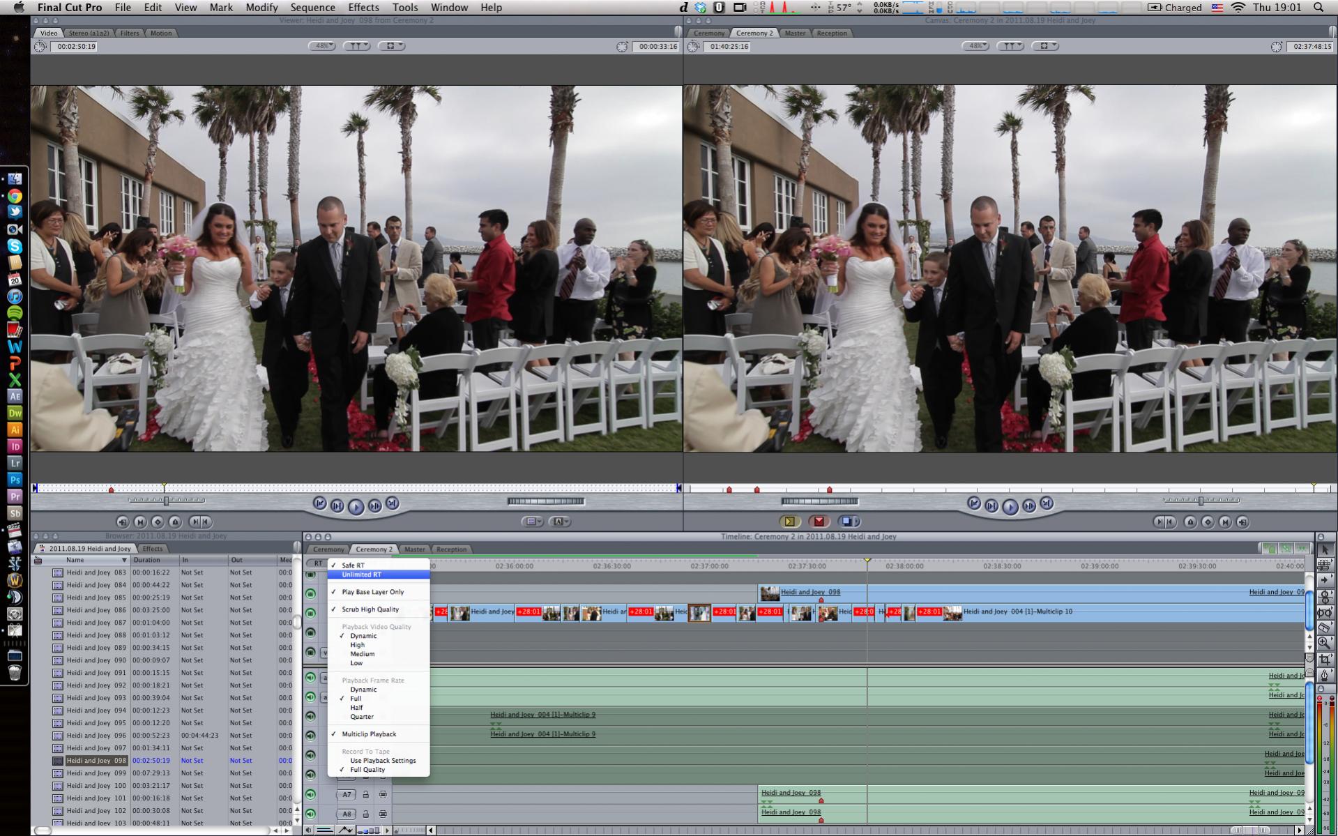

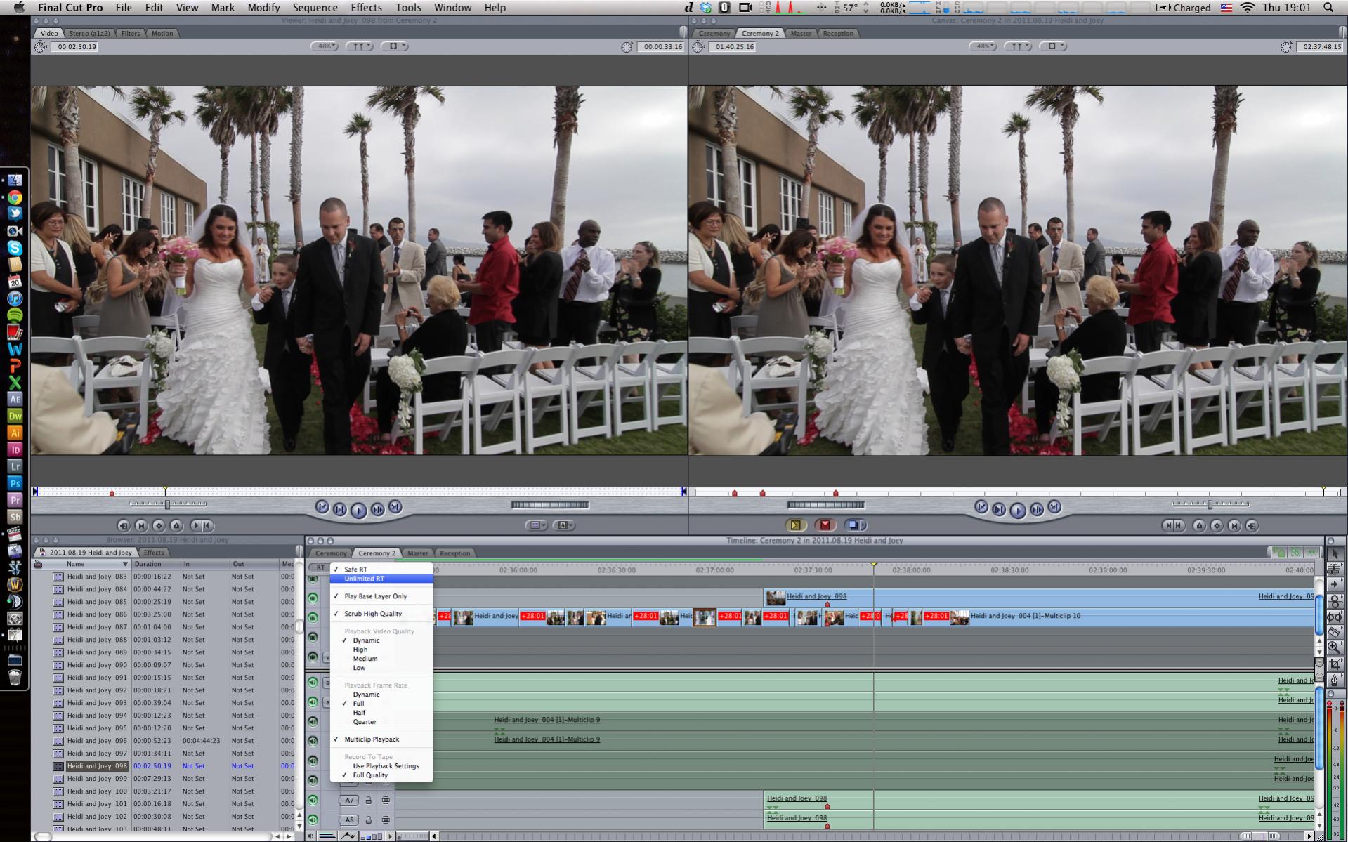

Nope. Still the same problem. Playing 1/2 of the frames helps but obviously, it's not as smooth.

I have just been doing some multiclip editing today from a 4 disc (RAID 5) Firewire 800 drive and my media was also ProRes (LT). I had 4 streams of data and the only way I could get it to play was by lowering the playback quality to "Low". Even then I was getting the odd dropped frame.
