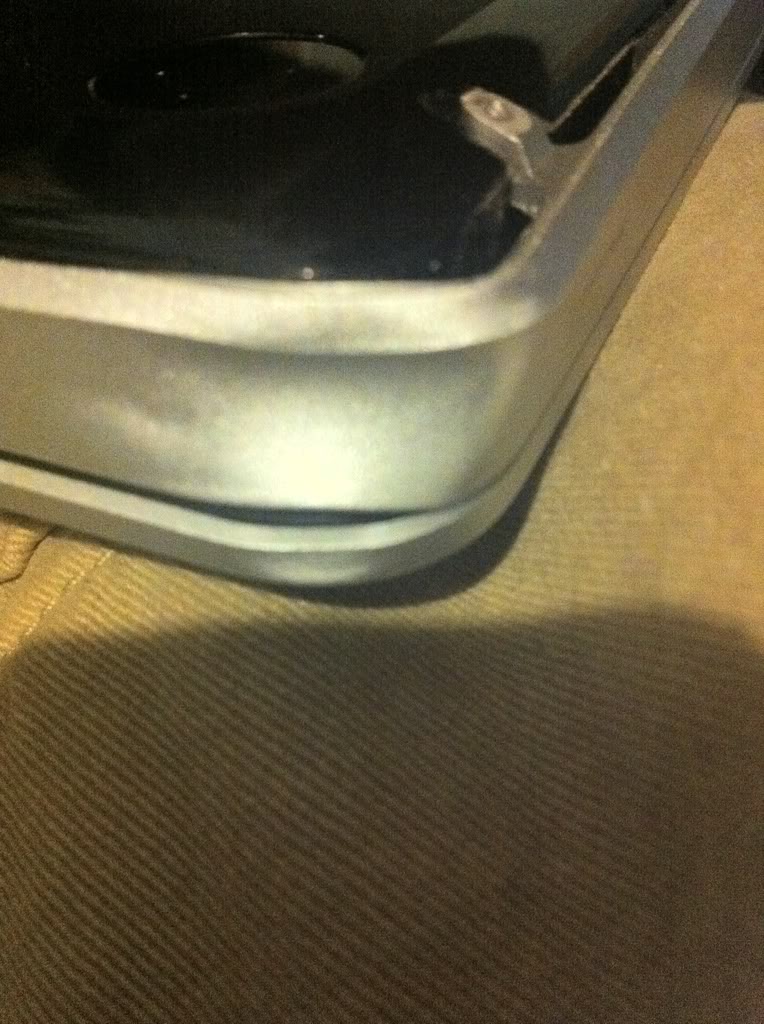

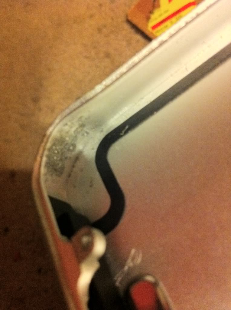

I had my laptop in an incase sleeve when it dropped onto the right corner from about 1.5 feet. it was all good except for a small dent, until about three days later. Now it won't charge.
I unscrewed the computer and removed the top. It looks like the corner that is dented is pressing against the battery(I've enclosed pictures).
Do I have any chance of just taking the battery out and manoeuvring the aluminum to the right spots?
How much will it cost to repair if I can't fix it? Any chance at all that it might be covered(I have AppleCare, but I know its a longshot)?

But do you guys think it's worth the effort to remove the battery and try to push the aluminum into the right place? The warranty sticker was already disconnected because apple had to tamper with the battery for my last repair.
If you think it might be possible(even with a lot of effort) I'll buy a tri-wing screwdriver and try it.

why not? ... you got nothing to lose ... just be careful
Ouch that a good size dent. Have you tried the basics on resetting the SMC and PRAM. Its worth a shot. As for the damage looks like you need to replace the top cover. I did this on my current MBP and let me tell you that if you plan on doing this you have to almost completely remove the whole insides of the computer to replace the top. I ordered my top assembly from Here I hope this helps. Also if you plan on taking it apart iFixit has great repair guides..

I don't know why it didn't work but the site is called usedmac.com. As for the battery issue yes you can remove it and use the charger to power it up. What model MBP do you have? As I do have an extra top casing that I replaced on my 13" MBP.

I'm working on getting the dent out. It's a slow process, but I'm definitely making progress.
Here's some update photos after about 45 minutes of tedious hammering(screwdriver through washcloth to protect from puncturing).
