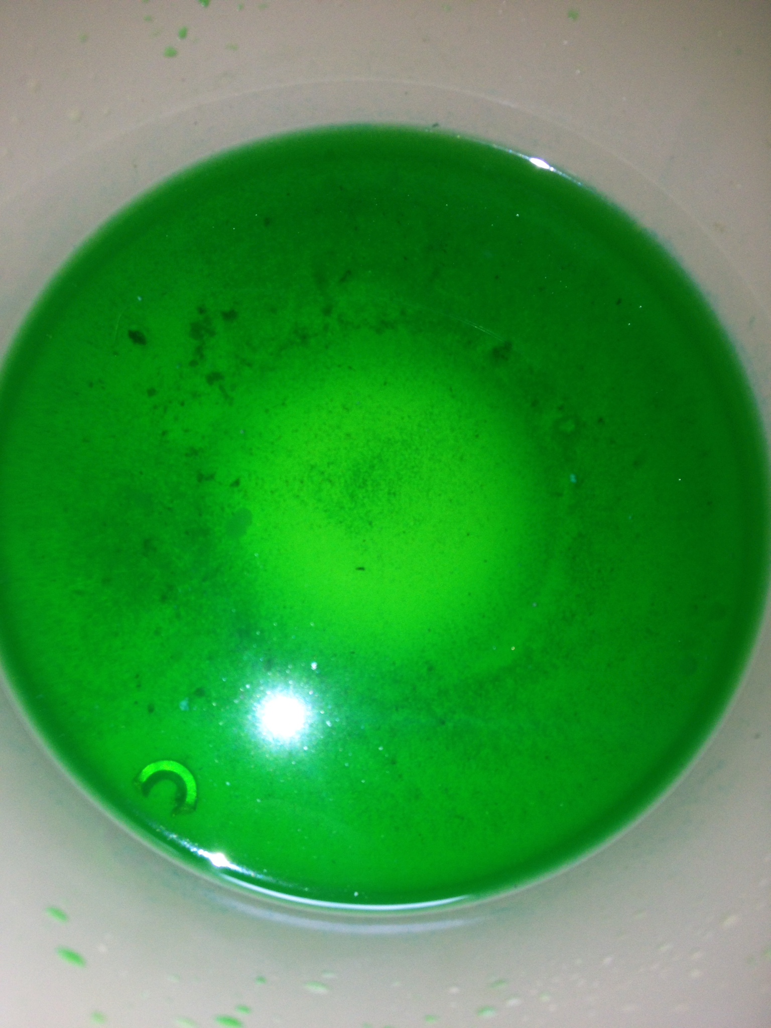

To really keep these machines running you gave two options. Rebuild the LCS (which is possible, but a lot of work and many curse words would be said), or get a set of dual 2.0/2.3 CPUs and their heatsinks then run Thermal Calibration. The LCS I guarantee you will have a bunch of crap in it just like the second one I ripped apart earlier this week.
This was everything (besides the little metal bit) that was living in the stock coolant, so flow was pretty bad causing the thing to overheat.
