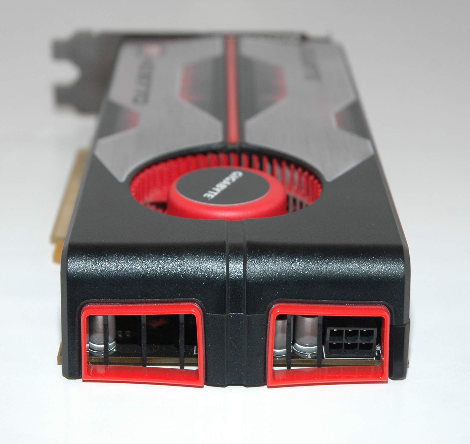

Just curious if Im going to need an external power supply for this setup, in a Mac Pro 1,1. Thanks.
5770 Just have one 6 pin power cable

5770 just has one 6 pin power connector.
Mac pro 1,1 has two 6 pin power supply.
It is sure that you can plug in two 5770 in your mac pro 1,1.
I know, Ive got one. I just want to make sure theres enough power from the power supply itself. Probably going to pick up a Windows-only one though to go with my mac version, no need for 2 in OSX.
You won't need an additional PSU for running a pair of 5770's. You will however need to use Apple's graphics card cable (can get them here), as the end that plugs into the logic board is smaller than the standard end that goes into the card (PSIG standard).

That helps a ton, thanks 🙂 I knew I'd need another cable, but hadn't seen that site. I was figuring I'd have to pay a lot more. And yep Ive already got one Apple card in there with the cable, so I know how that goes. Windows cards that only require the one 6 pin should be the same cable, and not yet another proprietary connection, right? Thanks again!

The connectors on the 5770 are the same (standard 6 pin PSIG), whether you bought it from Apple or another vendor (PC versions will need to be flashed to work under OS X BTW, as they contain BIOS rather than EFI or EBC = needed to boot in a Mac).
But you'll only need to buy this cable if you use a PC version.
