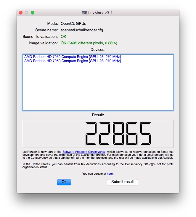

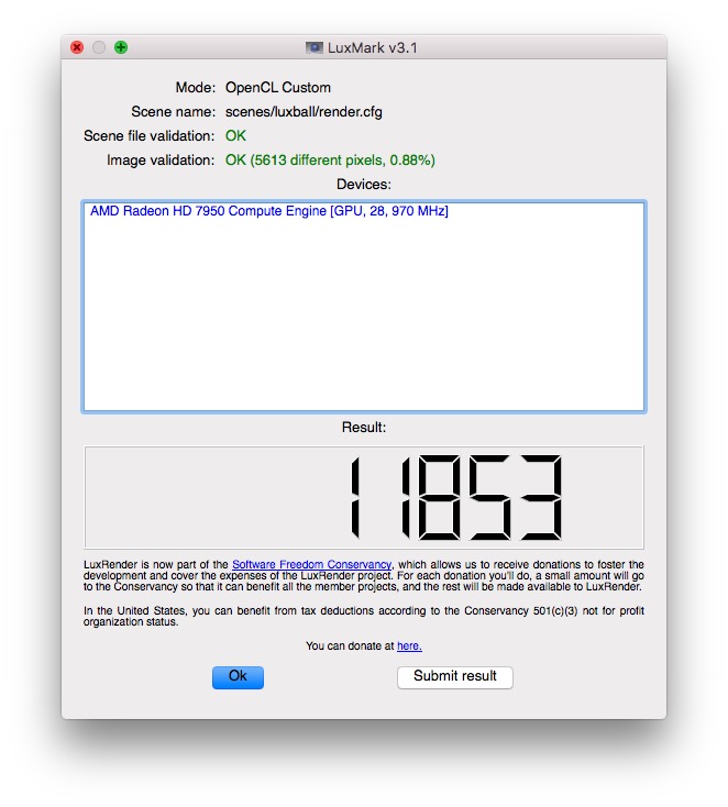

Crossfire is only in Windows.
AFAIK, Crossfire is only for 3D Alternate Frame Rendering in Windows gaming. Not quite related to video editing.
MacOS, and some video editing software clearly can utilise multi GPU for computing / rendering.
e.g. Luxmark clearly shows that it can utilise the 2nd GPU quite well.

What I've heard is that dual RX580 isn't working quite well in macOS. Some users reported that the 2nd GPU basically sits idle and doing nothing all the time. No idea what the problem is, but definitely nothing about "no Crossfire support in macOS".
Since the 7,1 will allow user install multiple Polaris GPU (and Apple will sell Polaris GPU as well), I believe they will fix this issue later. But at this moment, seems better to go for a single powerful GPU (e.g. Radeon VII), especially for those running 10.1.4.5.
