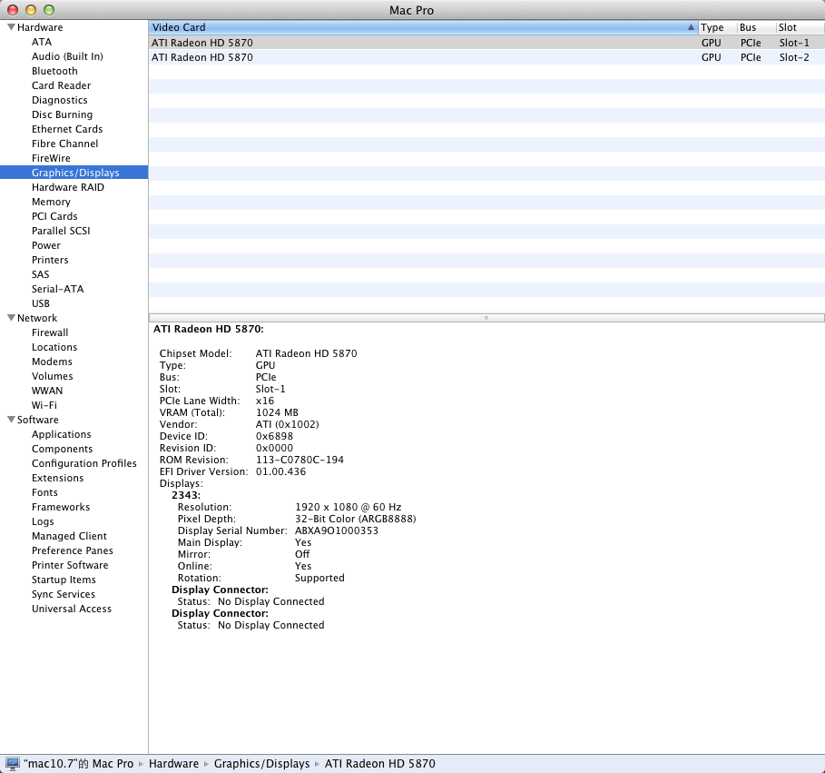

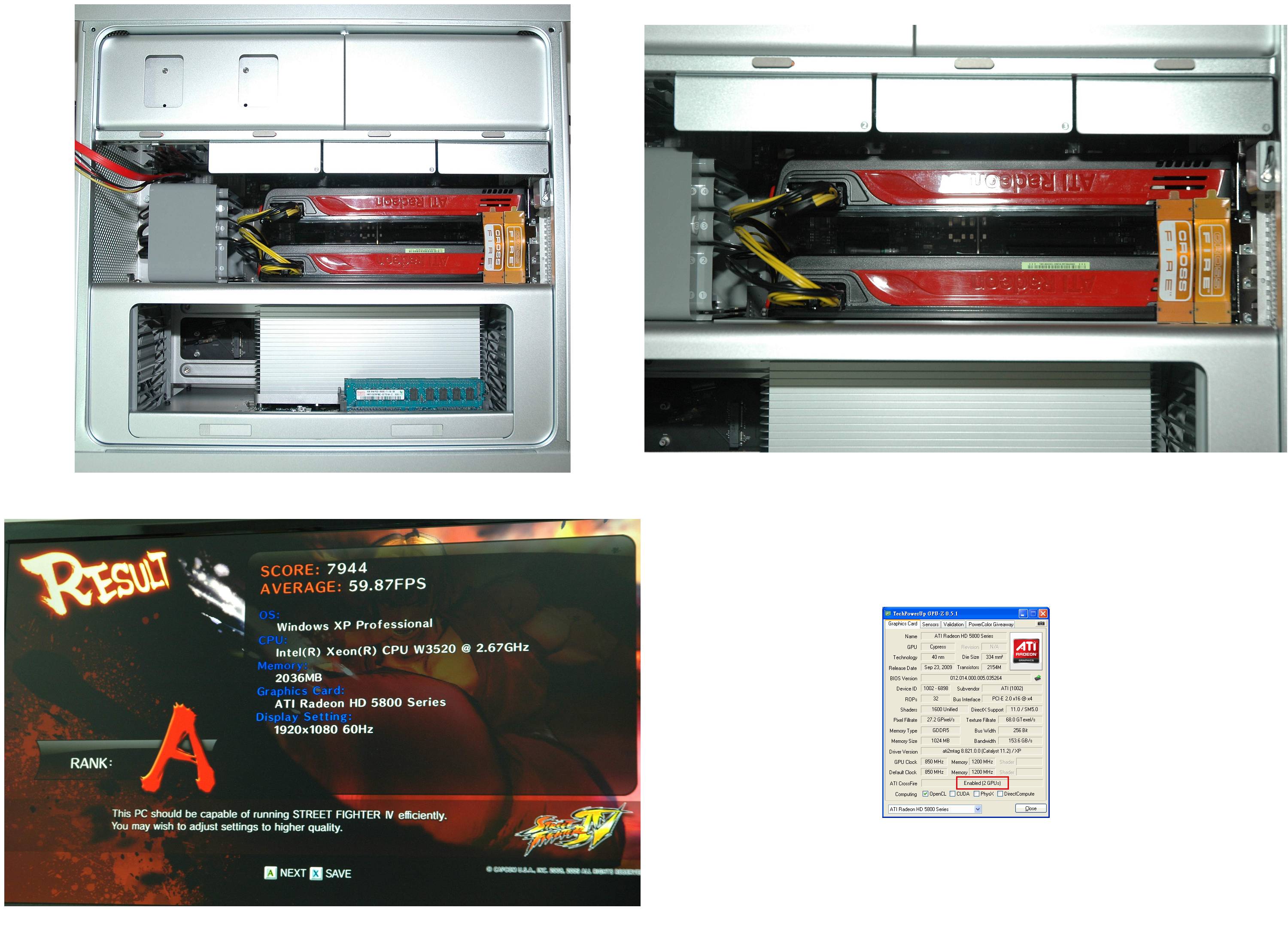

I have tested the dual 5870 cards in my mac pro
All of them are flashed card, not apple oem card.
It did work.
I think one apple 5870 and one flashing pc 5870 will work good.
Yes you can run two (2) 5870 in a Mac Pro at the same time!
Take a lock at this http://www.youtube.com/watch?v=lMiAgsr8m9M
I'm not a fan of using the Y splitters off of the cables on the logic board, as it's possible to draw too much current off of the PSU rails and more importantly, the PCB traces that carry the power to the connectors on the logic board.
There's an example in here somewhere that the HAL (Hot Air Leveling = solder coated copper traces) melted and shorted out = logic board had to be replaced. 😱 🙁
Given a logic board can run ~$800 USD or so, it's not worth it IMO, as a separate PSU is much cheaper (can be done for ~$100 or less).
