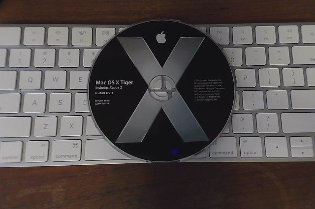

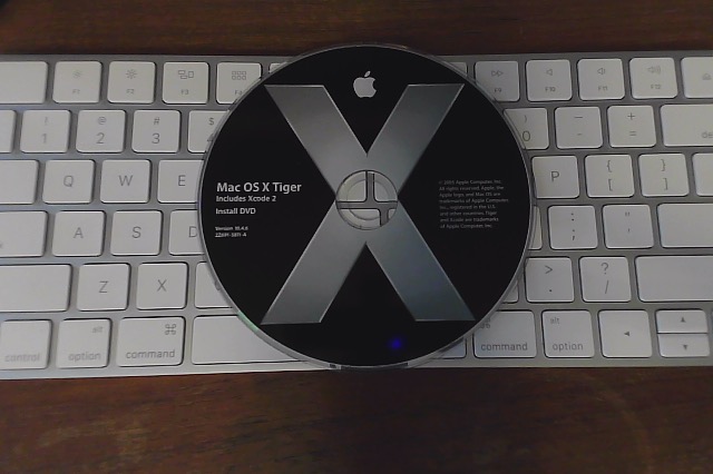

But the problem I forgot to mention is that every time I put in the DVD, it gives me a kernel panic and says I have to reboot.
I presume you've got a Tiger-DVD (black /w big silver X). I'm not quite sure ... but wasn't there version for PPC and another for Intel-only?
wnlewis, Thanks for the color codes, I 100% have 1.1.
Bobesch, Good question, I had used this Tiger DVD to install before. I did install it while running 10.2 and it worked. I think Leopard just doesn't like my DVD. It reads it but won't boot it. The thing is, I was just going to revert back.to Tiger but wasn't able to.
There has never been a retail (black-and-silver) Tiger client DVD for Intel Macs. Using a machine-specific (grey) Tiger client DVD for Intel Macs on a PPC Mac causes a kernel panic.
There was/is, however, a retail Tiger Server v10.4.7 build 8K1079 DVD that works on both PPC and Intel Macs.

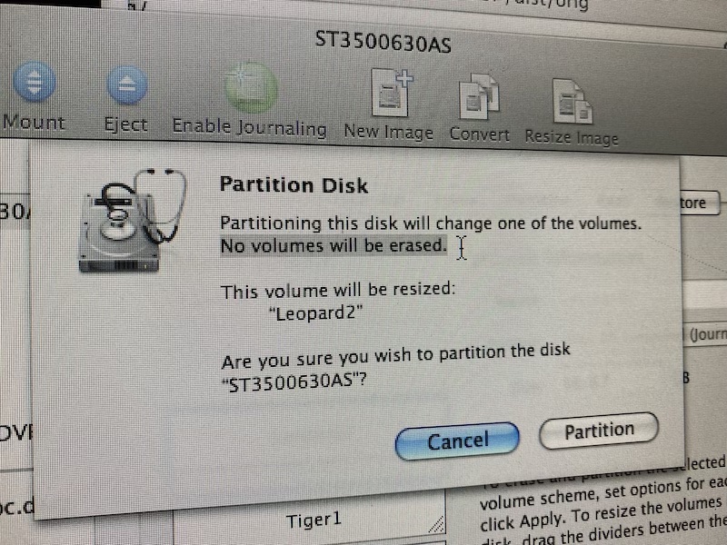

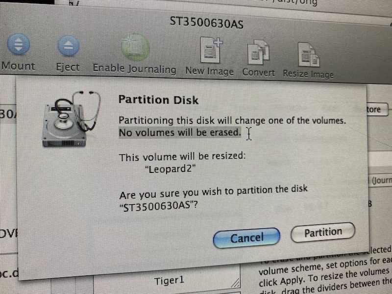

Have you tried booting from the Leopard install DVD and resizing the partitions? If I recall correctly, as long as you didn't install OS 9 drivers on the partition, the Leopard installer Disk Utility can resize them without wiping them. It should have specific wording in the confirmation dialog which says whether it will wipe or preserve the data.
Reactions: Amethyst1
Here's a screenshot

I don't have a Leopard install DVD, but I have an install USB (I didn't have a retail copy or any blank DVDs) that I used that worked great, I'll try that.
I know, I know, it's USB 1.1. But if I installed Leopard from USB 1.1 and was patient enough to sit in front of a loading bar for 6 hours, I think Disk Utility would be fine. I was also too lazy to get Safari 3.1 (or whatever version it is) to work and I used TenFourFox off of a USB hard drive. I still do! It's actually just as fast as Chrome on this iMac!
Then do you know why it does kernel panic and doesn't boot when I try to boot from it? I thought it was because Tiger is older than the OS I have on is right now, I may be wrong.
Do I have to hold the C key? I had been holding Option to view the boot menu.
Holding [C] tells the Mac to boot from the DVD straight away, but holding [Option] to bring up the boot picker should™ show the DVD too.
Can you see the actual error message when it panics and take a picture of it?
I will next time I try to boot from it. I'm busy right now, but I should be able to send a photo by 11:00 tomorrow.
If it doesn't show any message, boot in verbose mode: Hold [C] or use the boot picker to boot from DVD and immediately hold [Command]-[V] until you see lots of text scrolling down the screen.
