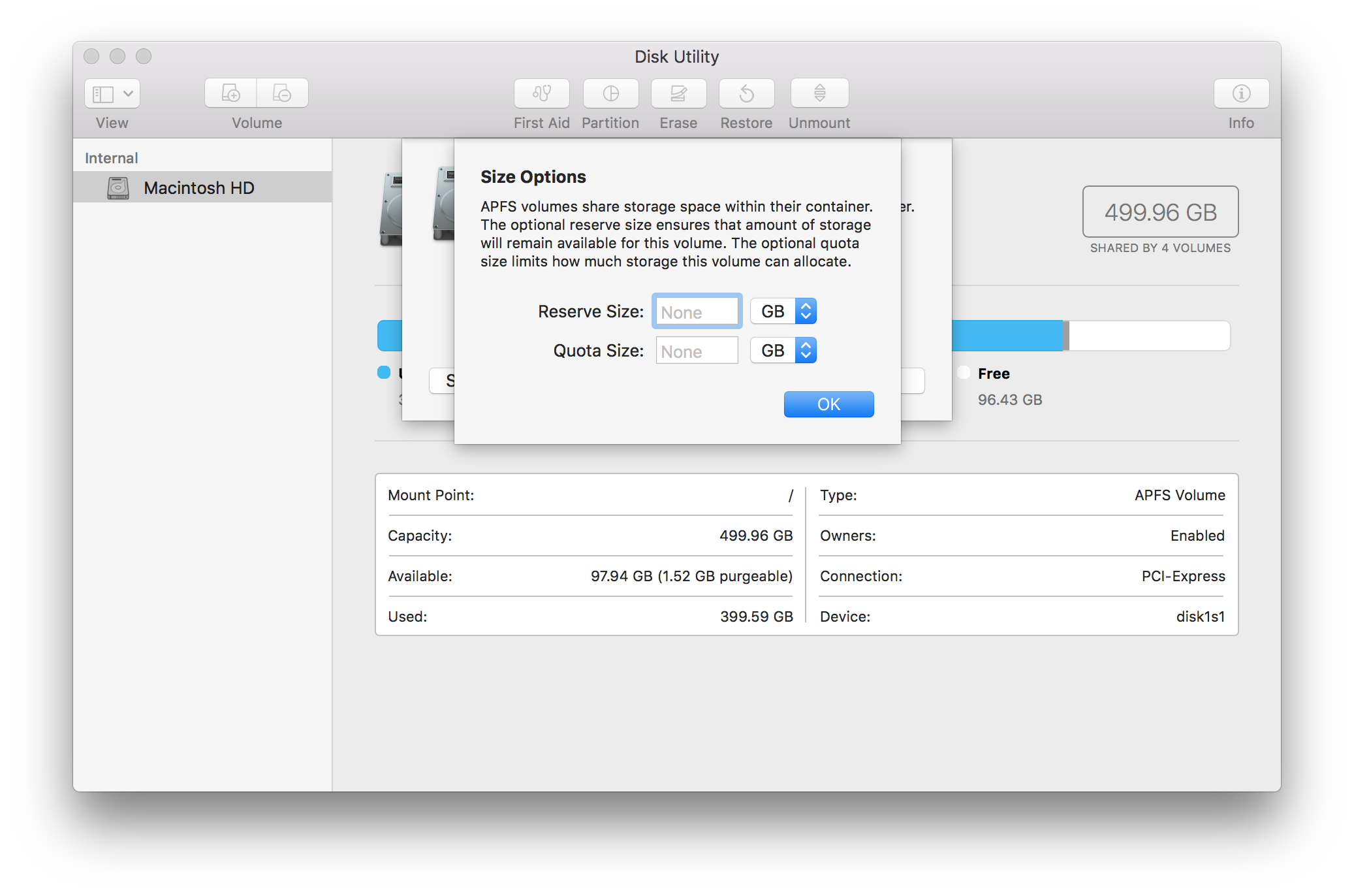

I blogged about the volume option that campyguy mentioned and would recommend it too. Check this out: https://thebitguru.com/blog/1499-ho...ave-without-messing-with-your-primary-install

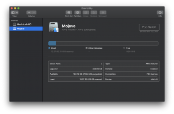

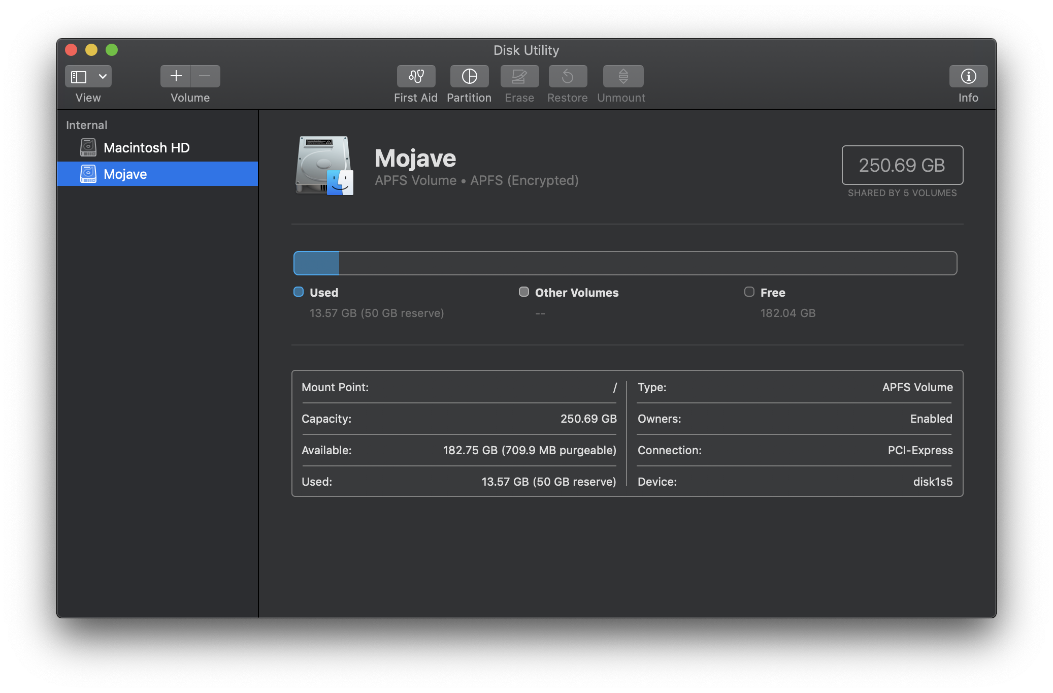

Thanks for these tips. I have now been able to install the Public beta on the separate "Volume" and it is running fine. I did specify the Reserve Size in the Size Options window in Disk Utility as 60 or so GB (I can't remember), however, Disk Utility is showing the Mojave "volume" as having 182 or so GB free. Shouldn't it say < 60 GB free?
What is going on?
It "reserved" 60GB (minimum size), but the volume can grow more than that unless you also specified the "Quota Size" (maximum size) when creating the volume.

Long day, just a few minutes here today. Agreed with the above answer. Container Volumes dynamically adjust in size. My "Mojave" Volume was showing as "1GB" in size before the install, now around 83GB in size with the OS and a few apps (Logic Pro X, GarageBand 6 and 10, Pages - I can't live without GB 6's Magic GarageBand!) installed.
Add stuff, the Volume increases in size. Delete stuff, the Volume decreases in size. No need to futz with partition maps now. FWIW, I was hung up on partitions from my own experience, took the leap after reading up on the principle. There's beauty in Container Volumes, I'm finding... I'm so over partitioning on the macOS platform now.
