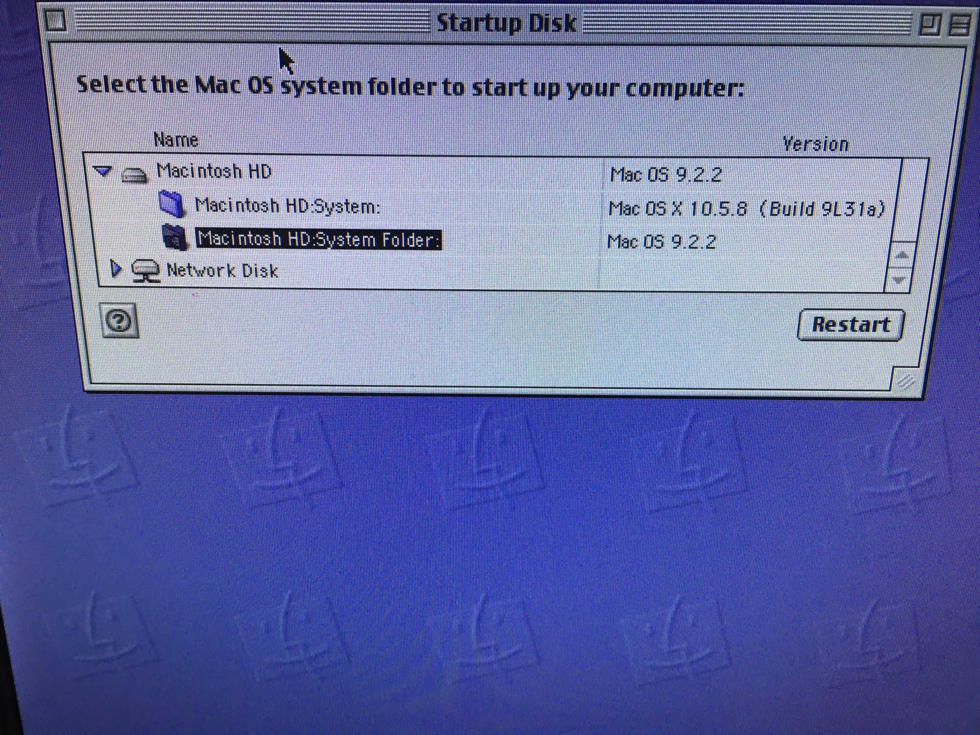

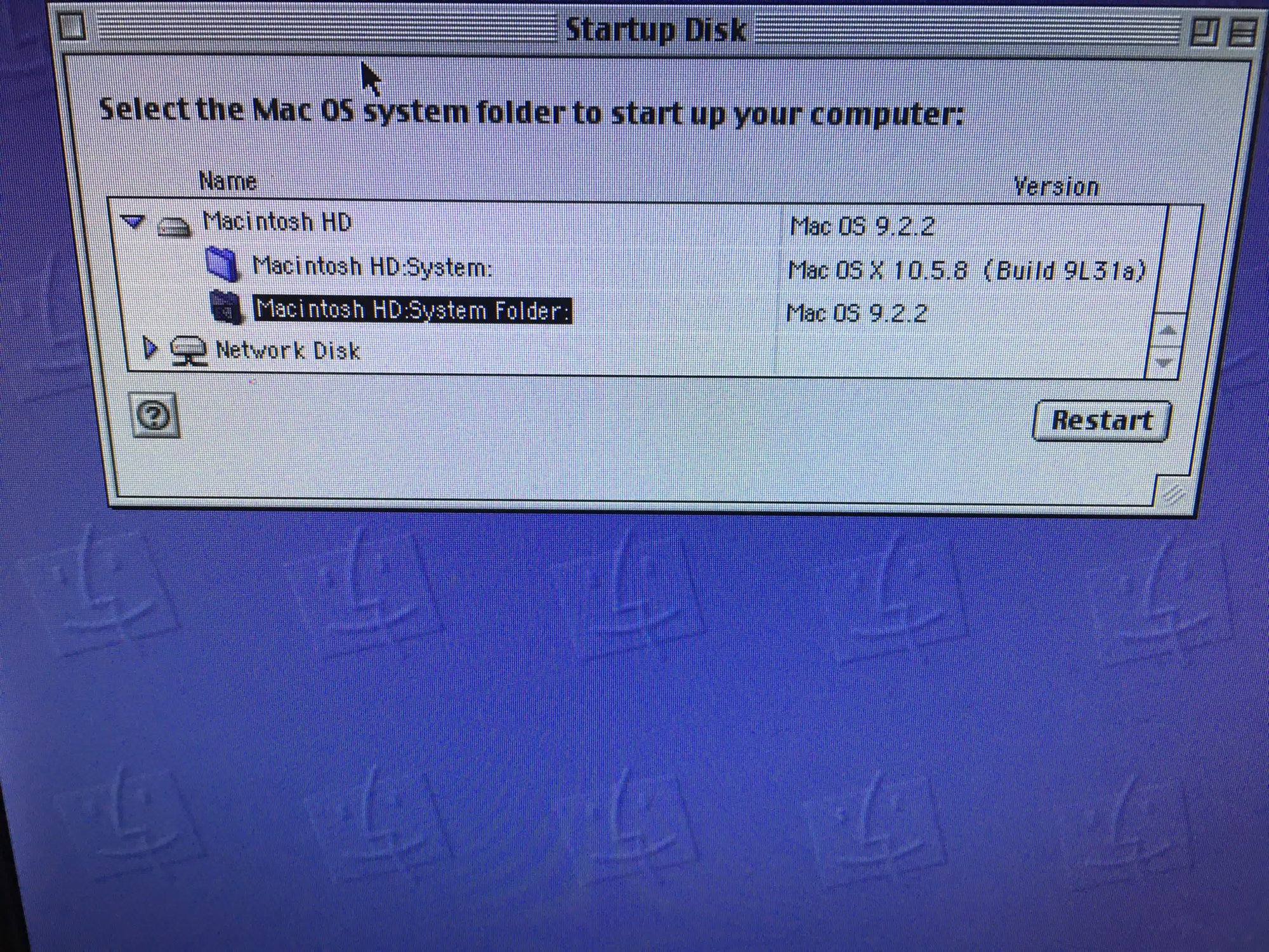

I installed Leopard followed by OS 9. 9 detected both itself and OS X in the Startup Disk preference pane. I selected Leopard as my startup disk, but Leopard's equivalent to Startup Disk was unable to detect OS 9. I once more tried manually booting the ROM, but I was stuck at the Happy Mac like before. I wonder if it would be possible to force Leopard to see OS 9 in Startup Disk.
Reactions: alex_free
I installed Leopard followed by OS 9. 9 detected both itself and OS X in the Startup Disk preference pane. I selected Leopard as my startup disk, but Leopard's equivalent to Startup Disk was unable to detect OS 9. I once more tried manually booting the ROM, but I was stuck at the Happy Mac like before. I wonder if it would be possible to force Leopard to see OS 9 in Startup Disk.View attachment 1707033
Cool, it works.
What I do is boot into open firmware at startup, and then execute the 'multi-boot' command to pull up the OS switcher which sees Mac OS 9 as in the tutorial.
I think there is some program that fakes the mac model which allows you to use Leopard's startup disk functionality for OS 9.
Cool, it works.
No dice. It only sees Leopard. Do you happen by chance to know what the name of the program is?
