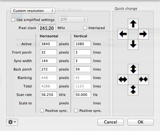

Yes sure here is my SwitchResX config, for the MMH11 with 2 x Samsung BX2440 monitors:

Sorry for the old thread revival.. but THIS fixed my problem!
Apparently my mid 2012 MBP with a HD4000 can't display 3840x1080 at 60HZ? yet my Lenovo T430 with an HD4000 can..
Is this the silliest thing ever? Unless Windows 8 is auto bumping down the frequency and I'm not aware of it, this is just silly.
I am not sure if this is an OSX issue or a Matrox issue.. but if it's Matrox they REALLY needs to fix this.. I can't believe it took me 2 days of screwing around with all sorts of stuff to get 3840x1080 res on 2 23" Dell P2311h's. like 50 google searches later I stumble upon this thread. I manually create the res at 50hz and viola.. works.
