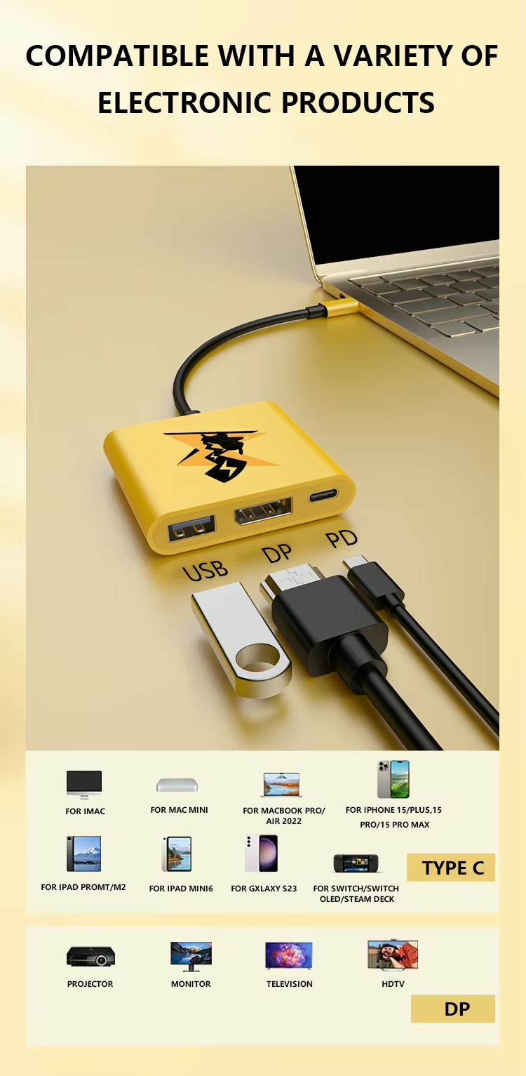

It's been a while but seemingly I found a way to enforce DSC, via a "usb-c hub with Displayport1.4, USB2.0, PD 100W ports" which is super cheap on ali yet just works amazingly. As @joevt mentioned earlier, due to the additional usb2.0 port on the hub, the display part is probably forced to run HBR2 and taking less bandwidth.
I don't think I said that.
A USB-C hub that doesn't have USB 3.x allows 4 lanes of DisplayPort - just like if there was no USB-C hub.
A USB-C hub that does have USB 3.x allows only 2 lanes of DisplayPort.
Neither option should limit the DisplayPort link rate except I suppose some USB-C to DisplayPort adapters are limited to HBR2 because of their quality.
A DisplayPort 1.4 adapter implies HBR3 link rate capability.

I should say what you said inspired me to get an adapter with additional USB ports.
Looking at https://newnex.com/technology-articles-dp-alt-mode-over-usb-c.php helps me understand better.
So USB2.0 is almost "free" and that USB2.0 port theoretically wouldn't make a difference than a vanilla type-c to DP1.4 adapter (using 4 lanes). And adapter with a USB3.0 port is more likely to force DSC.
This is the adapter I got: surprisingly it works for nintendo switch too (yep output via DP instead of HDMI). Perhaps it has a peculiar design to accommodate that.
Yes.
I'm not sure what you think is peculiar. The USB-C port of the Nintendo switch supports USB-C DisplayPort Alt Mode. That means you can connect a USB-C dock or hub that has a DP or HDMI port and connect a TV or display to that. Or you can connect any USB-C to HDMI or DisplayPort adapter or cable.
Actually, maybe that's not true and there might be something peculiar.
