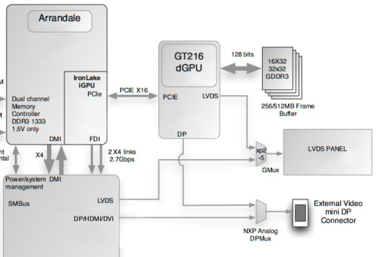

It sounds really weird. Unfortunately, the schematics of Retina Pros can't be found anywhere (yet), but in all previous iterations, the 2 GPU-s were fully parallel and independent, converging only at the very output, at LVDS and mDP level, via Mux-es (see attachment). So I wonder how can the dGPU render anything on screen, if iGPU is active? Besides, they both shall have different VRAM-s, hence different framebuffers. Despite that, you can always task the disconnected from display dGPU with computation tasks via CUDA/OpenCL, just like Sorenson Squeeze does. If anyone knows better, I'd be delighted to hear an explanation.
There is nothing puzzling about this at all. The system renders to a texture on the dGPU, copies it to the system memory and then uses this texture as the backing layer for the view. The performance penalty of the copy is minimal in most cases. The 8x PCIe 3.0 lanes offer enough bandwidth to download a full HiDPI 3840x2400 colorbuffer from the dGPU at over 200 frames per second. In fact, this is how Nvidia Optimus and also bridgeless SLI/Crossfire work. OpenCL/CUDA use exactly the same approach.
Its reversed: the texture rendered on the iGPU is being copied to the dGPU. I just tried it, works too.
I see. I reckon this copying occurs only because you've specifically requested an OpenGL context on inactive GPU? Meaning, without calling for this, the rendering can fully occur only on the active GPU?
Yes, this is the default behaviour. Even more, usually OS X will switch to the dGPU as soon as application starts to use OpenGL. The application can also inform the OS that it knows how to work with multiple GPUs and would actually prefer the iGPU - in which case the currently active GPU (whichever that is) is used. The GPU can change on the fly in the later case - your application is informed of this change and is expected to adjust its behaviour accordingly (e.g. disable/enable Nvidia-specific functionality). Most applications can keep this fairly trivial, and because adding support for GPU switching (and thus potentially saving energy) usually takes just two lines of code, there is no excuse not to do so.
