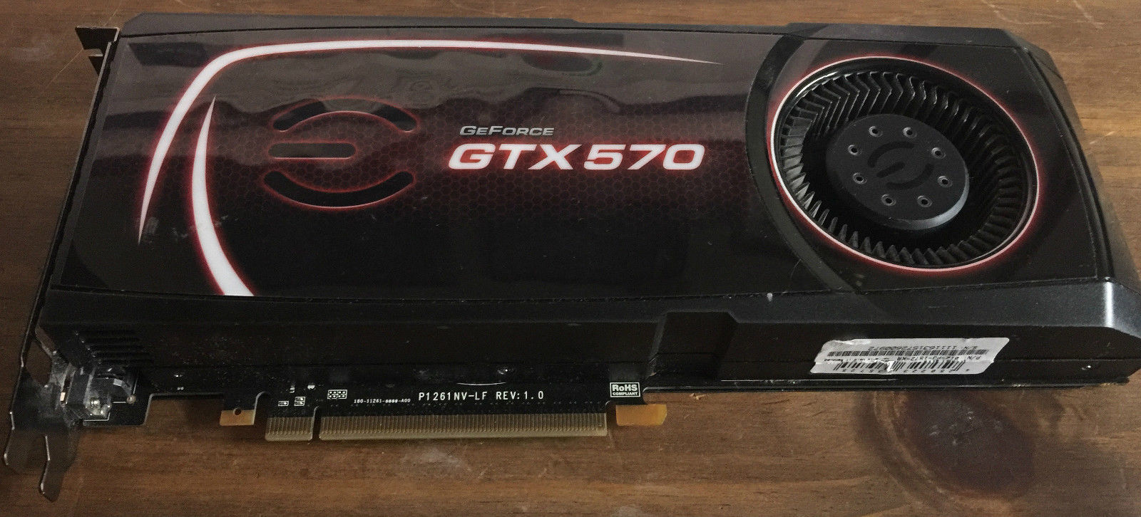

Turns out the card was not fully functional and causes the mac to randomly crash and reboot, so I've got another gtx 570 on the way.
Thanks guys. The 570GTX that I ordered as 'untested' is fully functional, and I will swap the 5770 for a GT120 that is on the way.
Turns out my 3,1 Power Mac is one of those that has stability issues with the GTX570 when installed in PCIe slot 1. This is something that I would not have discovered were it not for this forum. Very strange and unfortunate issue, but the card is now installed in Slot 2 and working well. This means I've lost one of the PCIe slots, which means bye bye eSATA card that I would likely never have used anyway. There is also a GT120 for when boot screen is needed. Both cards are working well!
There are 2 models of 570.
The ones with the fan at back end will frequently not allow the GPU fan to engage, in slot 1, causing the overheating you noted.
The GTX570 with fan in center fix this issue. They also have a DP port, which gives greater flexibility in display output. It may be worth your time to find the other type of 570 to regain your lower slot. Having the 570 flashed would allow you to sell the GT120 to cover the cost.

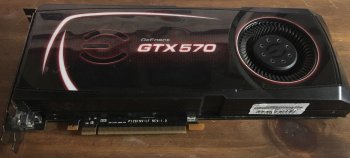

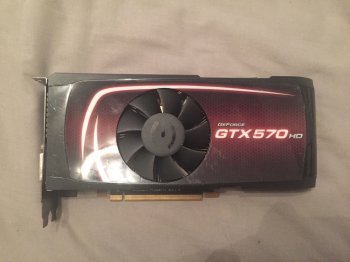

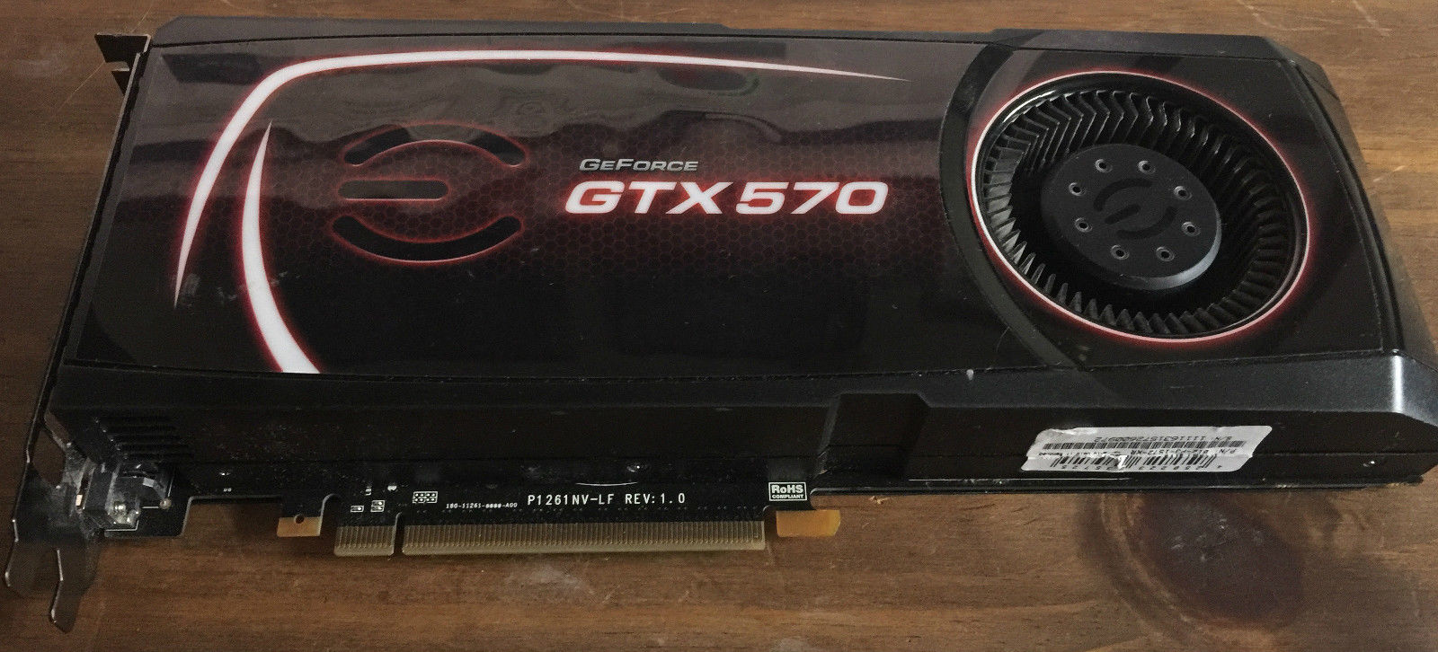

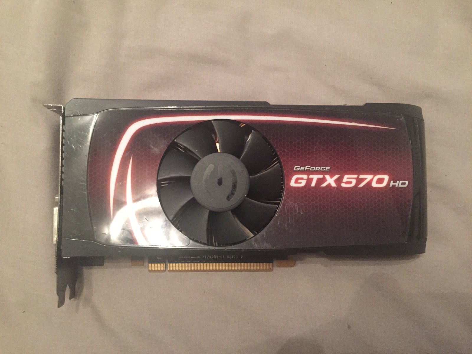

See below - picture number 1 was the first 570 (a 570 HD, with a DisplayPort), while picture number 2 has the fan at the back and is now the one installed. Both have the fans in different locations, but have the same issue of random crashes and reboot.

Do this, leave side panel off.
The 570 with fan at end will spin fan at boot, but it will stop at desktop, in slot 1 of a 3,1. The one with fan in center will not do this.
