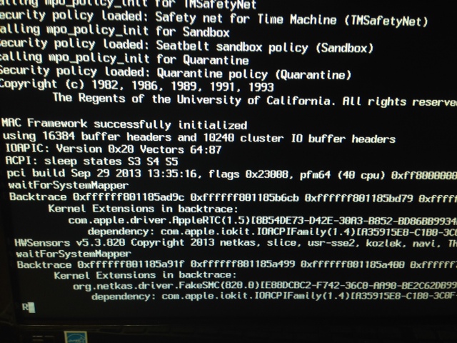

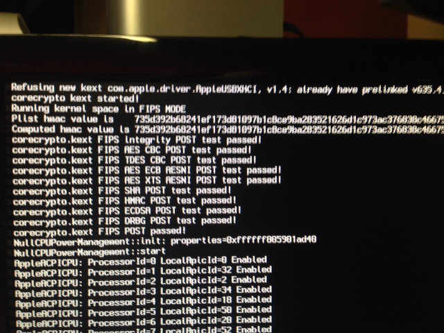

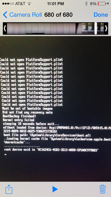

I attached some text boot screens.
I think I must have messed this thing up when I was trying to get my usb3 cards to work. - That is the only time I added these Kext files.
Geo
Can I attache files? 😡
I am a newb... - wow...
First Screen That Shows Up
WHere the load Stops
This is the top of the page where it stops.
I Guess I may need to delete some kext files, but I am not sure. - Is the Netkas thing what is corrupting my load? I pulled the card out, and it boots right up.

Why all the hackintosh files is this a real Mac Pro? If not I suggest insanelymac.com for help they deal with them every day. If it is real mac pro I suggest fresh install for wiping all that junk you installed to be certain there are no left over files.
