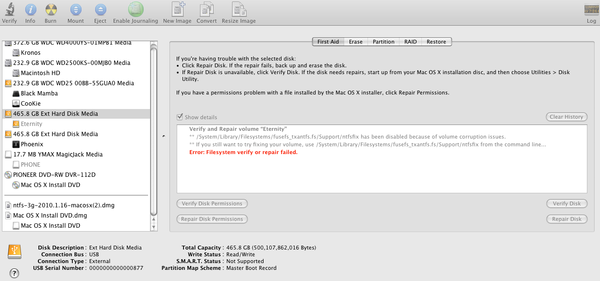

Hello, I own the NexStar MX Dual 3.5'' SATA/eSATA External Hard Drive Enclosure( http://www.vantecusa.com/front/product/view_detail/277) and I previously had it connected to my Power PC G4 Mac computer. In the enclosure, I have 2x500GB HDDs. One HDD is formatted Mac OS Extended (Journaled) and the other NTFS. In any event, I recently purchased an Intel Quad Core mac and now my computer only recognizes the Mac OS formatted drive and not the NTFS volume. I can see it on disk utility but I get an error (please see attachment). Could you assist me with this issue, please?

you recieved that error bceause you attempted to repair/verify the disk - which is impossible with NTFS formatted disks on a mac.

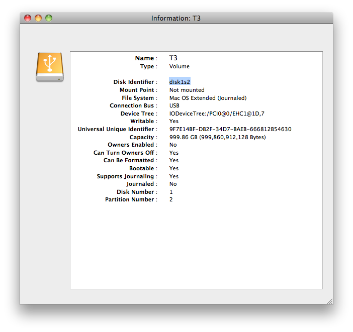

So in terminal I copied and pasted the command line but I need to add in the device location e.g. dev/<something> ... but I have no idea where to find what the device name is.. any ideas on how I can find out?

click on "eternity" (the drive name) in disk utility, then Get Info on it.

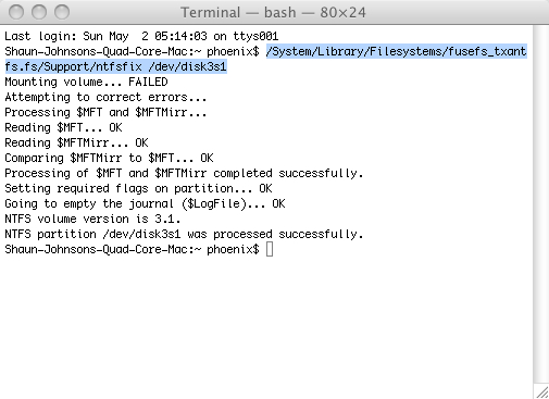

Ok I have never felt like such an idiot before. Thanks for the information. I did as suggested and input the information in terminal. The Attachment shows the results... however, the disk still hasn't mounted. I just don't understand...

intersting. it appears to have fixed it, but still not working...
im wondering if its an issue with the NTFS-3G installation on your computer?
could you try to uninstall it and see if it gets read permissions?

WOO HOO!! Success (finally!)
Running the command line in terminal THEN re-installing the NTFS-3G (then rebooting of course). Thank you again for all the help. 😀
