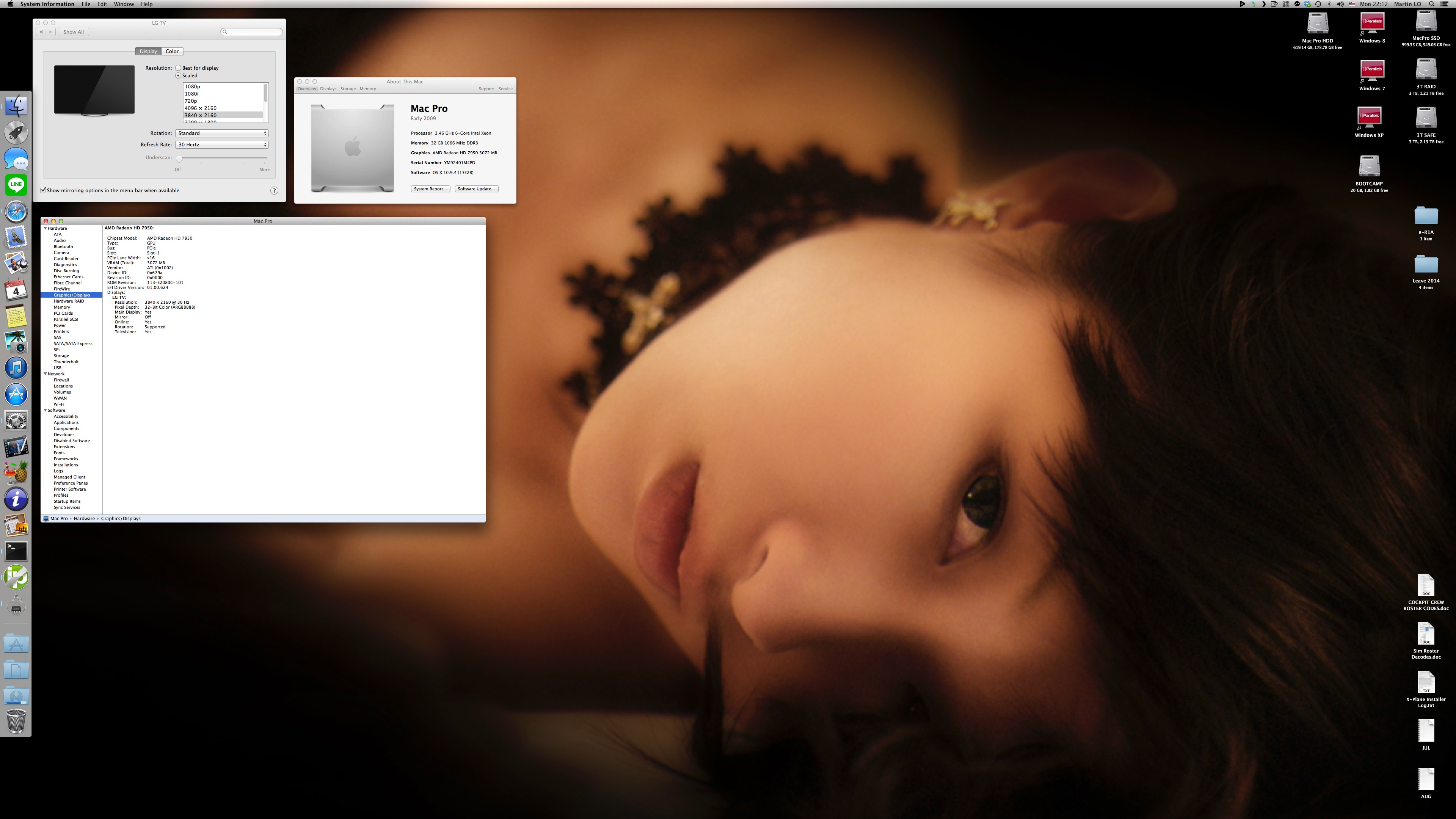

do you use your 7950 to drive your 84" 4K TV? that's one immense TV!

Yes I did, However, the TV only has HDMI 1.4, therefore, it's limited to 4K 30Hz, but it's good enough for me already.
