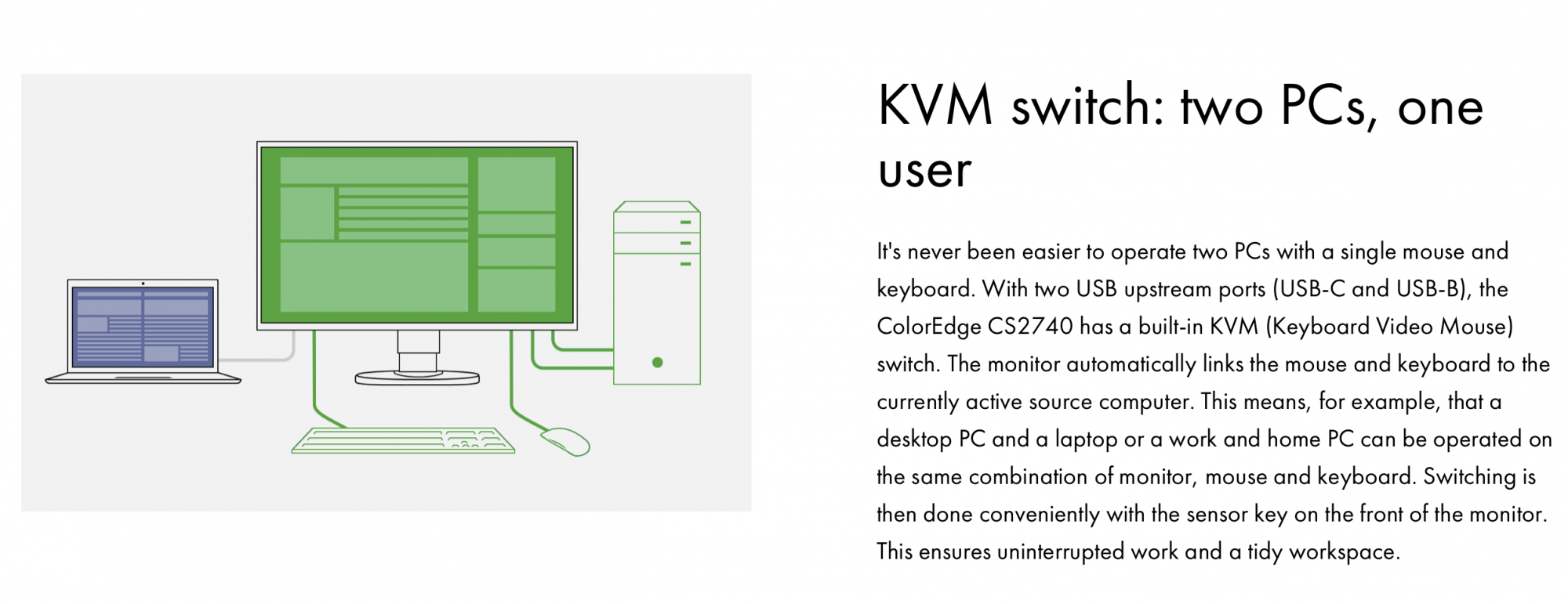

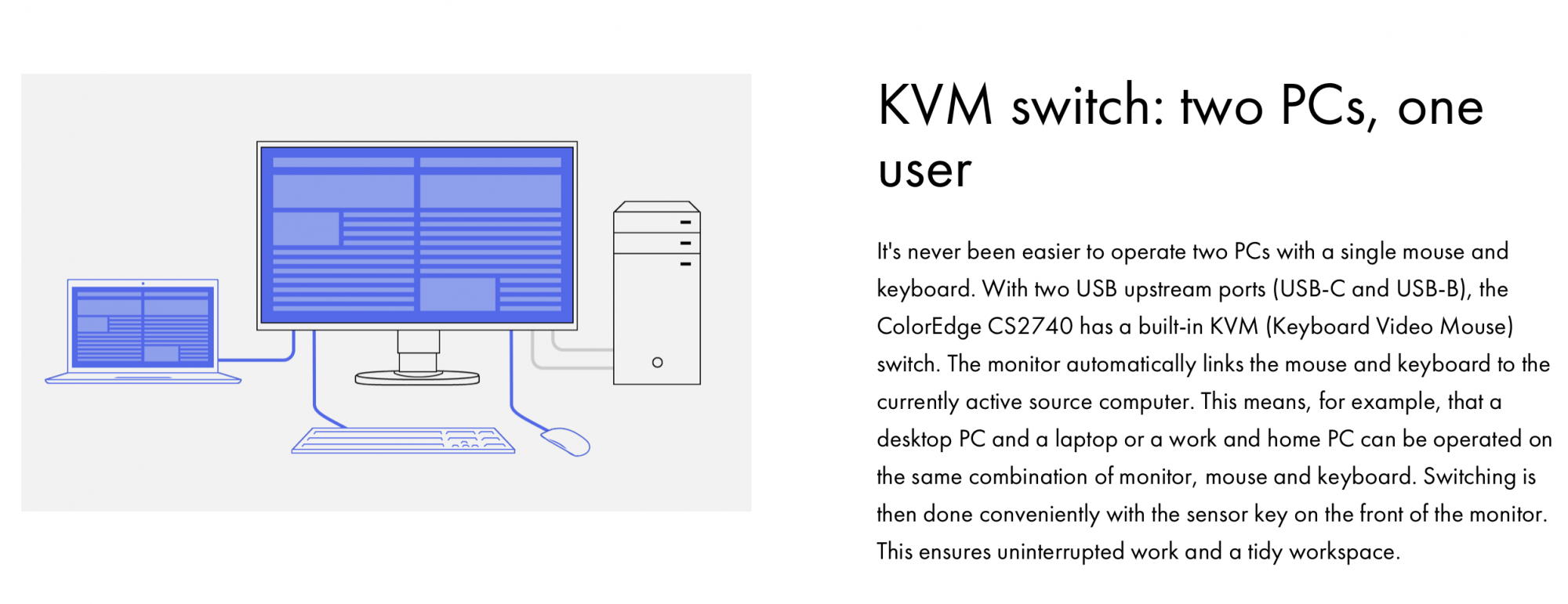

My Eizo CS2740 also has a built-in KVM switch. See the two screen captures below:
