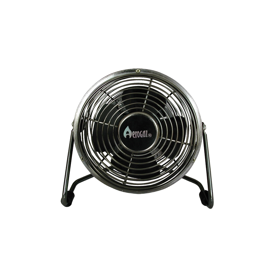

If you are that concerned buy a fan similar to the below one and point it towards the iMac's back.
