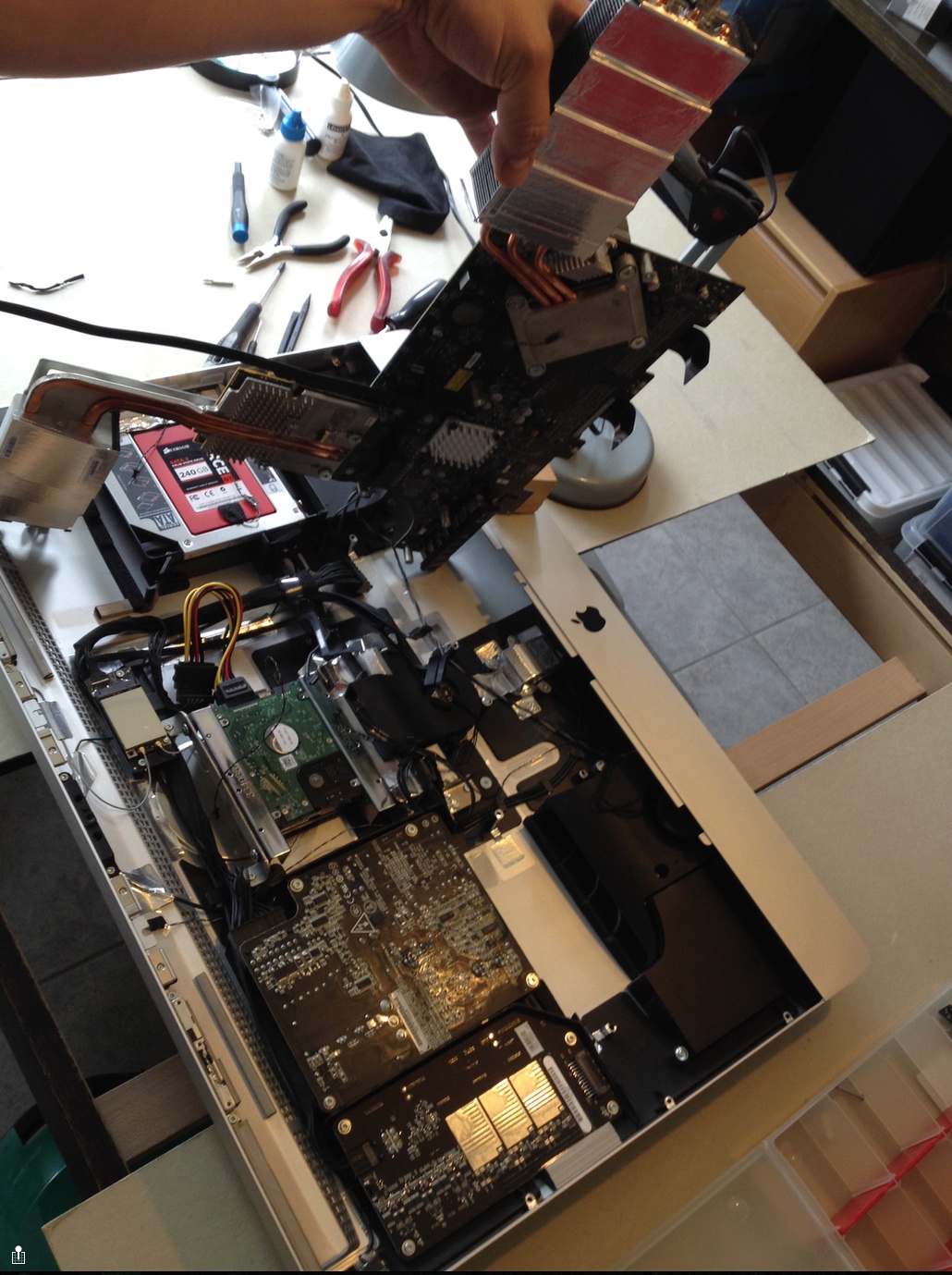

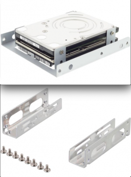

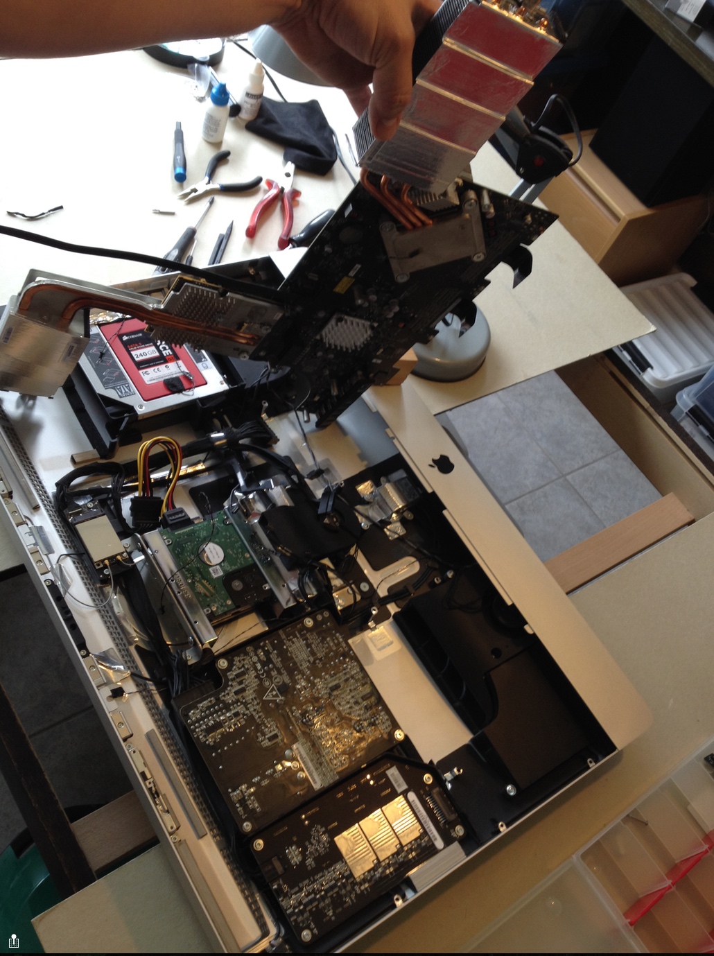

Some years ago I wanted to install three 2,5 inchers inside my 2010 model. I used some cheap Kingston or DeLock metal brackets to put 2x 2,5" in place of that original 3,5", and an ODD adapter for the third one. The one you linked indeed seems a little bit too high to fit the 3,5" spot inside 27" iMac, but I'm not quite sure. If you are installing two SSD's, I would say you can go with some good double sided tape too. You don't necessarily need the brackets. I have tried the tape also, SSD's are really light compared to HD's, and will hold their place nicely in there.
You will need to tear down the iMac pretty thoroughly though, because that one SATA-port is on the other side of the motherboard (see pic). I updated the processor too from i5 to i7 while I was in there. It was not that hard I first thought it would be, but it took quite some time, just to be careful. Didn't want to break anything.
Good Luck!

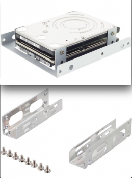

Getting back on topic... Do you have any links or anything in mind that is better than what i've posted so far with bracket options? My plan is to use the 1TB hard drive as a backup drive and use an SSD (for OS & boot camp windows) and an additional 2.5 normal hard drive sandwiched together with the adapter mentioned. I've seen the video for stripping down the imac so it doesn't look to bad :/

Any noname brackets and some working cables with appropriate length will do.

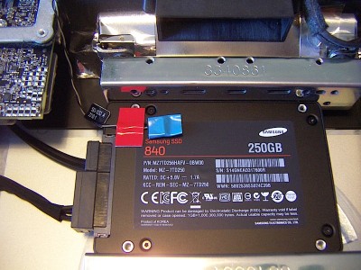

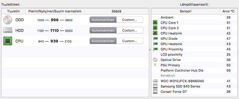

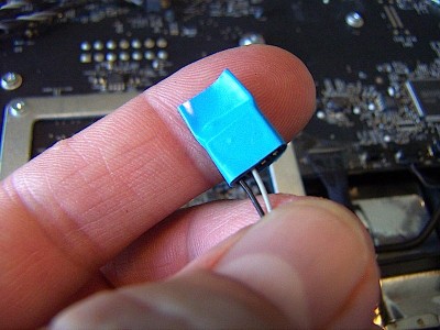

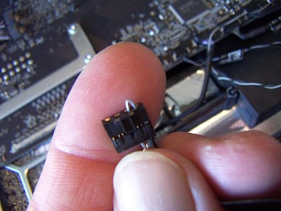

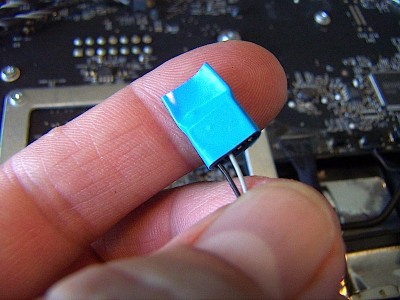

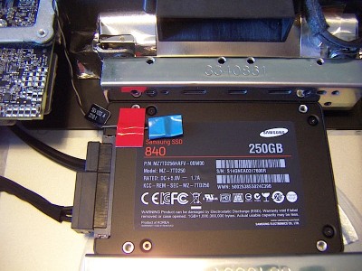

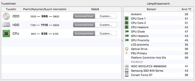

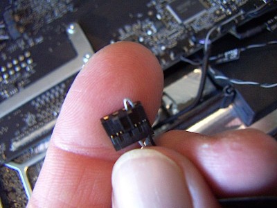

I used a SATA power splitter, and a SATA cable around 50 cm if I remember the lenght right. I shorted the temperature sensor with a stapler nail and taped it safely to secure to not to make any contact inside iMac. I monitored the temps with crystal ideas Macs Fan Control.
Temps there just fine without the temp sensor, a normal 2,5" SSD is not going add tempretaure compared to the old 3,5", it's the opposite. And an WD Red for CCC-backups did not affect the temps either, not too much. It's cooler inside the iMac ofter the change.

You don't really need a special bracket but it is easier.
You will need a temp sensor. A used optical drive sensor works fine in a 2010 (but not a 2011). And no, you cannot just use the sensor already present. You have to get another. The $30 OWC sensor works just as well.
You don't have to use that crapware with a used optical sensor. It's not that you can manipulate the fan speeds; it's that you have to. At least shorting out the original sensor keeps the fan from going full blast when you boot.
I agree it's not perfect software, but it's free. I did not have to adjust the fan speeds, the software was were just to make sure nothing would burn inside. There are a lot of other software out there to monitor your computer temps. That's just what I happened to use.
Btw. I have used optical sensor too, it was something like 30€ from Apple service center. One might get one cheaper from aBay/Amazon or from other market places. It's the best solution for this in my opinion too (for 2010 iMac).
