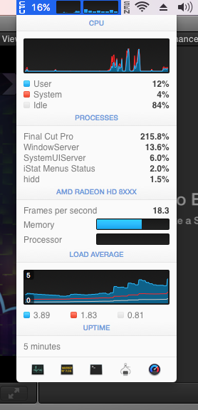

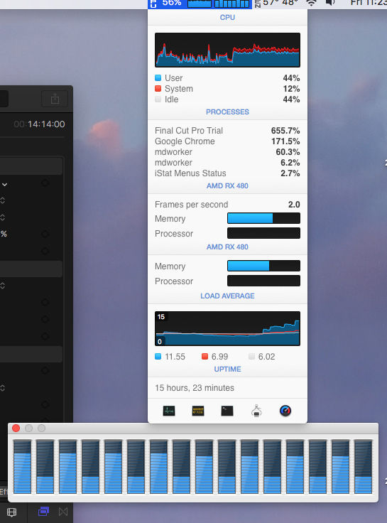

Yeah I've been using the 480's and they 'work' but not sure how much they really work. Using fcpx 10.3 / 10.2.3 and rendering footage with gaussian blurs and color corrections and other effects, im only getting a few fps, but as it seems to me, the gpu processors themselves are not even budging and only the memory gets used up. Is that the norm?
Ps. The CPU Usage is because of the proxy media transcoding, but it looks to me also that im only really getting 75%/25% between physical cores and logical core usage. Again, i dont have a baseline to compare it to so im hoping others with fully working systems and on Mac Certified gpus will be so kind as to chime in with their experiences on utilization.

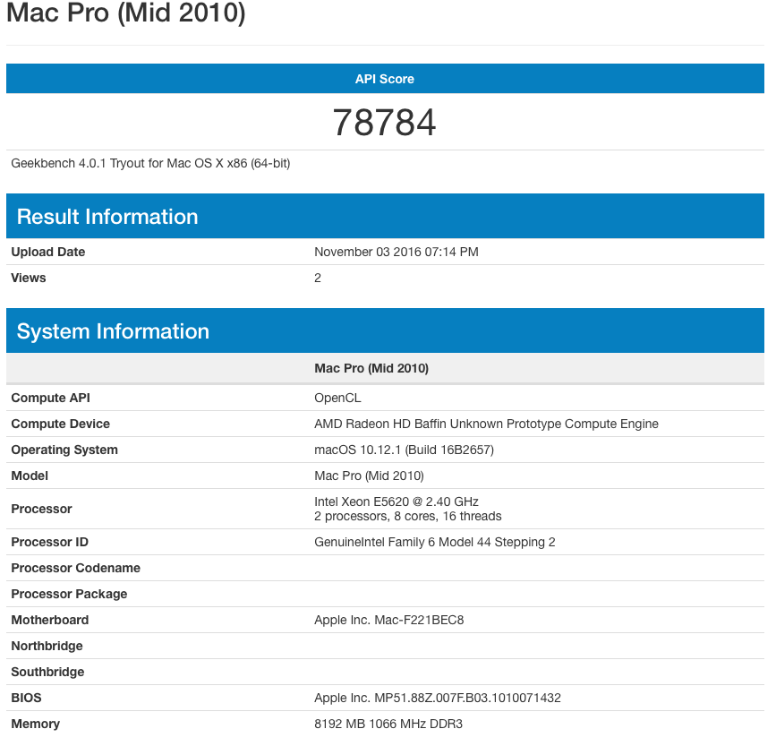

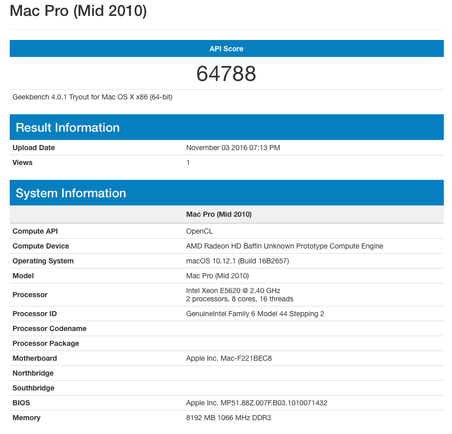

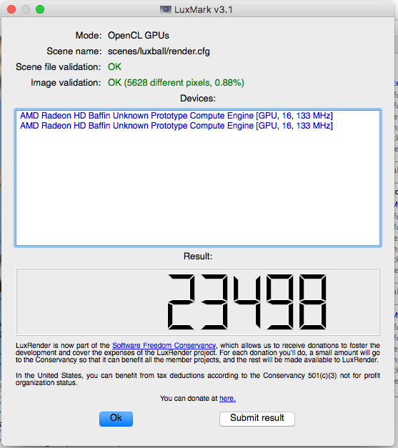

To be honest, i tested the 480s and im getting confusing results. I tried single and dual setups, and im scrathing my head, hopefully i just have some settings to tweak on my machine.
cMP 5,1
Dual 2.4GHz
64GB RAM
SSD system drive
Results:
Dual RX 480 = 19 seconds
Single RX 480 = 22 seconds
im using visiontek reference 480s clocked at 1333MHz
Above are the geekbench gpu scores for each cards at slots 1 and 2 respectively.
Just want to make sure your "few FPS" is not the 2.0 FPS shows in iStat menu, that FPS has nothing to do with your rendering FPS.
Also, iStat menu in Sierra is not work very well yet. I only get the GPU loading with the latest build (version 5.30 build 704), anything before that unable to show GPU usage in Sierra (true for my 7950). However, that doesn't mean that your GPU is not working.
Yup, i noticed that sometimes it actually goes up to 10 or 20 or something silly, and that screenshot was only for that specific time i guess.. :/ I dont have a lot of experience with iStats but it was the only tool i had to instantaneously check the current status of the GPU, but it probably wasn't that good like you said.

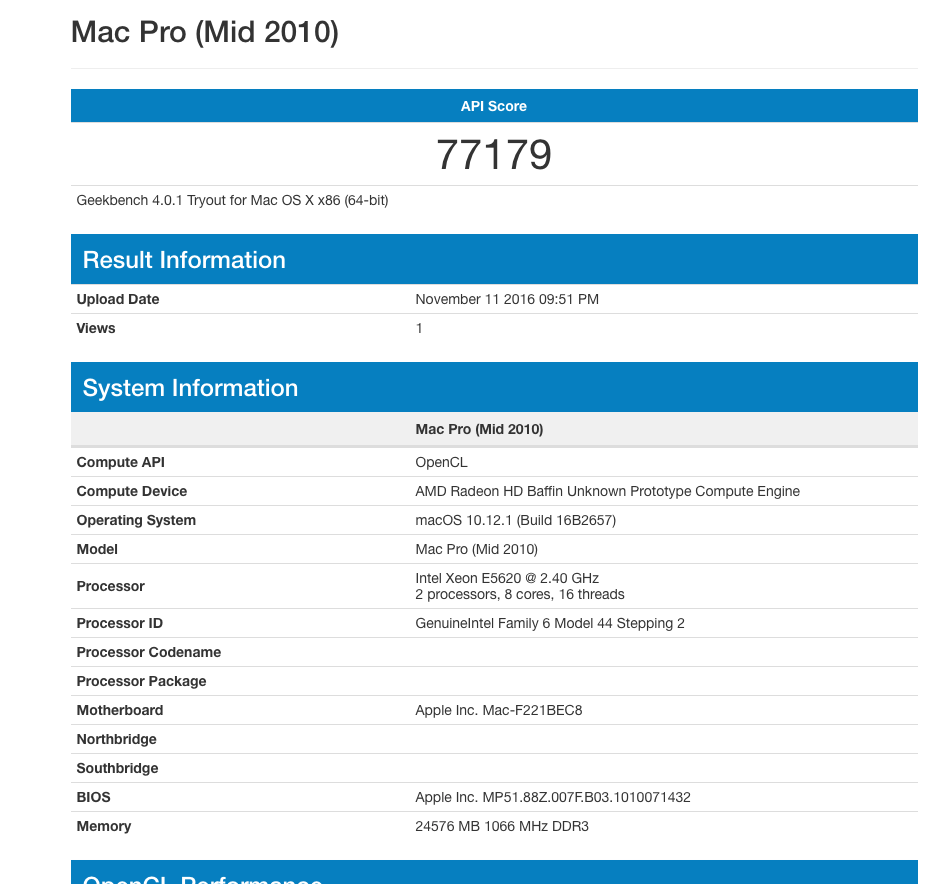

I tried! Lol well i have a little update:
So, I got a hold of two cards, Gigabyte r9 390x 8GB for $247 and and a Diamond R9 Nano 4GB for $220 at Microcenter.
The Nano has a single 8 pin while the 390x uses a 8+6 pin combo.

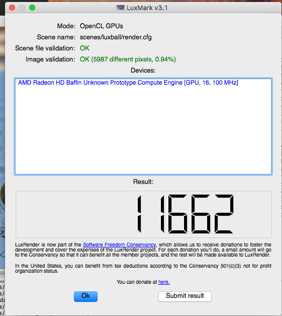

R9 NANO
First I tried powering the nano directly with a 6pin to 8pin cable, but it’s a no go because the power cuts and the system shuts of. Unplugging the cMP IEC (power cable) for a few seconds and plugging it back it allowed to do a system reset so I can try again. If I didn’t do this, the computer would not power up no matter the amount of button presses I do. Now for the next test, I switched to a dual 6pin to 8 pin and it works fine, computer booted up and went to the login screen, however, this is when I noticed the artifacts. The screen looked like it was refreshing and each time I moved the mouse or dragged windows around, I can see it stutter and leave “ghost images.”
To fix the issue, I went on and edited the info.plist for Baffin at /System/Library/Extensions/AMDRadeonX4100.kext and added the identifier 0x73001002 and rebooted the system. Worked like a charm, with everything including Metal supported.
Now time for the tests, I used luxmark, geekbench, and bruce-x 5k. No other programs or windows are running during each of the tests. For Bruce-X, I deleted the event from the library and created a new one each time I test it, and background render is disabled.
The results are as follows:
Luxmark: 11662
Geekbench: 77179
Bruce-X 5K: 25 seconds average over 5 tests
Screen Shot 2016-11-11 at 4.50.21 PM.png Screen Shot 2016-11-11 at 4.51.50 PM.png
Not too bad, close to what im getting with my single rx 480 setup. I just actually ran luxmark on single 480 card and came out to be 11483 so very comparable. However, the Nano was a little bit faster on bruce x by itself vs. the 480.

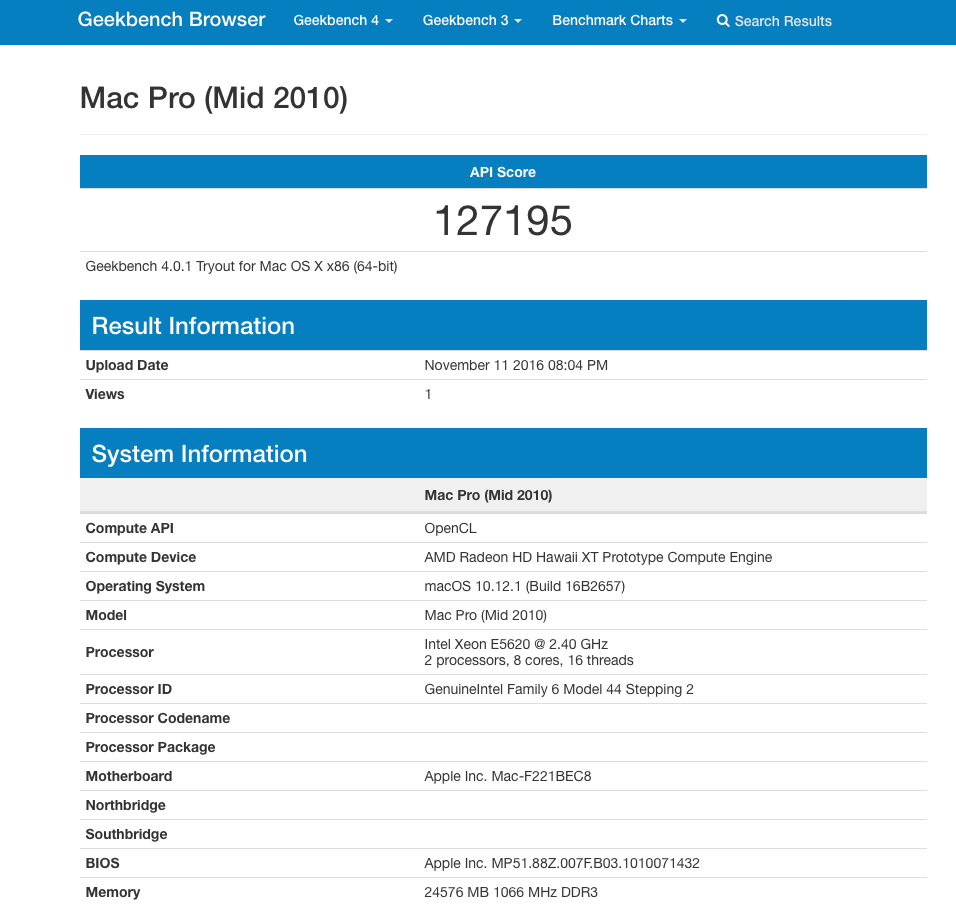

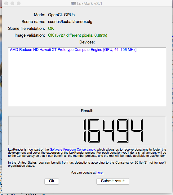

R9 390X
Now on to the R9 390X. I took out the Nano and replace it with the card. Tired powering it with a 6pin and a 6-to-8pin plug directly from the mini ports from the cMP and it boots. No need to edit any kext at all, and I’m wondering if its making use of the previous kext edits I did (including the one for the 480) and I can do normal low gpu tasks like watching youtube and browsing forums etc. But as soon as I fire up fcpx to try and render or try luxmark or geekbench, the display shuts off but the mac pro itself does not power off.
Switched over the power setup to utilize the 2 mini 6pin as one 8pin, and one 2xSata from the drive bays to 1x6pin. Booted the cMP and resumed the tests. This setup worked. Like the Nano, I fired up luxmark, geekbench, and bruce-x on fcpx. Now there is one thing that messed up here, I was able to do geekbench and brucex with no issues, but when I try luxmark, the system shuts off. So either my dual sata ports aren’t supporting the 6 pin or the 2x6pin-to-8pin wasn’t… either way I wasn’t gonna let it keep running that way, so I externally powered it with another psu. Now everything else works, and I continued with the tests.
Luxmark: 16494
Geekbench: 127195
Bruce-X 5K: 19 seconds average over 5 test
Screen Shot 2016-11-11 at 5.03.46 PM.png Screen Shot 2016-11-11 at 3.05.03 PM.png
Holy balls its as fast as my dual rx480 setup! Its faster on single luxmark and definitely blazing fast for the geekbench score. The brucex result was pretty much the same with my dual rx 480s, so im wondering now if I have the 2nd card then I’ll probably get a bit more performance.
Fun time?

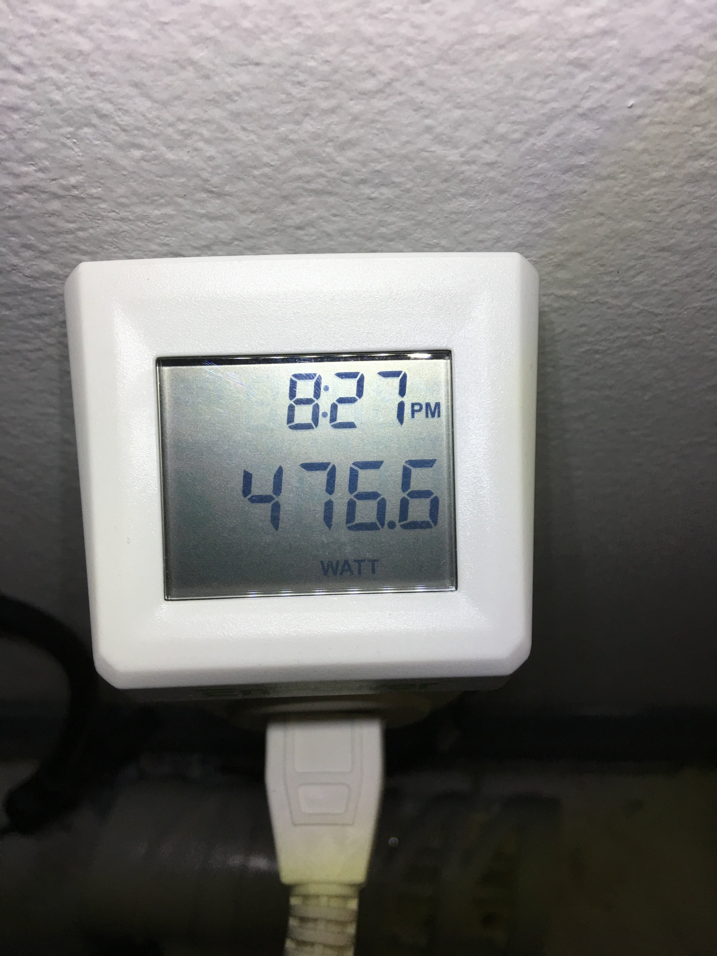

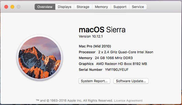

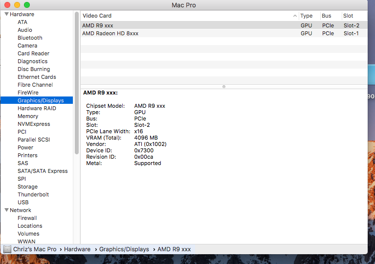

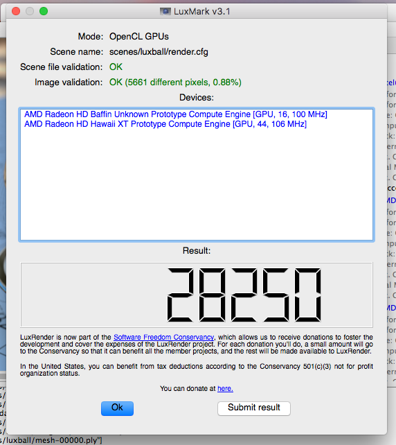

So for shitz and giggles I mounted both the Nano and 390x to ports 1 and 2 and powered them using the external PSU I already had out and ran the benchmarks ive been doing. The geekbench scores were the same, individual luxmark gpu scores were the same, and the combined luxmark obviously changed. Here are the results:
Luxmark combined: 28250
Bruce-X 5K: 22 seconds average over 5 tests
Now for the brucex, sometimes it would run at 19 and sometimes up to 24seconds so to me, it seems as if fcpx is using whatever is faster and not utilizing both cards together, or whatever is on slot 1. Who knows? I had a hunch that fcpx doesnt work with different cards but I figured, hey why not try it myself while im at it?
Now what do I get from all of this? Personal satisfaction and reason to move on with my life,… somehow. I’ll be returning the R9 Nano as I think that it requires more power by itself and I don’t get any significant performance boost out of it from my dual rx 480. I also checked the power draw from the two cards during stress test at luxmark, and on Idle i was getting about 150 and hitting 480 at full blast, a delta of about 330W for both cards total.

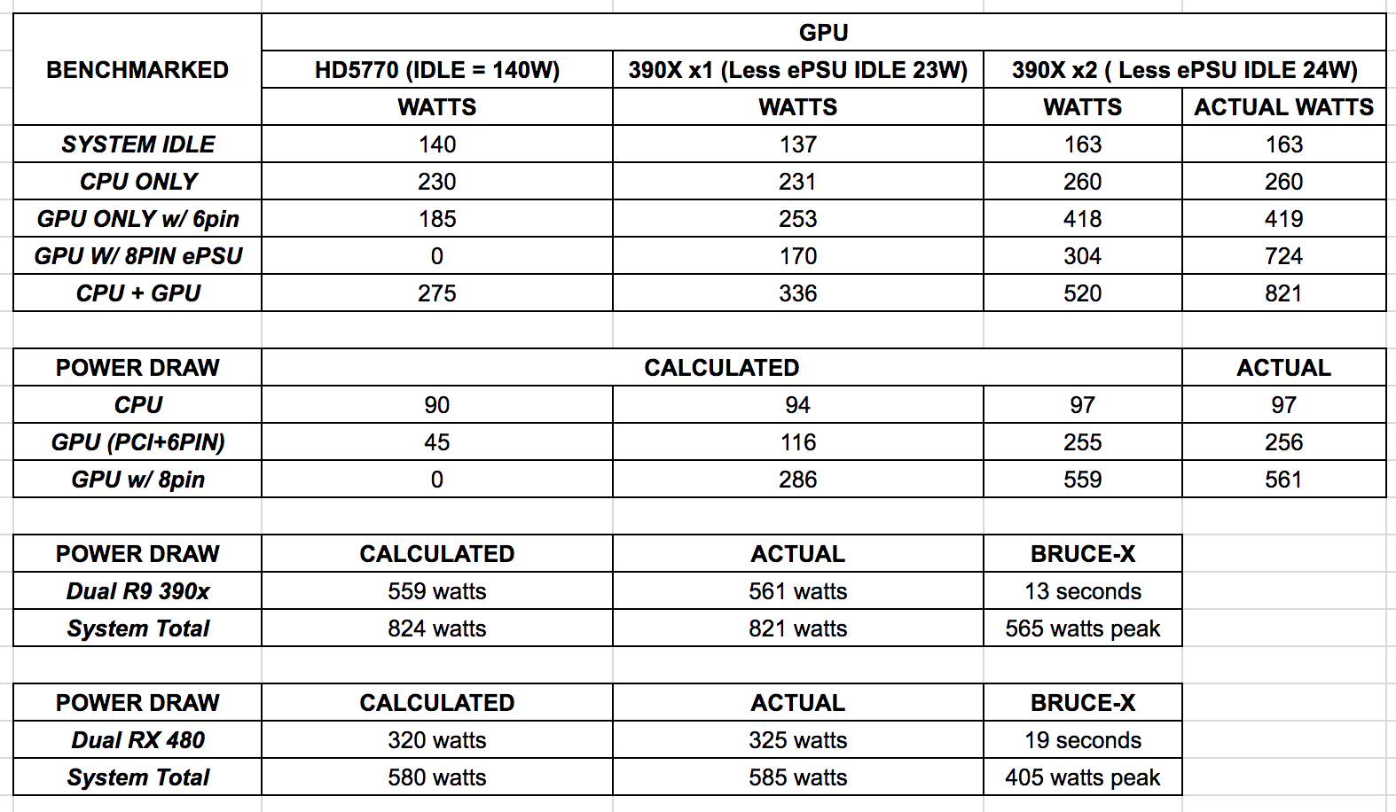

[doublepost=1479118800][/doublepost]I was able to get a hold of a 2nd 390x, so I did some testing and crunching number to compare it to the 480s, but mainly to find out how much power I'll need to run them both. My test system was a standard dual 2.4ghz mac pro 5,1 with a 5770 from factory. Basically I used this default config as my baseline, and then began swapping and running stress tests on the cpu/gpu/system in order to draw as much power from it as possible. Since I haven't done any permanent power modification on the tower yet, I opted for a standard 750W PC PSU with the paperclip trick to let it run. I'll be using a Kill-A-Watt meter to log how much power it's drawing at a particular time. To avoid having any extra power draw, the system is limited only to standard mouse, keyboard, cd drive, and an SSD for system drive. I removed any mechanical drives. The monitor was also plugged in to a different wall outlet on a separate wall, so only the cMP and the PSU will have the dedicated power.
Here's what I tested, doing all > Idle / stress CPU / GPU / CPU+GPU benchmarking then logging watts individually
1. Stock config, 5770 gpu on 6 pin internal
2. Stock config, 1x R9 390X on 6pin, 8pin on external PSU
3. Stock config, 2x R9 390X on 6pin, 8pin on external PSU
4. Stock config, 2x RX 480 on 6pin internal
Each watts column are what Ive measured individually on taking the highest -consistent- peak and average of 3 tries.
The actual wattage on the end columns are taken directly by having both ePSU and MacPro on the same power splitter. I've already subtracted the idle power draw of the ePSU alone while the system is on but under no load whenever applicable.
The last two table sets are actually the only important summary. The dual 390X's are pulling about 280W each card (PCIe+8pin+6pin) and by subtracting [GPU(PCIe+6pin)] from [GPU w/8pin] , im getting a consistent draw of ~150W on the ePSU 8Pin connector.

With the dual 480's on the mac pro, i can comfortably work on 3 4k streams with background render on but on "best performance view" so i'd still need to get some transcoding done to prores. It can definitely handle more than that when I transcode and use proxy media. Sometimes the events I edit have 4 or 5 4K cameras rolling at the same time, so multicam on those i'd have to use proxy.
With the dual 390X, ive been just working on multicam and grading directly on 3 4K streams, sometimes i'll have random stutter but still better than dual 480. I can transcode to prores and then edit more than 4 angles very easily at "best quality" view so I dont really have to use proxy. I can certainly edit directly on 4K streams natively when time is of the essence and i have to submit deliverables within a few hours. But when there's time, I let the computer transcode. I'm still testing these setups so I'll keep you guys updated.
