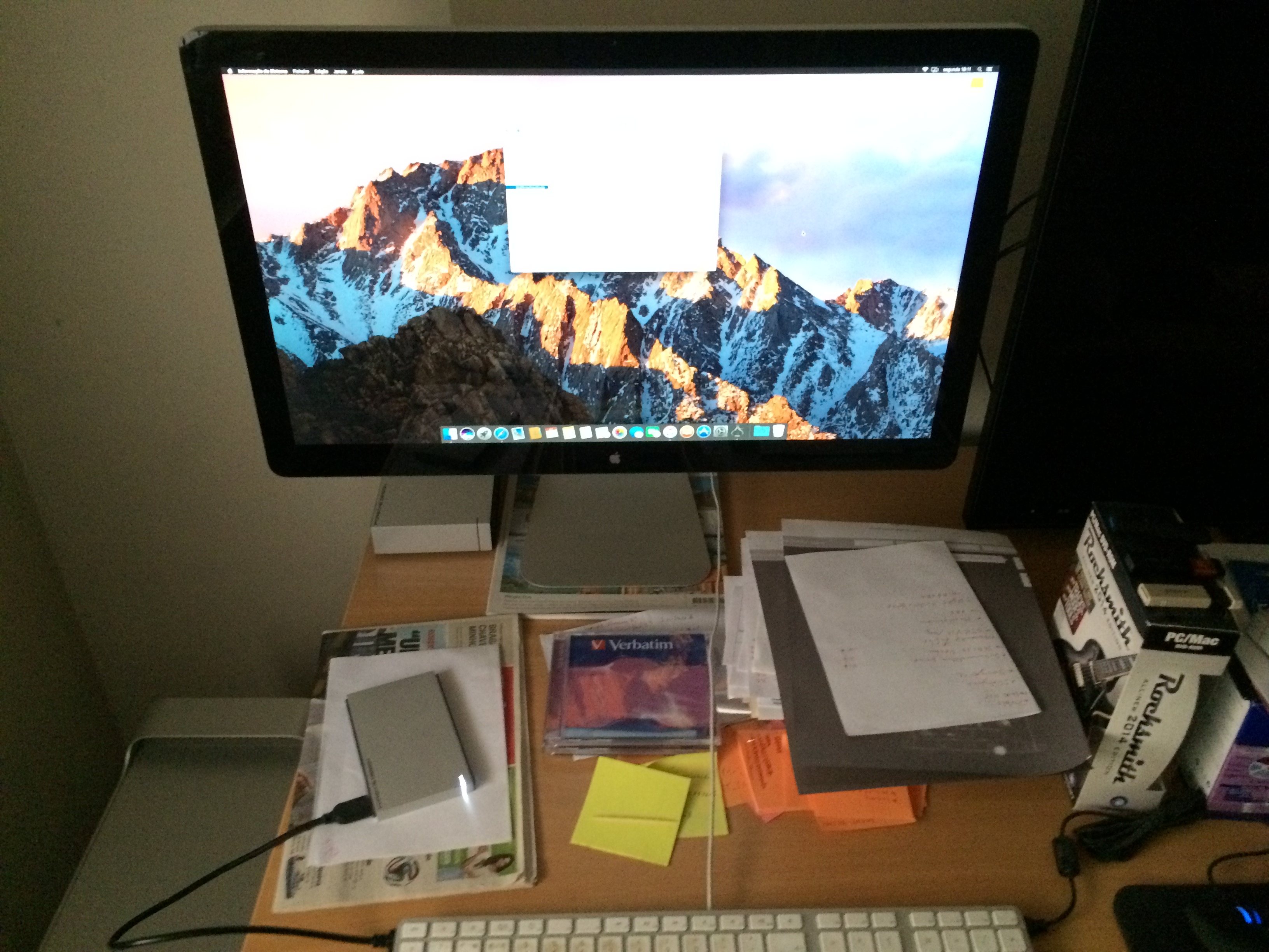

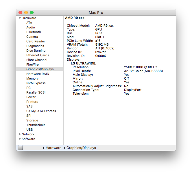

I found an open-box RX 480 8GB at Micro Center this morning and gave it a shot. Installed in my Mac Pro 5,1 which is running MacOS Beta 3, it can boot to the Desktop without any modification.
I recall reading there's built-in driver for this GPU but ID is not matched. Anything I should try?
Summary: RX 470 and RX 480 both work with acceleration and Metal support in macOS after adding PCI ID 0x67DF1002 to AMDRadeonX4100.kext. Other than no Boot Screen, you'll see UI during system update and in Recovery Mode. Kext editing needed after each OS update to reenable acceleration and Metal support.

Thanks for the test. So, it seems the support still very limited.
OpenGL crash.

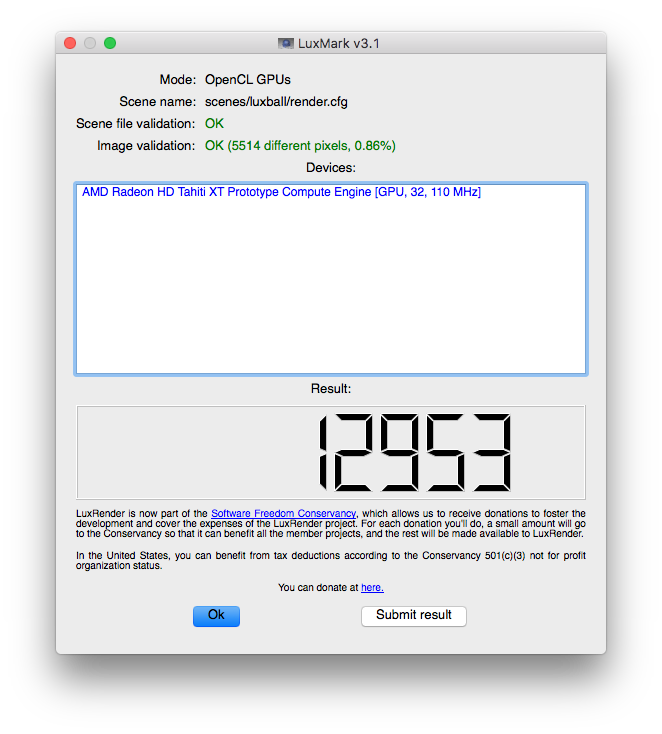

And OpenCL only perform a little bit better than a single 7950 at stock frequency. (It seems the clock speed has indication error. Yours should be 1260MHz, and mine should be 800MHz.)

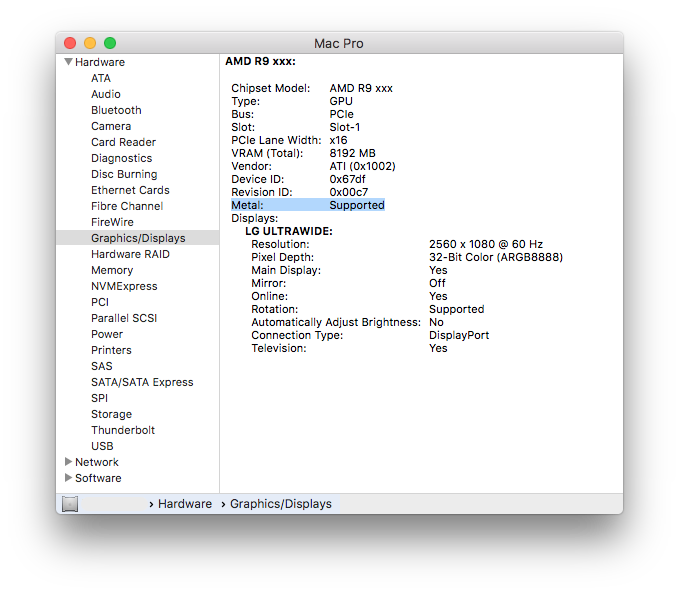

Simply plug and play, it was choppy. I modified AMDRadeonX4000.kext by adding the RX 480 ID 0x67df1002 and all is well. Interface speed and video playback is what you'd expect on a Mac with Metal running.

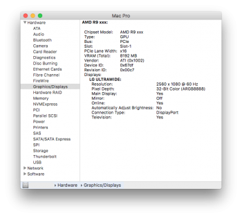

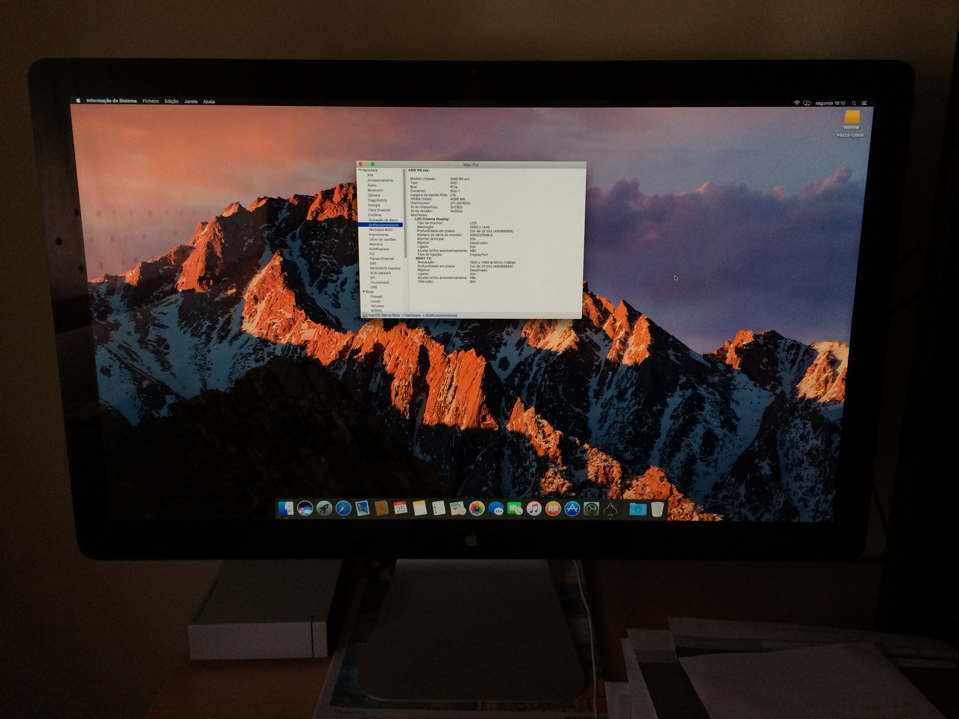

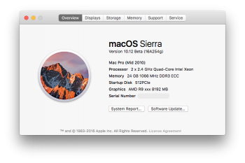

Hello. Finely, my Mac Pro from 2010 is not limited, to Windows 8.1 😉
R9 nano running on macOS beta… some glitches here and there but; it’s working!
No boot screen of corse. Is there a way to edit the bios; create/change the UEFI?
*Well, is better then nothing. I just hope they don’t remove the support for the R9’s...

Can you run all Luxmark and Furmark tests?
I was able to run all Luxmark tests. Furmark tests refused to run.
Hello. Sorry for the late reply. I couldn't do any test. Tried Luxmark, but, OpenCL is not working... when opening the app (GPU option), it can't find OpenCL!
