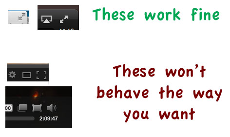

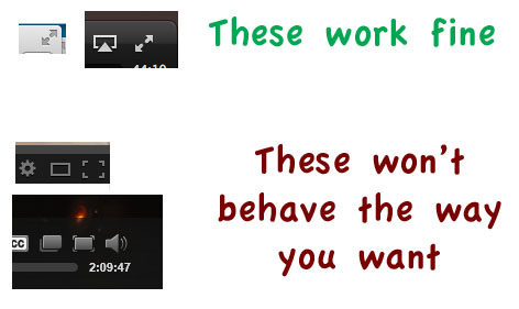

The key is that when you're watching an embedded video full-screen, you're not using the App "Full-screen" feature. You're using whatever method the video is using, e.g. the Flash player full-screen - which doesn't play by the same "rules" as app full-screen.
In a nutshell, if you can full-screen using the diagonal-arrows button - then it's using OS X full-screen method, and filling the "Space" - you should be able to use the other screen as you wish. If you're using the player or app's own full-screen method, you can't.
There are some work-arounds; for example Amazon streaming video (the last one in my example picture) has a "Pop-out" button, right next to their Full Screen, that pops the video into its own window in Safari - then you can full-screen that window with the Safari full-screen button in the upper right. You still have a title bar but other than that it works well.
