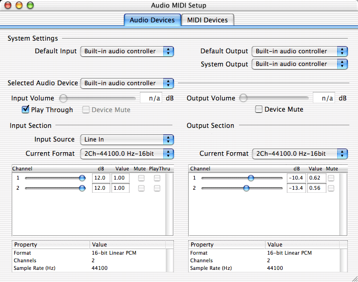

I cant confirm this as I dont have optical in on my Powerbook, but I do a similar thing to what you want at work (using the line in of course).
Go to Applications > Utilities > Audio MIDI setup. In the Audio setup you wanna get the properties for your Optical in, and set your clock source.
Now below that you should be able to check the box labelled Thru for the device? That should route the signal to your output. Thats how I get it working in Jaguar at work.. Good luck.

So this sounded real promising and was excited to try it. Today was the day and it was unsuccessful. I tried every combination of settings for the input and output, along with every combination from the Xbox (i.e. mono, stereo, dolby digital, dts..), nothing worked. In fact when the input was receiving a signal it blew away ANY output. Only a reboot would fix that.
So if anyone has any idea on how to get this to work that would be awesome. I'm pretty sure that I could buy an after-market sound card and that would to the trick, but come on, I've got optical in/out!
So maybe someone knows about a third party audio mixing solution that I could try.

Edit: Maybe you could talk to pulsewidth and get him to take a screen shot of how he has his optical i/o set-up. Sometimes a picture is worth a thousand words.
Yeah a screenie would be lovely wouldnt it? Not sure how helpful this'll be as its from 10.2.8, but the theory is still the same.
If I were you, instead of spending money, I'd just go with ghetto analogue connections. Cant say I'm too keep on consumer digital methods - optical compresses the signal slightly and messes with the high frequencies. Unless you need to use surround, but thats a whole other bucket of fish..

So I thought about the trade......naw! Thanks for the advice. I cross-referenced the settings, and they are pretty much the same except for a few design changes. One thing I've noticed is when digital input is selected none of the sliders below are active, they're grayed out no matter the format or bit rate. This is the case whether there is active audio being piped through it or not.
Analog isn't a good option. The xbox supports DTS and dolby digital and so does my receiver, I've just got to get the plumbing right. I'll try the garage band or audacity tonight.
