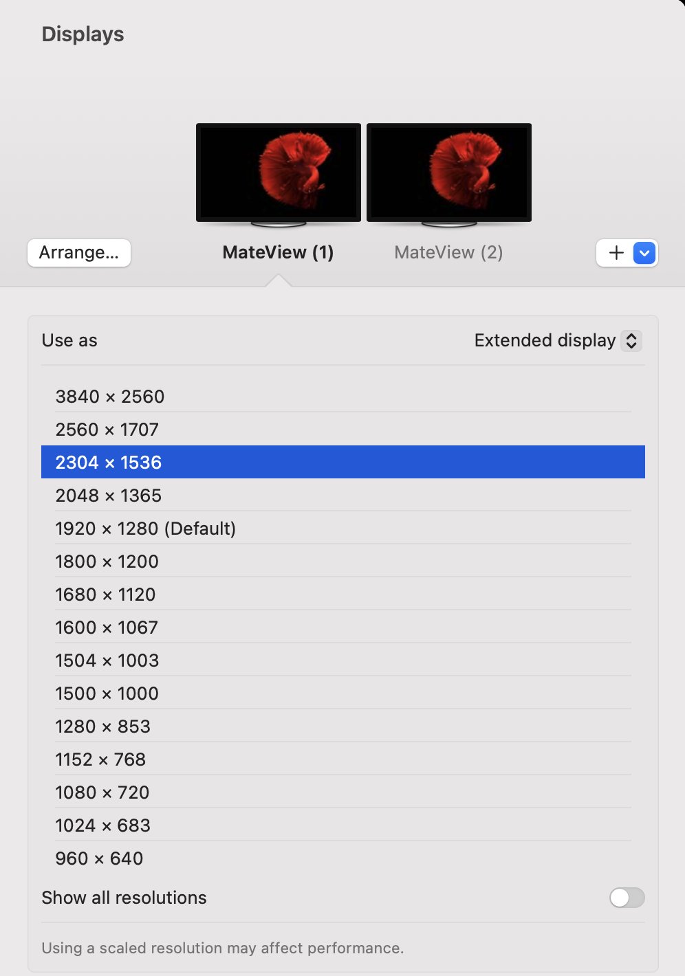

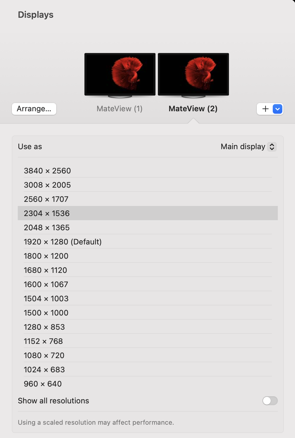

What resolutions are you missing? Which monitor?
P.S. My 4K+ 3840x2560 monitor can be run at full resolution over HDMI 2.0 with an M1 Mac mini, despite having 19% more pixels than 4K, but only at 50 Hz. To my pleasant surprise though, 50 Hz is fine. (30 Hz is not fine, but 50 Hz is fine.) My preferred 2304x1536 scaled resolution is supported over HDMI, but I know you prefer higher resolutions.
P.P.S. Another HDMI limitation specifically on Macs, is that Apple blocks DDC/CI through its HDMI port. So, you can't control brightness through the keyboard with an app like MonitorControl if you're using HDMI. You have to use the monitor's own brightness controls. Not the end of the world, but an annoyance nonetheless.
3,360 x 1,890 and 3,008 x 1,692. The resolution switchers can give you those but they turn out fuzzy.
Interesting. I can confirm this with my monitor as well. 3008x2005 is there for USB-C, but it is missing over HDMI. However, I use 2304x1536 and it's supported on both, and I personally wouldn't even consider running anything beyond 2560x1707 (also supported on both).

USB-C:
HDMI:

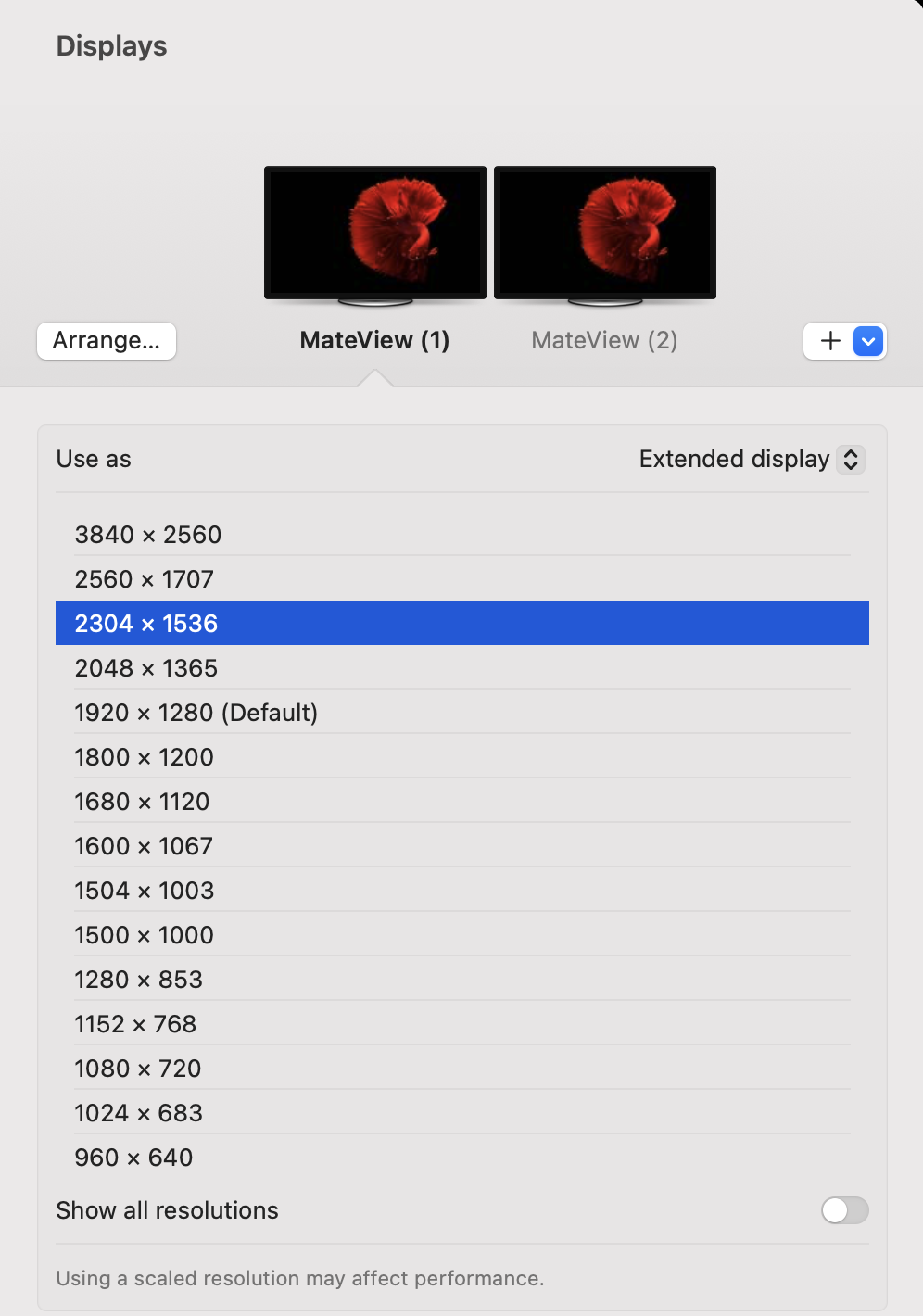

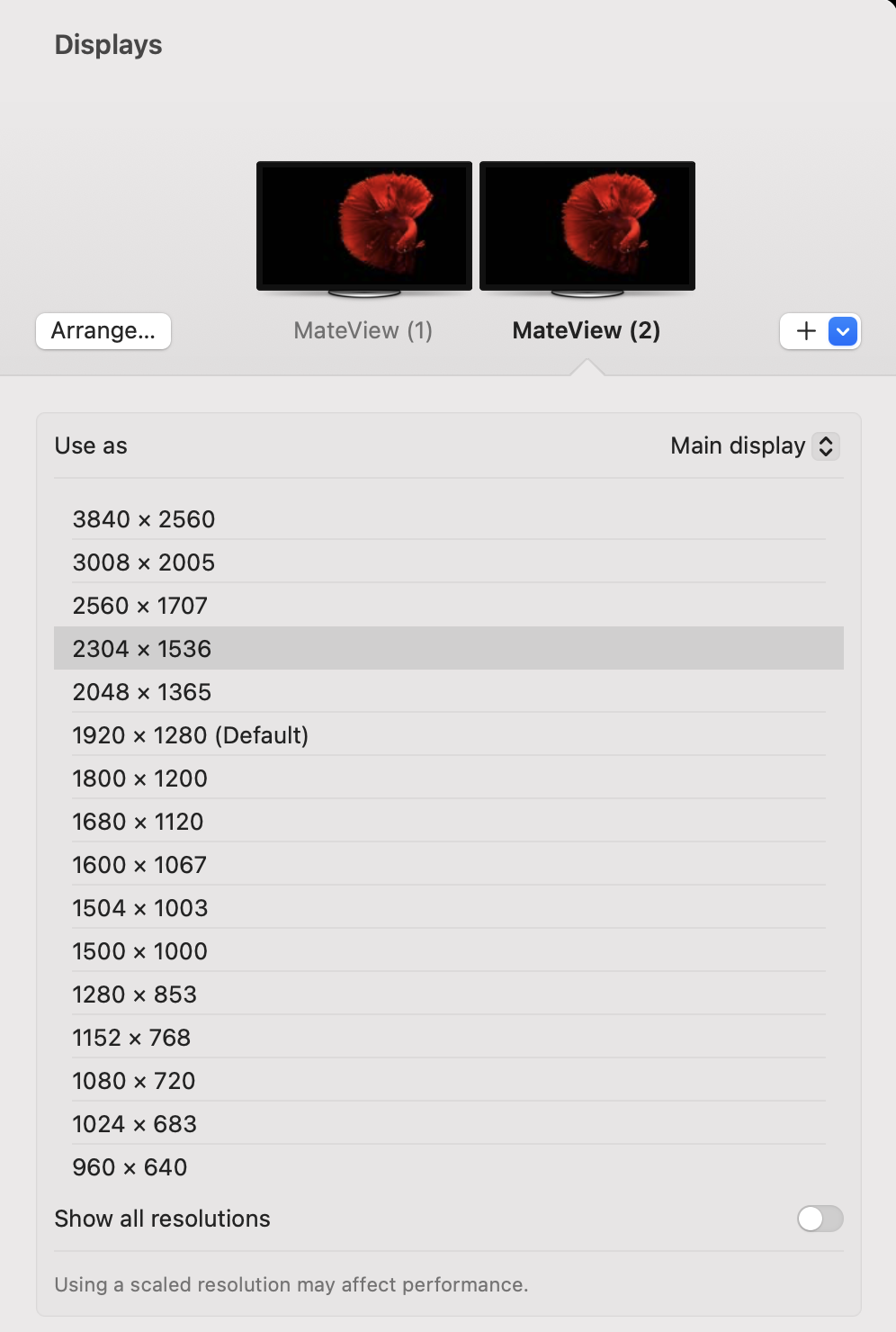

USB-C:
HDMI:
