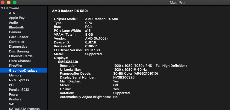

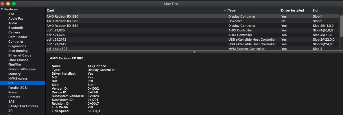

I tried this with my dual setup in OC:

Now I only see one display:
