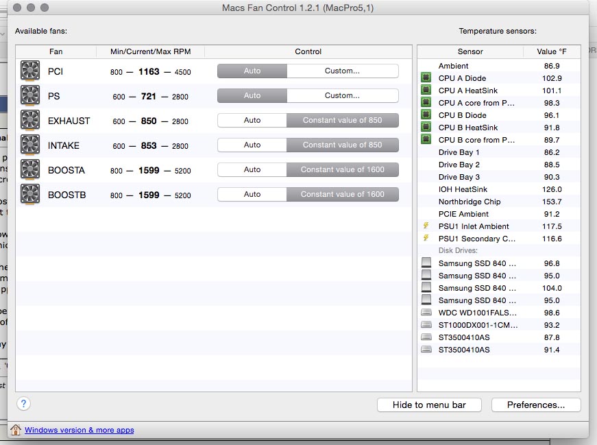

Glad we got that sorted out. IMO, you are running a bit hot, but not dangerous. I use Macs Fan Control. See attached. Note - Temps in F.
Lou
Thanks for the screenshot, at idle when running the same numbers my temps are very very close to that across the board. However even with a quick 10 min render using all the cores the CPU temps ended up at 82/73C and thats after I pushed the Boosters to 2k.

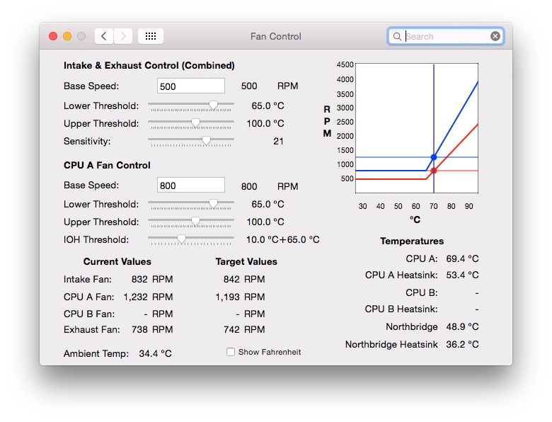

CPU As temp kept rising. Also if I'm just going to keep them at a constant speed why not use iStat's fan control? The reason I liked the idea of Macs or SMC was because of the sensor based control. I just wish I could set a rule and say run at a minimum of this value, and increase based on these sensors, and its either sensor OR constant value.
You may try this one. You can hard tune the fan base speed and fine tune the thresholds to make the fans have linear relationship with the temperature as you want. It can even allow you to control the fan sensitivity (how fast to spin up or slow down).
You may get the original version from here. https://forums.macrumors.com/threads/1340705/
I just add more parameters to it, and pack it into a installer. If the installer is not working, you may get other versions and follow the installation method in that post to control your fans.
