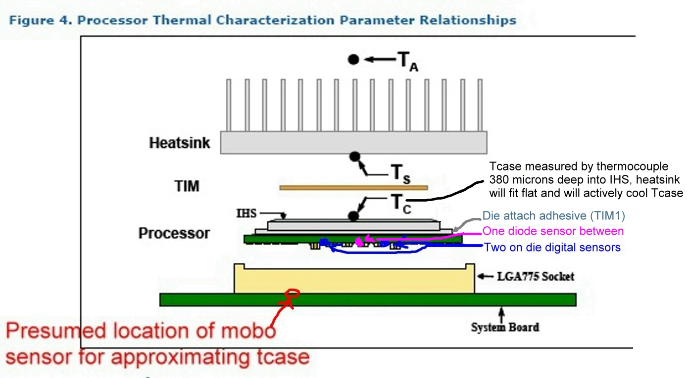

BTW, take a look at the following image:
  • Ta = Temp of air
  • Ts = Temp of heatsink (base)
As you can see, Ts and Tcase are only separated by the thermal paste (TIM).
I know the image is for an LGA775, but it does apply to the more recent CPU's as well.

BTW Part of that diagram is wrong. Apple removes the IHS off the top of the CPUs. Its said to increase the thermal conductivity between the HS and the Die, however it does not work as well as apple intended...bless their hearts for trying. The IHS should be made of pure copper,(albieit with counterproductive nickel or zinc coating so they can lazer names/models etc on it. can be easily sanded off with 2k grit and a glass panel)which will spread the heat over a greater area giving the HS more surface contact, more surface contact = more heat moved. Intel did that for a reason. Apple removed it to cut costs.
Only on the 2009 DP systems. The SP and both SP and DP 2010 models ALL use the Integrated Heat Sink.
In theory, their claims are valid (removing the IHS can improve thermal transfer between the semiconductor and the cooler), but it's not drastic, and puts the CPU in greater danger physically (i.e. over-tighten the cooler screws, and break the actual CPU).
In the case of it being needed in a MP, it's total BS, as evidenced by the 2010 models that use IHS in the DP models as well.
As per why they did it, Apple (may have been Foxconn's initiative) was being cheap, not Intel (if you've noticed, the retaining mechanism that's usually part of the socket is missing as well). Apple had to custom order those parts without the IHS.
In the case of Intel, it may have saved a few cents per unit on production, but they required special handling that easily could have consumed those savings (i.e. must be kept separately from the rest of the production so they weren't mistakenly sent to another vendor).
