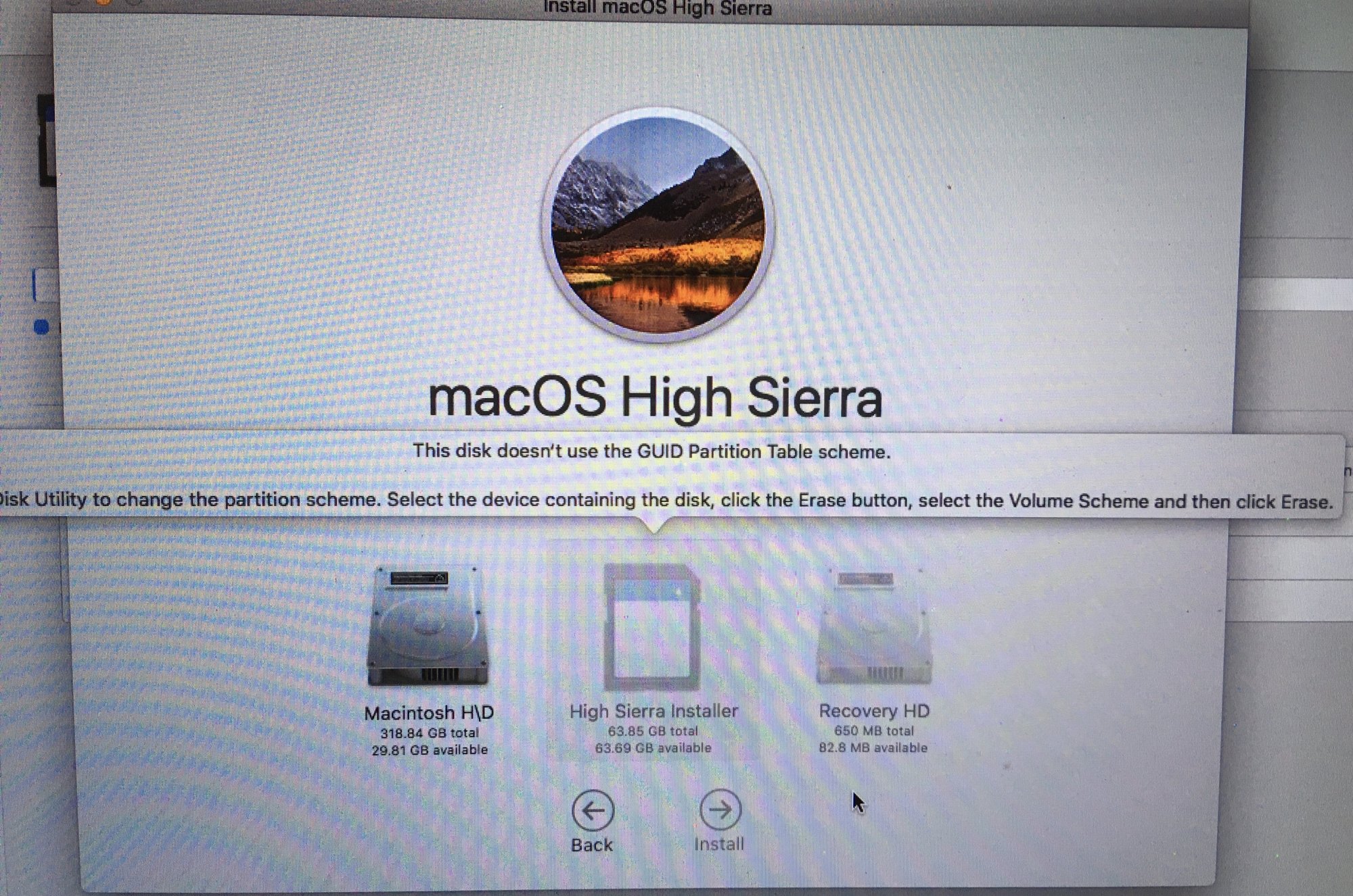

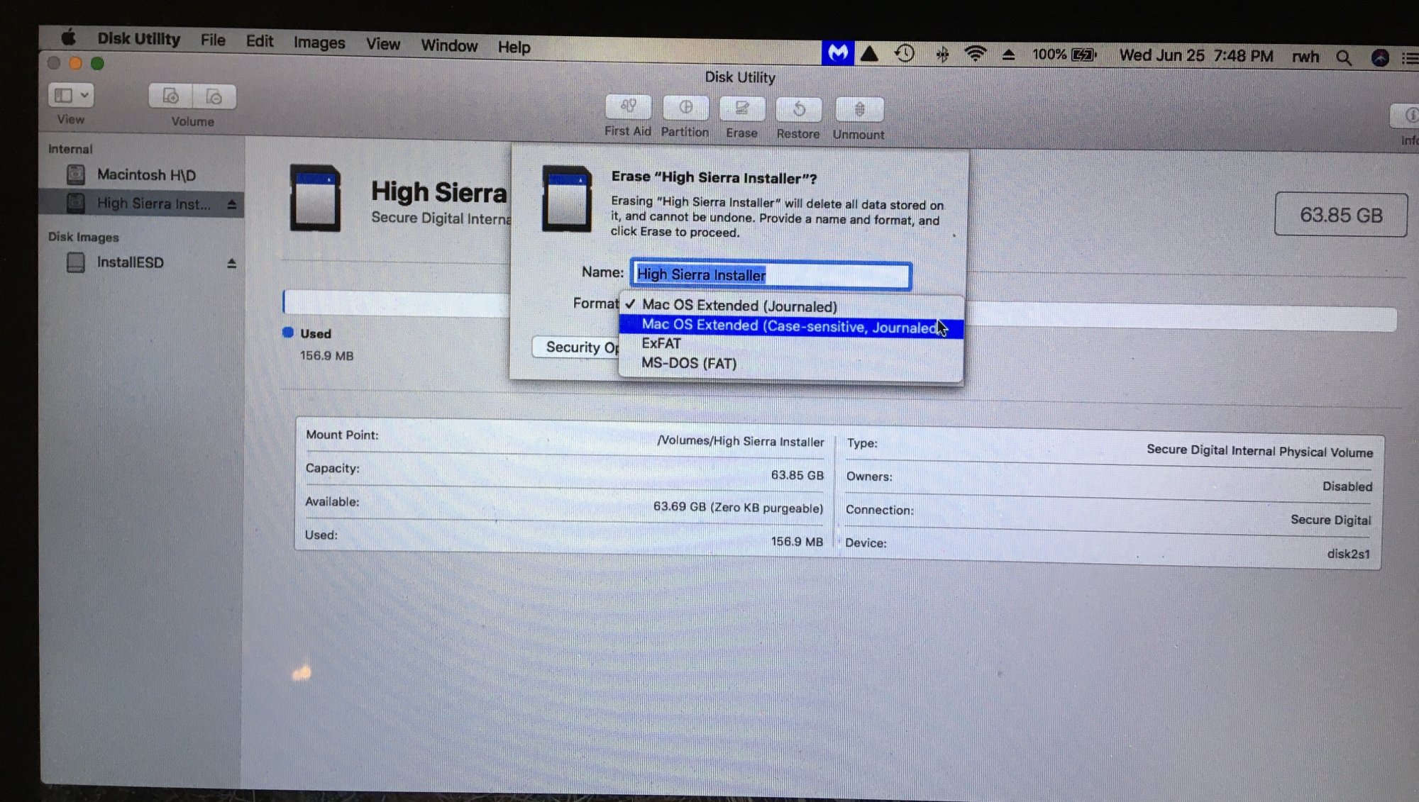

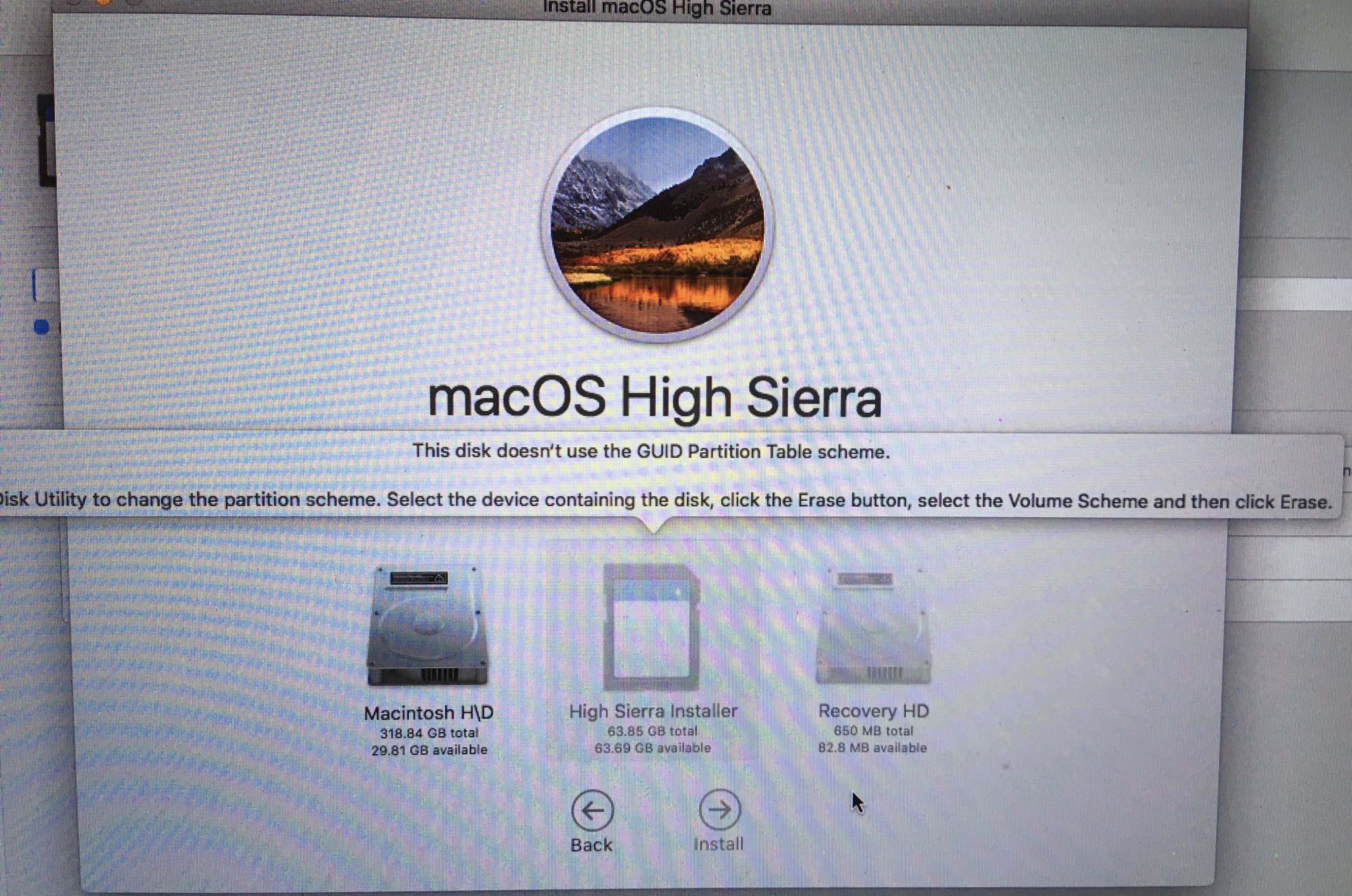

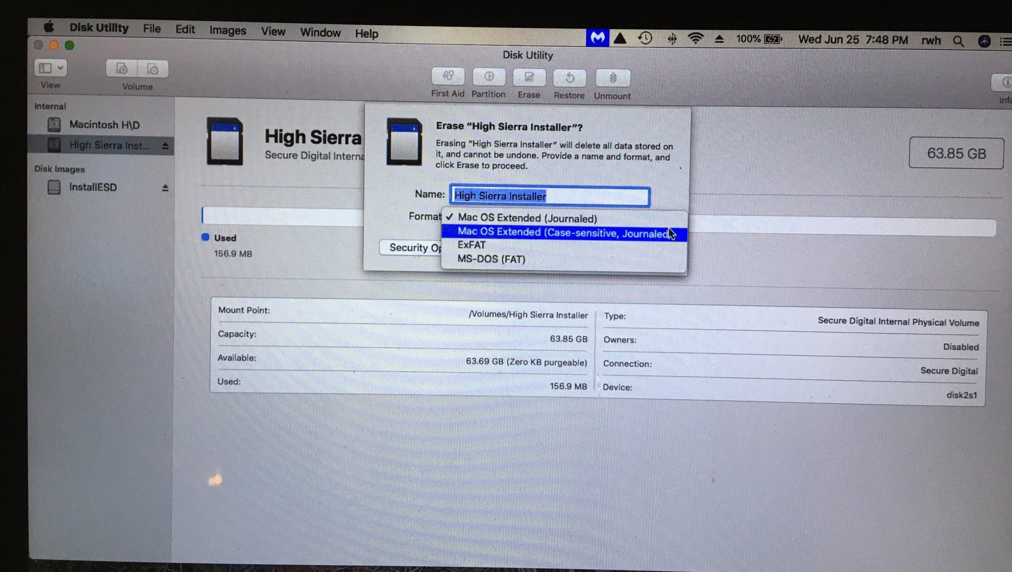

giving it a shot. went into disk utility, named SD card, chose Mac os extended journaled. guid partition was not an available option. i had already downloaded high sierra, to the point of install HS. my laptop already has HS.
some readings say i need to move the drive (sd card) to the top of the view so i can partition it. also, mention if the card is 64gb or larger i need to choose exfat?
If it mounts, you do not need to do anything to the SD card. Change the name to, "MyVolume" is easiest. Make sure Sierra is in the applications directory and then run the terminal command. That will format and rename the SD card.

Note about disk utility app:
You MUST always check disk utility to see if it has a "view" menu.
If it does, you MUST always go to it and choose "show all devices".
Otherwise, you can't see the physical media (drive, SD card, etc.)
Note about formatting:
DO NOT use "expat"
DO NOT use "master boot record"
DO use "Mac OS extended, journaling enabled, GUID partition format".
