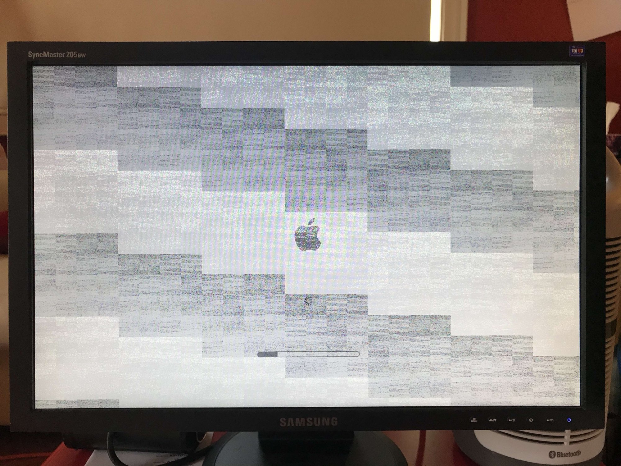

Well, truthfully, not literally dumpster diving as it was garbage on the side of the road. A Kijiji seller picked up this machine and put up an ad for it for one hundred bux Canadian (~US$76 or ~€64), so I went to check it out. There was no OS on it, but it did have the boot up chime. With my Lion external hard drive plugged in, it did also give me the grey Apple so that was encouraging, but then booted to a distorted screen and then kernel panicked. Nonetheless I bought it anyway.

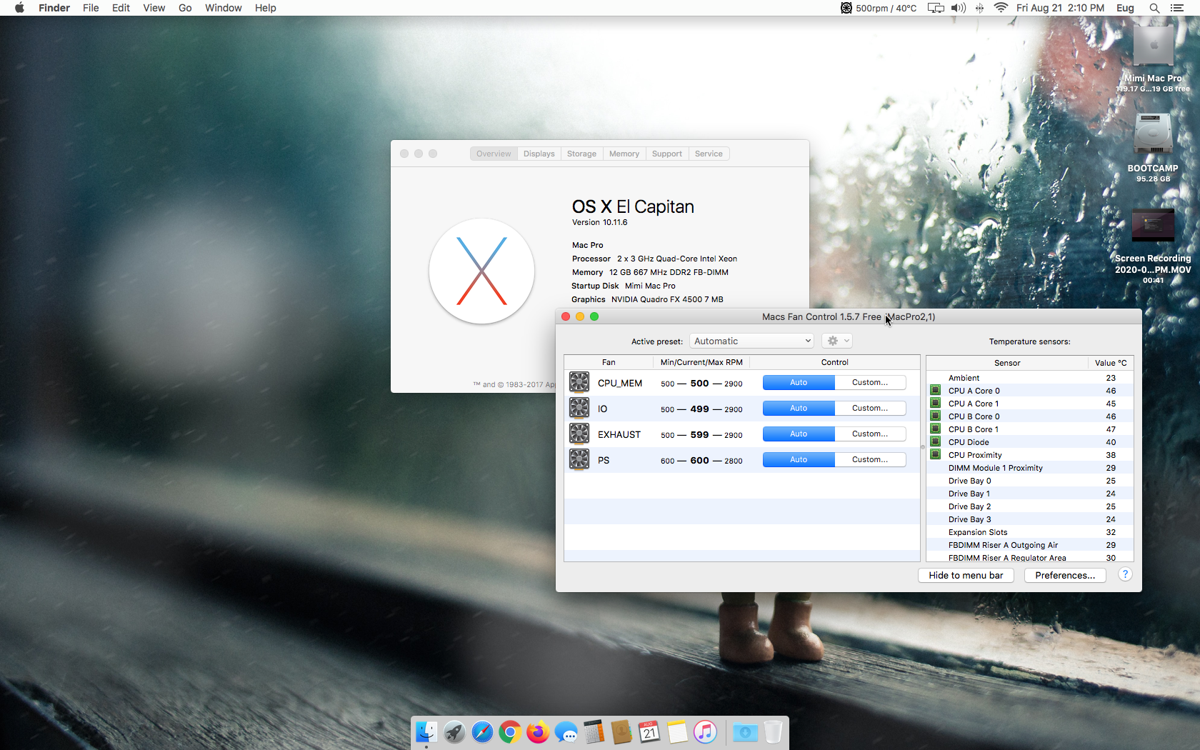

Also, to my pleasant surprise, the machine is very quiet. At boot up, the fans stay at minimum speed, despite the much higher TDP at 120 W, vs. the other machine's 65 W Xeon 5150. I had ordered the 80 W E5345 G0 for that other machine, but had I known, I would have ordered the 120 W X5355 G0 instead. However, at this point I don't know if I'll even bother installing the E5345 in that other machine since I won't be using it, now that I have this X5365 G0 machine.

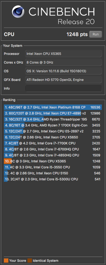

In Cinebench R20, you can see that the X5365 is well over twice as fast as the 5150.

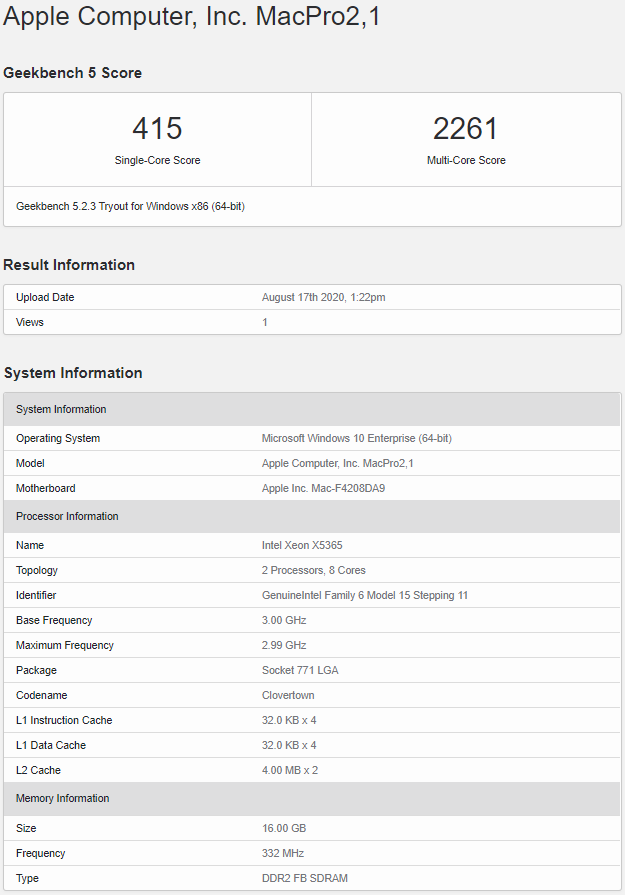

Since Geekbench 5 isn't supported on El Capitan, I had to run it Windows 10.
Multi-core performance is roughly the same as my 2017 iPad Pro 10.5" with A10X SoC.

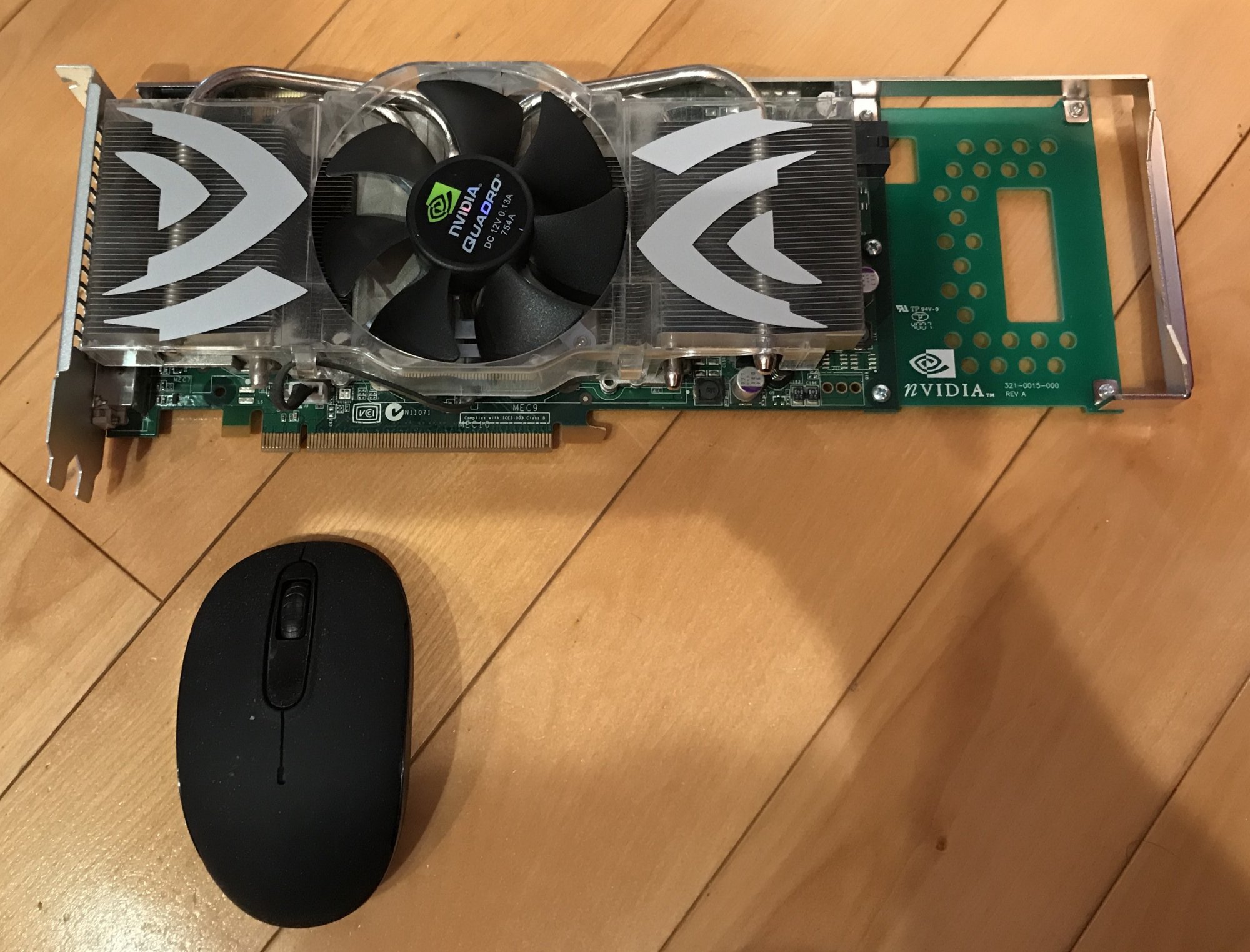

Is the Quadro just junk now? Or can I bake it or something to try to revive it?
How are you convinced/sure it's properly borked?
Based on this this page, my understanding is that the drivers for the Quadro FX 4500 are built into 10.6 Snow Leopard and 10.7 Lion. I tried booting multiple times off different external drives with 10.6.8 and 10.7.1 and it always failed. However, it boots just fine with the same OS installs and the same RAM with both my 7300 GT and Radeon 5770. Furthermore, with these cards, the machine is completely stable (even with the CPUs at max for several minutes while doing benchmarking).
I suspect the GPU was the reason the Mac Pro was in the garbage, and also the reason the seller priced it low as an as-is sale.

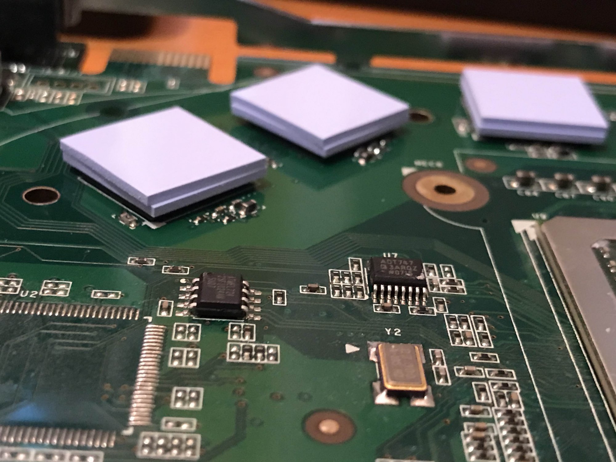

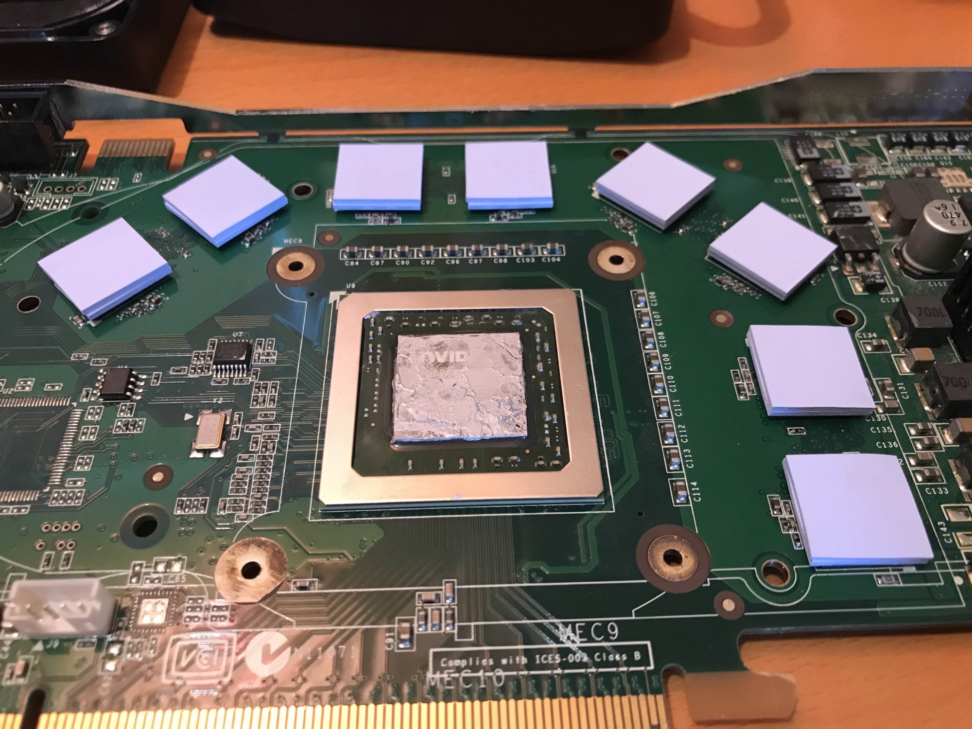

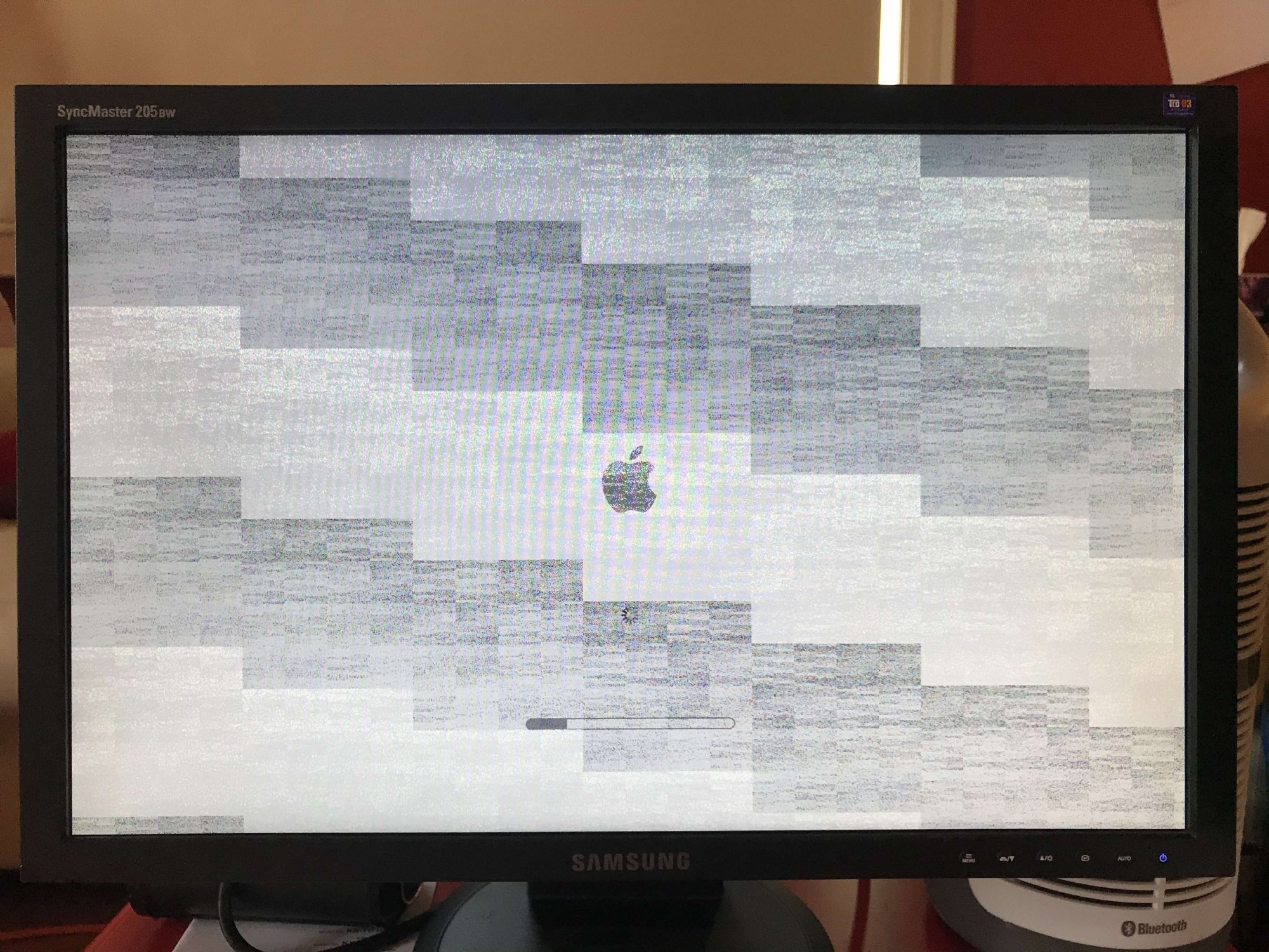

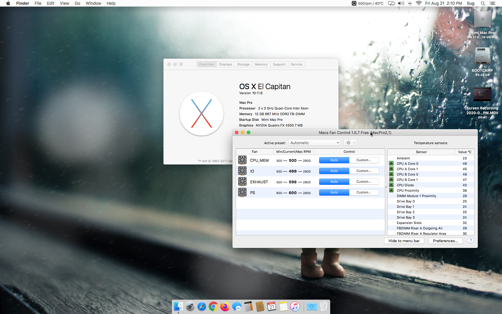

I did the bake trick on the defective Nvidia Quadro FX 4500 video card. At first it didn't work but it turns out it was because I had removed the thermal pads from the memory, and unfortunately the thermal paste wasn't touching the memory heatsinks. So there were all sorts of video anomalies, and it wouldn't boot completely. Those anomalies weren't there before I did the bake trick.
So just as a test, I just stuck some metal washers with some thermal paste there to see what would happen. Well, it completed the boot and I could use it. It was slow I believe because it doesn't accelerate El Capitan, but nonetheless it works, albeit with a lot of anomalies.
The anomalies don't show in the screengrab above, and in El Cap it's only showing up as 7 MB memory, but otherwise the GPU chip itself may be OK.
I will remove the washers from the memory and buy some thermal pads to see if that eliminates the snow. If I can make it work, I'll only get a card really capable of Lion, but for ~US$5 in thermal pads maybe it's worth it. It will be an interesting experiment for me regardless.

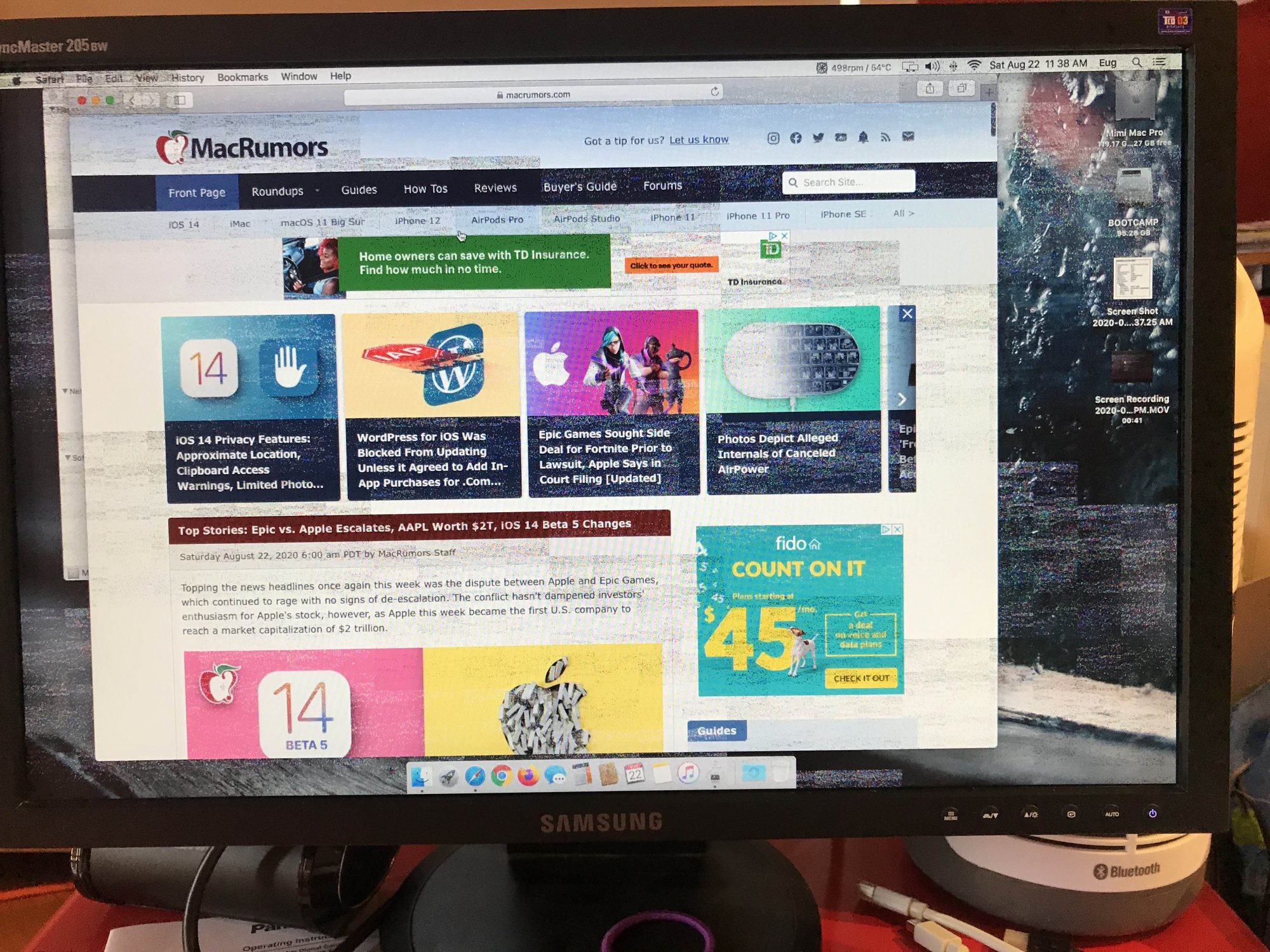

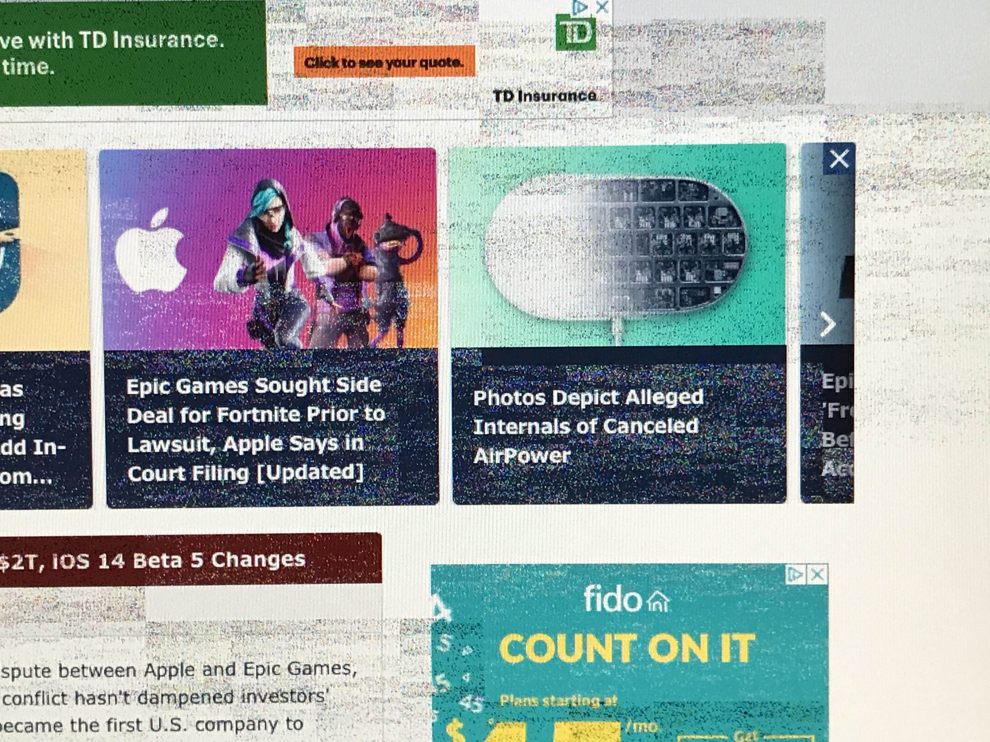

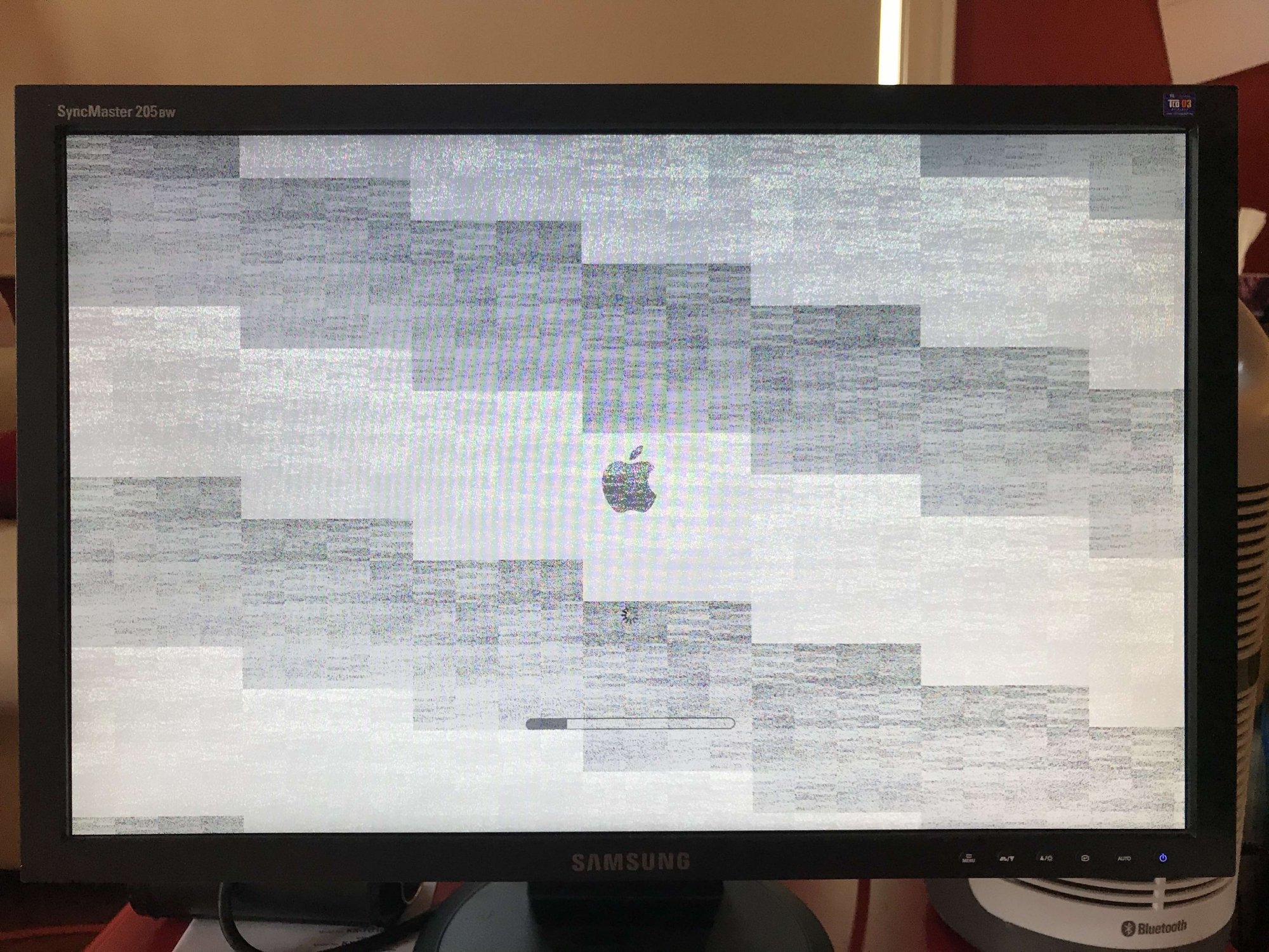

No, not the Mac Pro, just that Quadro FX 4500. Despite heroic efforts including the oven bake and a few bucks of thermal pads off Amazon, I cannot get it to usable functionality. Into the electronics waste pile she goes.
As mentioned, after the bake I can now get it to boot, but it's full of anomalies. The thermal pads maybe reduced the number of anomalies a bit, but there are still lots of them. Just in case you're interested, this is what it looks like booted up:
I had bought 1 mm thick thermal pads, but it turns out they were not thick enough, so I tried two layers, but still no joy. I think the bake must have damaged the memory, even though it stabilized the GPU itself. The GPU baking gods giveth and the GPU baking gods taketh away.

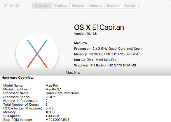

This particular Mac Pro 2,1 has a B08 firmware, as you can see here. I knew B08 was different, but I didn't know that was significant.
Why is it significant? Cuz everyone else has the B06 firmware. People didn't even know the B08 firmware existed. In fact, the official Mac Pro 2,1 firmware updater to update older machines doesn't actually provide this B08 firmware, and only upgrades machines to B06. 🤔 Thus, everyone doing the upgrade hack from Mac Pro 1,1 to 2,1 has been using that older B06 firmware.
That older B06 firmware does not specifically recognize a specific class of Xeon - the Xeon X5365 SLAED G0. This is a lower power version of the X5365 and thus it is popular for upgraders. This works with the B06 firmware, but it's not specifically supported. This new B08 firmware specifically recognizes this newer lower power version of the CPU because this machine uses it, so now the firmware upgraders are quite interested in this machine. 🤓
