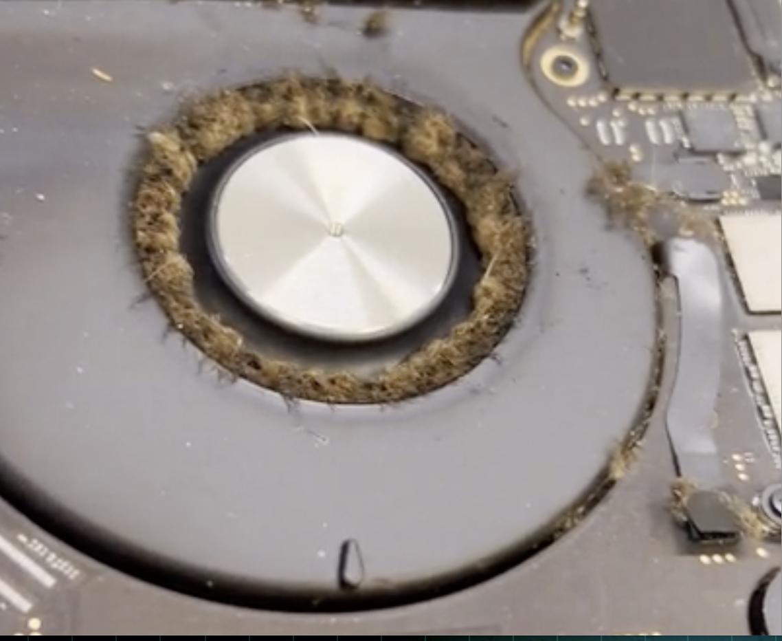

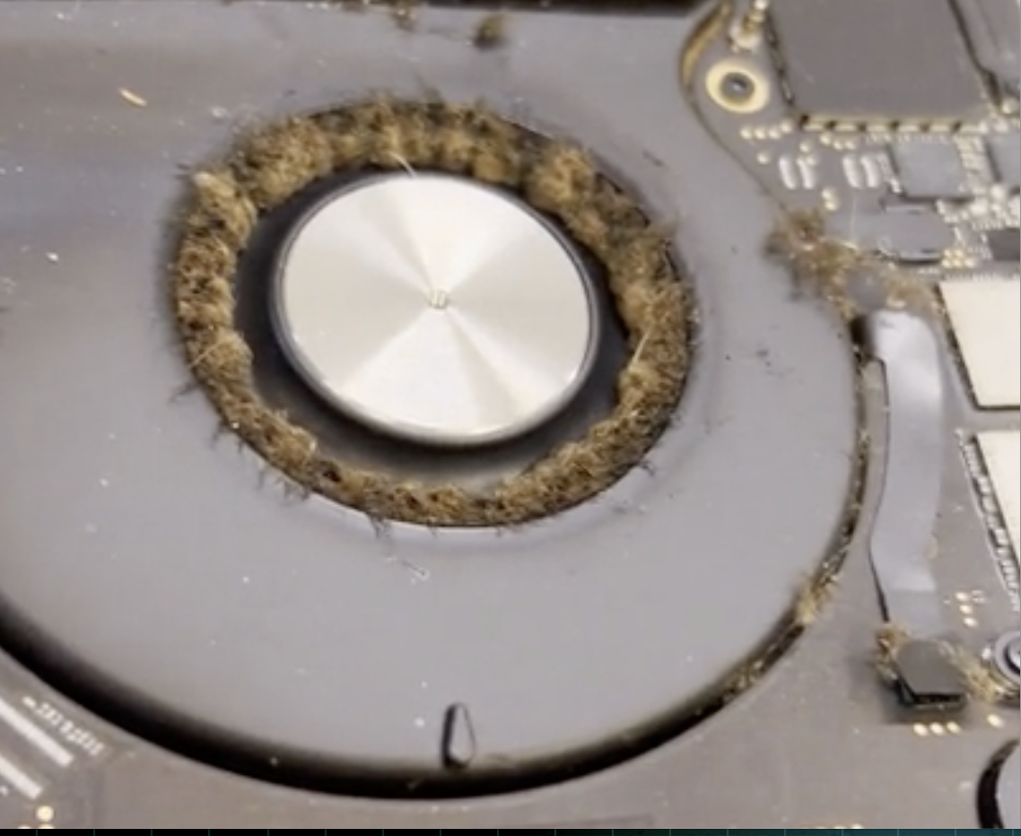

You will get dust build-up inside and it will over time cause an increase in operating temperatures. How much and how hot depends on how dusty the operating environment. The dust builds up first on the fan vanes so using compressed air to clean just forces debris deeper into the machine. Apple designs the cooling system with enough margin to tolerate dust build-up.

oh wow, thanks for the info. That's quite a bit - how long do you think it took before that much build up?

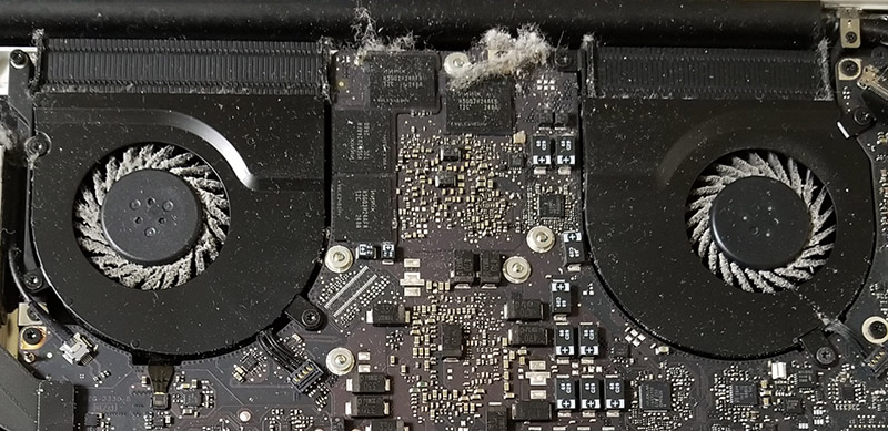

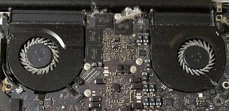

This is what I found when I opened my 2012 MBP 15" to replace the battery last month. I didn't remove the fans. I used compressed air to blow the dust bunnies out.
