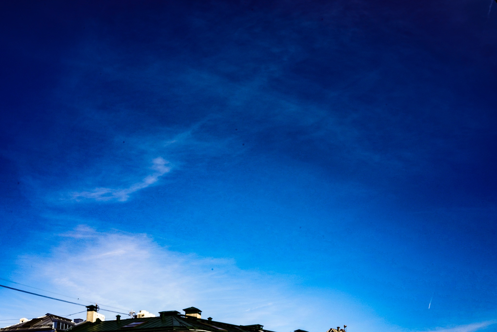

Can you get sensors clean to the point where no dust is visible @ f22 on sky with standart dry cleaning methods? Or there will always inevitably be some dust visible @ such settings when especially searching for it 🙂
Just for fun I tried to max LR Dehaze filter and noticed that you can find small spots present at narrow apertures even if they do not show up on standart image @ f22. Probably this is normal - or such thing does not appear on your camera sensors?

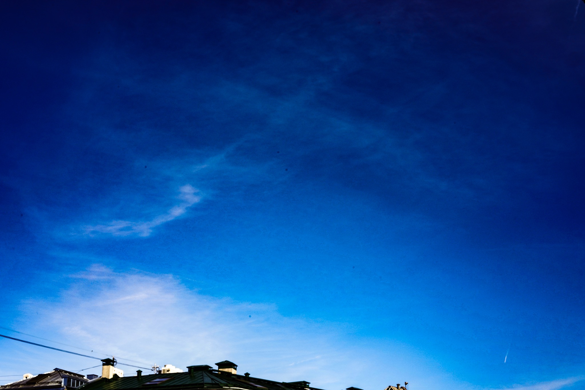

It's possible but it depends on what exactly is on the sensor. Dry lint/dust should come off easily with a dry clean. Anything moisture based may require a wet clean but that's very rare for me. I once had a small fly stuck to my sensor that required a wet clean to remove.
This is normal.

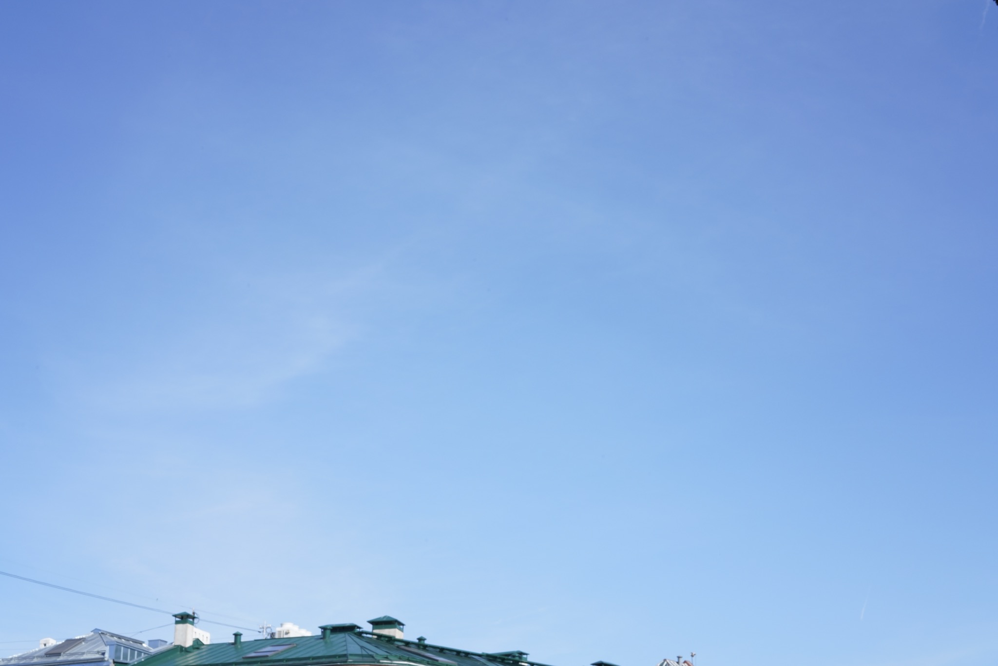

@ this point I am pretty satisfied with how the sensor looks after dry cleaning at f22. If I play with Lightroom and search the image for a long time 🙂 I can still find some tiny dots in the center of the image (2nd picture) and a spot from rear element in the corner...but this is probaly what it is for a 42MP sensor.

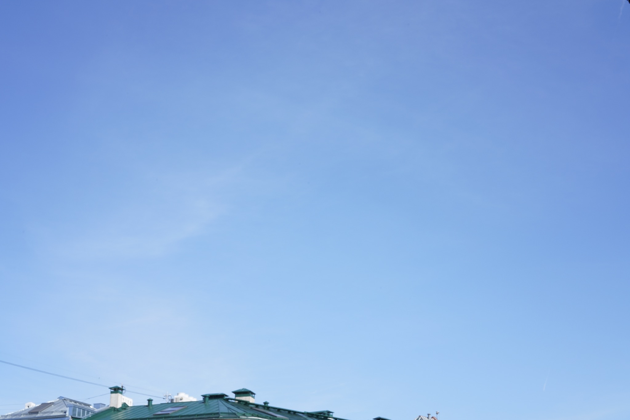

Cool... Dont wet clean unless you have to is my approach

Also remember that images are flipped in both the horizontal and vertical axes as light passes through the lens to the sensor (or put another way they are rotated 180 degrees). This means that if you see a spot in the lower left corner of your images, the dust is actually in the upper right corner of your sensor (when viewed from behind the camera as when taking a pic).
I had a large piece of something in the lower left corner of my pics and I kept using a blower on the lower right corner with the camera facing me without success. It was only when I looked in the upper left corner with the camera facing me that I saw the dust and was able to blow it off.
To think about it graphically, draw an imaginary grid on your pics with zero in both the x and y axes being the center of your pic. If your dust is in lower left of your pic it would be at negative x and negative y in the pic. When cleaning the sensor (and thus having the camera facing you), the dust will be at the same negative x but at positive y on the sensor.
