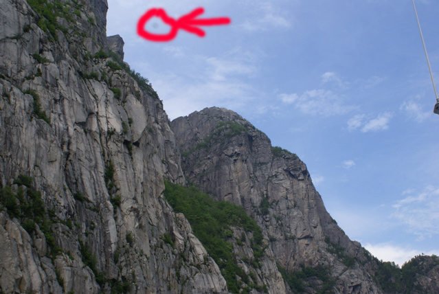

Hi,
I have noticed that all my recent shots have a dark spot in the picture, in exactly the same place. I've attached an image to this post as an example. It appears whichever of my lenses I use, so I know that it is not a lens problem. The camera is a Sony Alpha-100.
From people's experience, is this just a dust particle? I am concerned that it is too large for this (photo was originally 10MP, scaled down for this post), as I think these generally cause small spots. Should I be concerned? There are no other spots that I can see.
Thanks for any input!
Calvin
It is dust. No need for alarm. The reason it looks larger is the magnification of the lens. My advise is to buy a Giotto Rocket Blower. This is an alternative solution to cleaning your sensor on the go without the use of liquid. There is a highly capable cleaning system that many photographers will certainly support. It is easy to use but would require you to be home or at a stationary place to use it. I highly recommend that for the dust that simply won't move, however in 3+ years I have not ever cleaned my sensor with such system. I have cleaned someone else's system. I use the Rocket Blower and it works very well.

Wow, quick response, thanks! I'll give the rocket blower a go first... I'm not in the US, however I think Jessops in the UK sell a similar product.
Whatever you do, don't use compressed air. Not only is the force of the air too great; but worse, you'll get at least a little of the propellant onto your CCD/sensor.

If you can see it through the viewfinder before you take the picture, it's the mirror or the prism. If you can see it in the picture, it's the AA filter over the sensor. A soft lens brush should be ok on the mirror.
