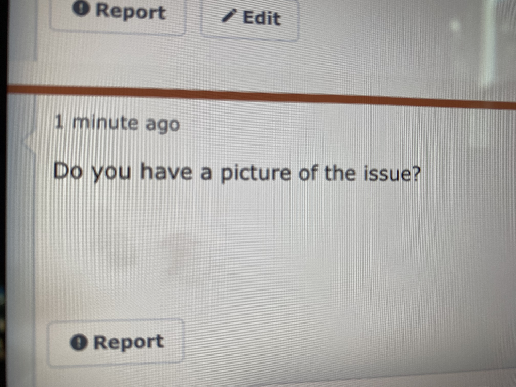

I do. This is the lower right corner.
Second replaced display. Some of it looks like greasy finger prints, some looks like residue left from peeling off a layer of protective plastic from a mirror.

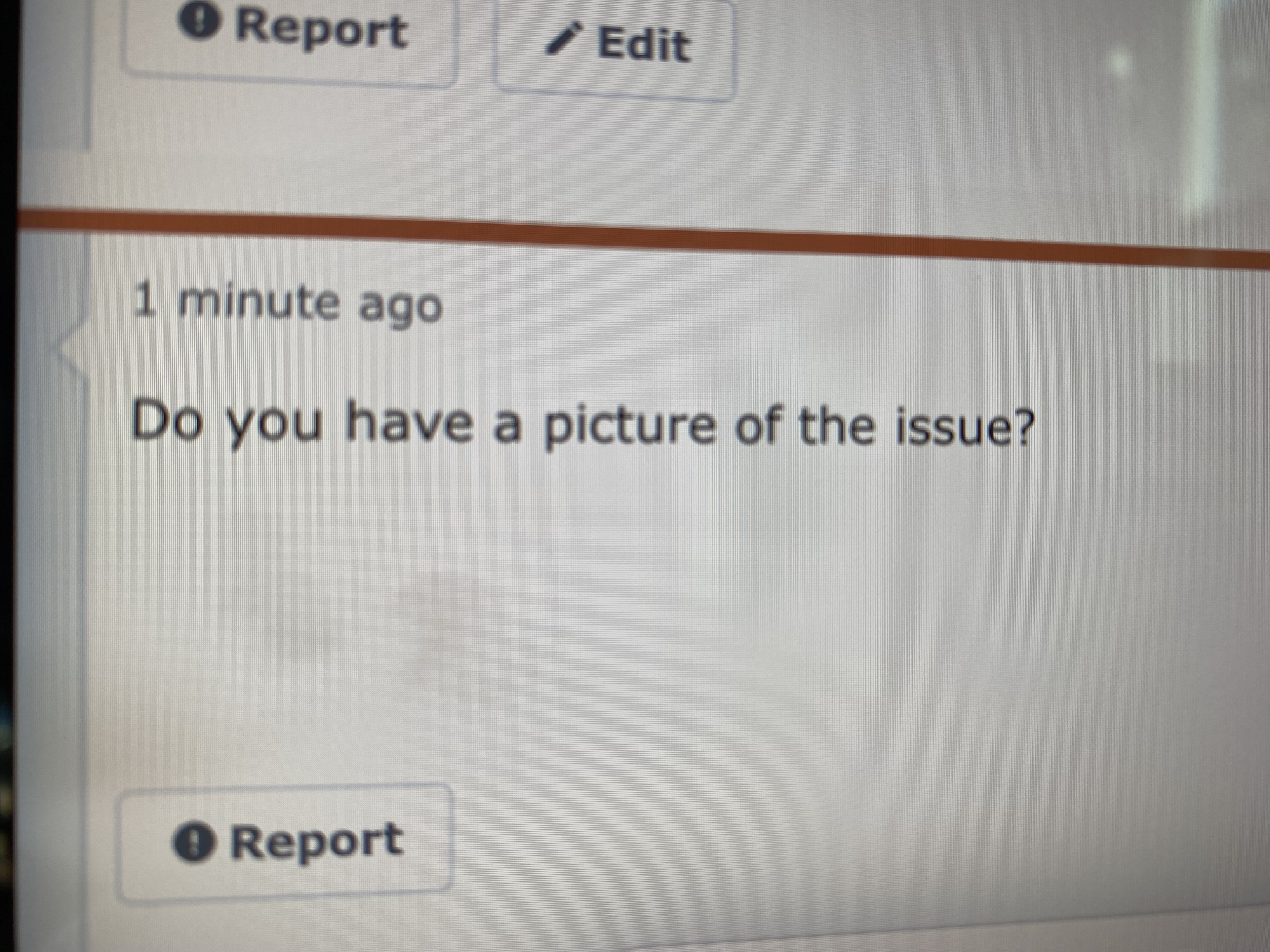

Very tiny dust particles get under the plys of the LCD and onto the internal side of the glass - usually in the lower left and right corners of the display. I have opened up and cleaned a 2019 27" iMac LCD myself to remove the dust. It is a design flaw with the 2014-2020 models in my opinion.
Interesting. They said this is extremely rare, and that they'd never seen anything like it in the 13 years they've worked with Macs. First time it happened I was told they switched to a new supplier for the display, second time, no explanation, they were super busy, just placed the computer in front of me and walked off. Now it's dust.
