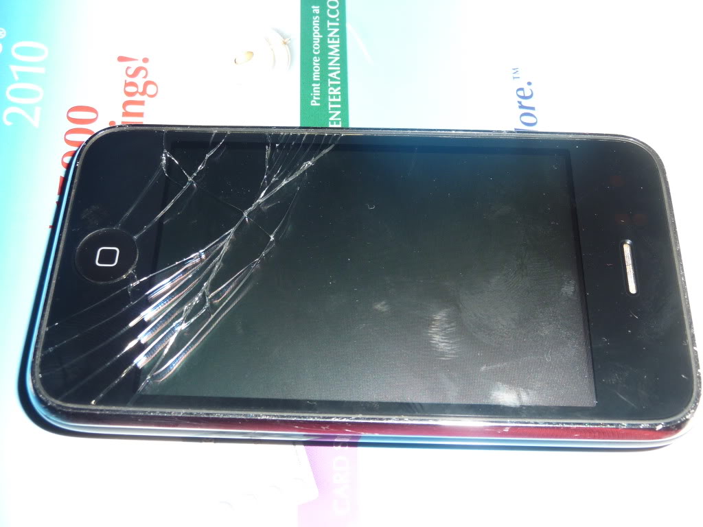

I cracked my 3G screen last week. It was my first time dropping since buying it on day one. I had it in my lap (which i normally never do) while driving and it fell flat on its face when i was getting out. 😡
I've already ordered a replacement glass and digitizer since the phone still works perfectly. My problem is that I can now see dust specks accumulating under the glass. What's the safest way to clean the LCD when I'm taking it apart?
Oh, here's a pic of the damage.
the digitizer and glass are two pieces. so i dont think theres anything under the digitizer, well, you ordered a new one, so when u take those out to replace them there wont be any dust. i never took apart my phone so dont flame.

So I read another thread about dust under the surface. Someone said that the 'Seal' was compromised usually either due to bending and in your case a beautiful crack to the face of the phone.
The suggestion was to go to the Apple store and book an appointment with a genius and you can have the whole phone replaced.
So yesterday when I was out purchasing my wireless keyboard for my MBP13" I asked about getting my iPhone checked out for the dust specks.
Genius booked an appointment for me and suggested that I back up my phone prior to seeing the Genius.
SO, here I am with a Brand New iPhone! Just as long as you're still under warranty you should be fine but if not I guess a can of compressed air should suffice, by either blowing through the cracks.
