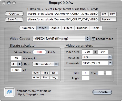

Well, I just kind of plugged away and found that using FFMPEGX I could rip a .mp4 .avi. I still don't know why QT wouldn't read the HandBrake .mp4 rip. Anyways, if I make the bitrate 7,000 - the end result isn't so bad. Only problem, now, is that the ripped file is s-t-r-e-t-c-h-e-d. Here's the screenshot of my settings. Any suggestions? screenshot.jpeg

I suspect that the fact that my end-result rip is stretched horizontally is because I've got the settings wrong. I'm hoping someone can guide me as to the settings I should use to avoid the problem.
