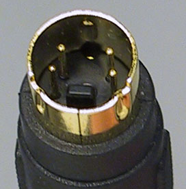

EDIT: does it look like this? cause this is S-Video, not DVI. Edit: ok, never mind. i don't think you're thinking of s-video....
