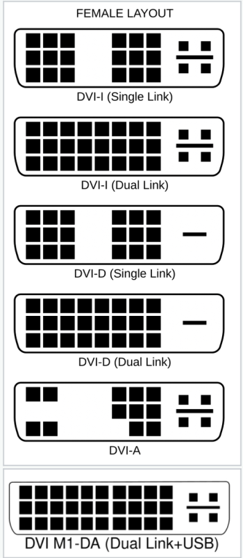

Trying to connect my G5 with X1900 GPU to a Dell U2715H monitor.
Could this be my problem…?
The GPU is DVI-I, but the cable is DVI-D to HDMI.
Would a single link DVI to HDMI work, I don’t need the screen shared G5 to run at full rez.
It only needs to be connected for occasional direct monitor access (i.e. for shutting down, as this cannot be done from screen sharing, so I can just switch monitor inputs).

The cable I have has the full bank of square pins (technical term…. 🥴), which is a dual link (screen grab above post). I have just ordered a single link with the two banks of nine pins….🤞
Which will make 0 difference as a passive adapter to HDMI will always be single link.
Spec for that is 165MHz newer cards (like late HDxxxx/Rx 2x0) will just blast 300MHz through that (since their DVI port is just a HDMI one with a weird connector).
X1900/1950 can push it to about 210MHz, but that would require the SW side not enabling the 2nd link (at which point you will only see every 2nd pixel).
