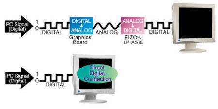

This picture shows the difference 😉

K.I.S.S. = Keep it Simple Stupid. The picture you posted was much more concise and to the point than my rather lengthy explanation, and thus, less confusing. 🙂
Oh now I understand
