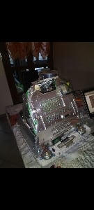

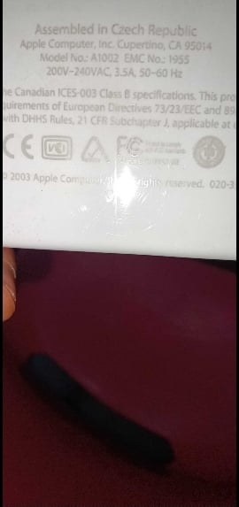

hello everyone, I have an E-mac model m8951t / a that when I try to turn it on by itself an impulse and then it does not start. I have already tried to start it without hhd, ram and pci. someone from how to help me?
Are you able to record a short video of what happens when you attempt to turn it on? That might help to provide clues as to the problem.
It could be an issue with the logic board and/or the transformer. Perhaps those with greater knowledge can weigh in.
The service manual might be able to help isolate the problem but you've listed the model as M8951t/a and it doesn't appear on the EveryMac list of eMacs.
Can you recognise the spec of your machine from that list? If so we can search for the appropriate service manual.

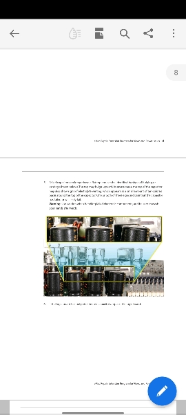

Thanks! Here's the eMac service manual. It appears to be general for all the eMac models. 🙂
Scroll down to page 111 where the troubleshooting steps are covered for resolving scenarios in which the computer will not power on.

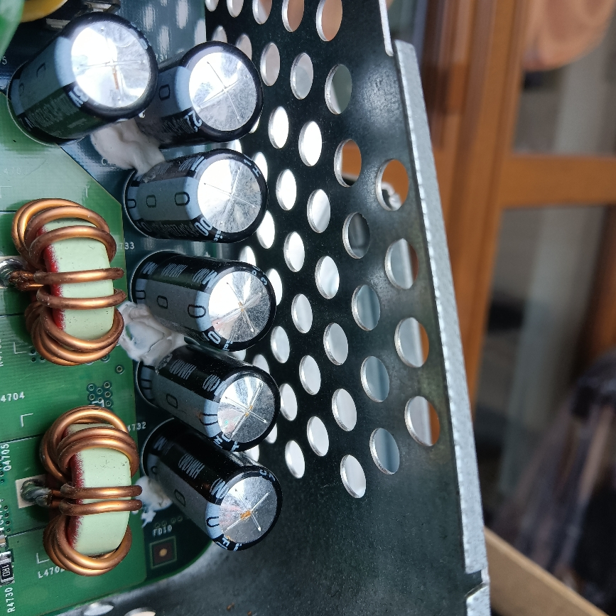

perhaps identifying problem ... capacitor ko ..
in the guide if they are swollen you have to change the logic board, mine in the following photo.

You can still find kits with replacement caps...

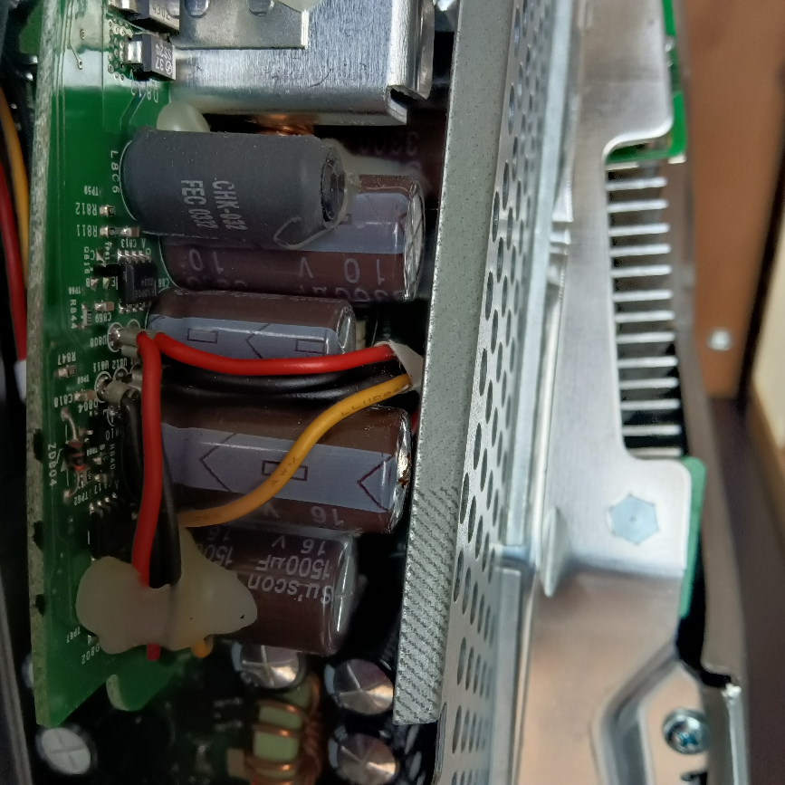

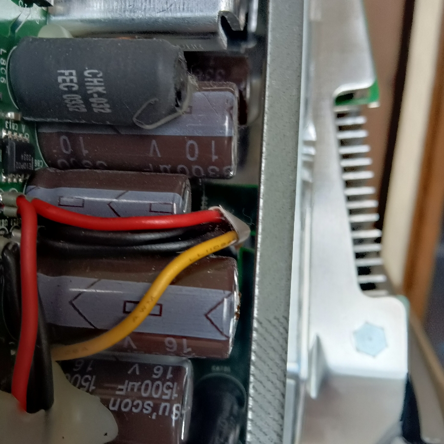

Are your caps visibly swelling/leaking? That can certainly result in a no-power symptom, and replacing the caps (should) get your eMac working again. However, your eMac is nearing 20 years old, and caps might not be the only fault... Good luck with that repair!
IIRC, all cap replacements in 2nd gen eMacs can use the same size caps.
Reactions: TheShortTimer
hello guys. ! I managed to resurrect my e-mac by changing the capacitors ... I wanted to thank you for your help!
