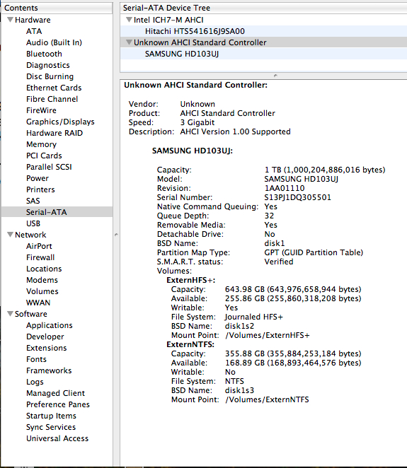

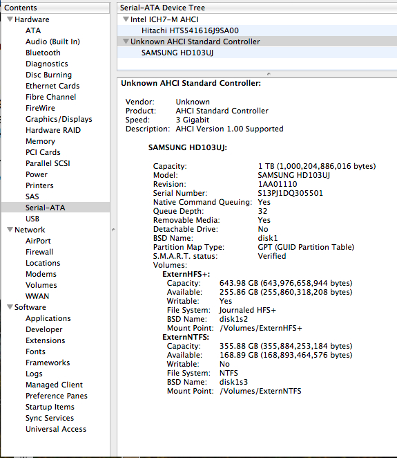

Today I decided to try my BC338 again. It had stopped working over three months ago. What I did to test it was this:
  • The MacBook Pro was running with the ioGear model GPS702e3 eSata ExpressCard/34 in its slot, but not connected to an external HD.
  • I right-clicked the mouse on the ExpressCard/34 icon in the menu bar and then clicked on Power Off Card.

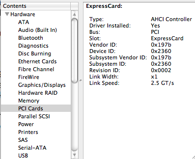

  • I removed the ioGear eSata card from the ExpressCard/34 slot. In its place, I inserted the BC338 card, with the eSata cable connected to a powered-down external HD.
  • System Profiler then displayed the BC338 under Hardware » PCI Cards » Type: AHCI Controller (see the first attached screen shot by clicking the thumbnail).
  • I turned on the power to the external HD.
  • System Profiler then displayed the external HD, under Hardware » Serial-ATA » Serial-ATA Device Tree » Unknown AHCI Standard Controller » SAMSUNG HD103UJ (see the second attached screen shot by clicking the thumbnail).
  • The application I used for testing was VMware Fusion, which has a Windows XP virtual machine running on the external HD.
So now the BC338 is working again, contrary to m85476585's post of December 30th. Can this have something to do with the fact that I had updated SL to OS X version 10.6.2.? Damned if I know. 😕
If I figure out under what conditions the BC338 works and under what conditions it doesn't, or if the BC338 again stops working, I'll post another message on this forum.
