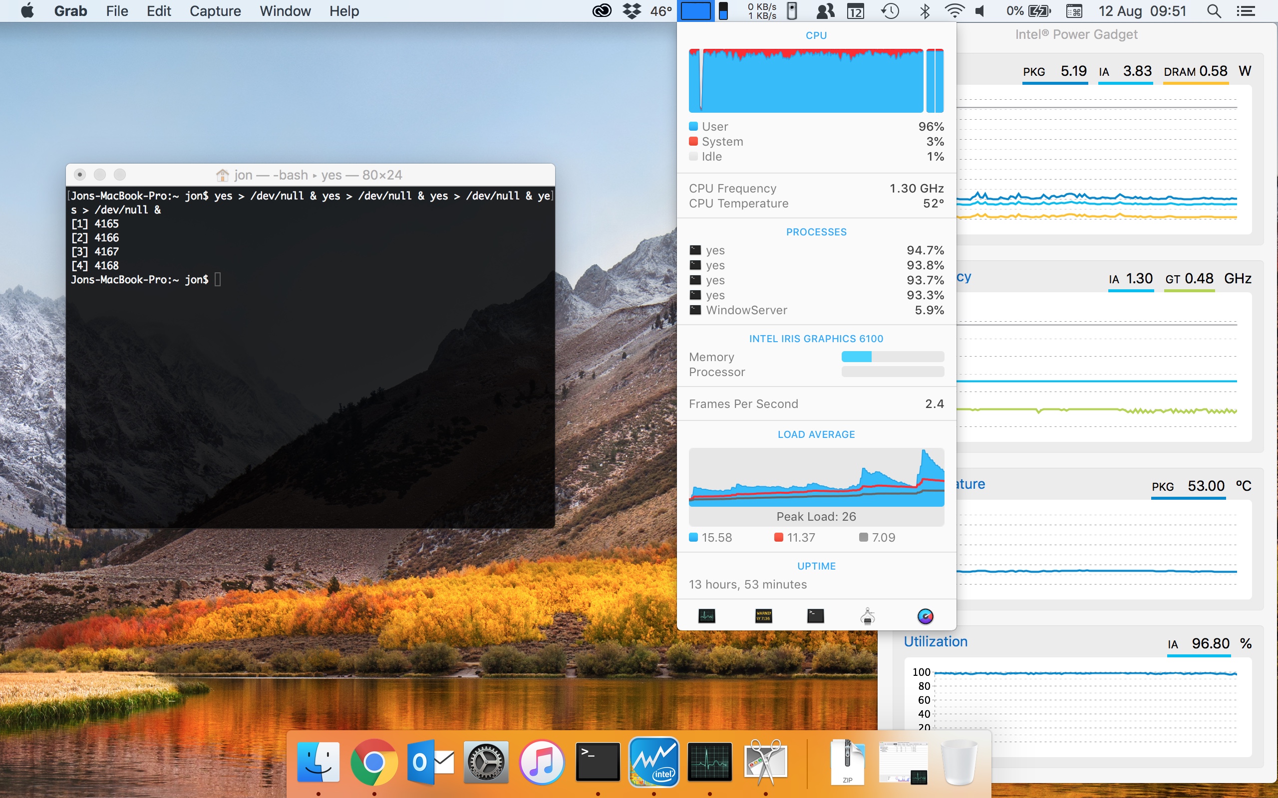

Thanks. I ran the yes command for about 10 minutes and the attached screenshot shows that the temperature is still <50C, the CPU frequency is still 1.3Ghz and the fans are not spinning.
