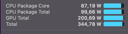

The 6,1 is very limited in thermal and power “things”, so it is more intelligent to use a CPU who is working under the specs apple is using. With D700 and CPU on load and USB stuff, perhaps you will see a: Bye bye power supply!
460 Watt PSU
Power consume when using OpenCL renderer on GPU and CPU, and I have only 2 x D500 and no USB drive for example. On Mac Pro 6,1 better use the save way.
