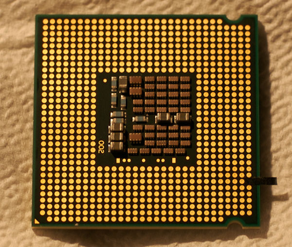

I think maybe you can. I didn't reread the article ( http://www.o0o.it/pro/ ) but if I remember right you have to mask out one pin and it works.
Notice the black tab on the right​

I don't think you can drop it in, no. That proc will not work in a MP1,1 or 2,1 as is. The pin mask described at that link, was done in order to get the 1333Mhz buss working so that's why I thought of that. There might be an outside chance that this mod would work with those procs.
