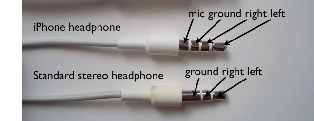

Actually, they have.. (Sort of) Its in the headphone jack, a.k.a multipurpose jack. So that headsets with mic can be used. Not sure when this was implemented..
Picture below to illustrate.. As long as the headset is "Made for iPhone", a.k.a has three rings in the plug then it should work.

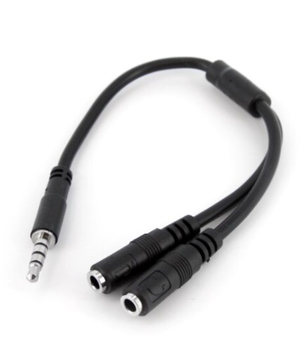

Edit: if the headset has 2 pcs of 3,5mm plugs (a pc headset) then you should be able to get it to work using a 3.5mm 4 Position (3 rings) to 2x 3 Position (2 rings) 3.5mm Headset Splitter Adapter.
Something like this
http://www.amazon.com/StarTech-com-...tter-Adapter/dp/B004SP0WAQ/ref=cm_rdp_product
