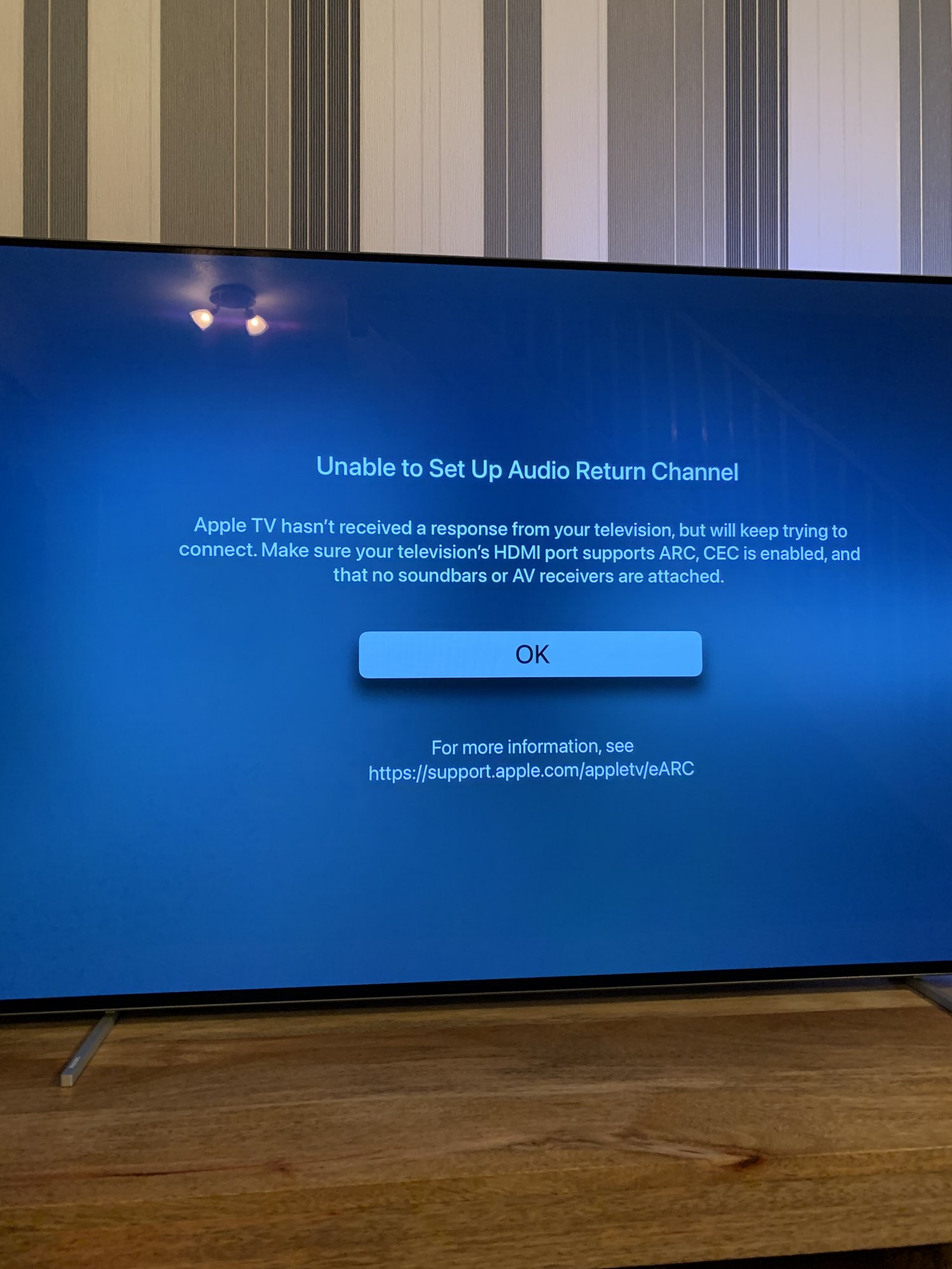

Good morning all.
Sorry if this has been mentioned before but i get an error when trying to enable earc.
I have selected Homepods as default speaker, have them connected to earc HDMI port, using Apples Belkin high speed cable. What do i need to enable for this to work and where?
I have a Sony Bluray player connected to Arc HDMI and I would like for sound to be played on Homepods.
TV is Philips OLED 806 if this helps.

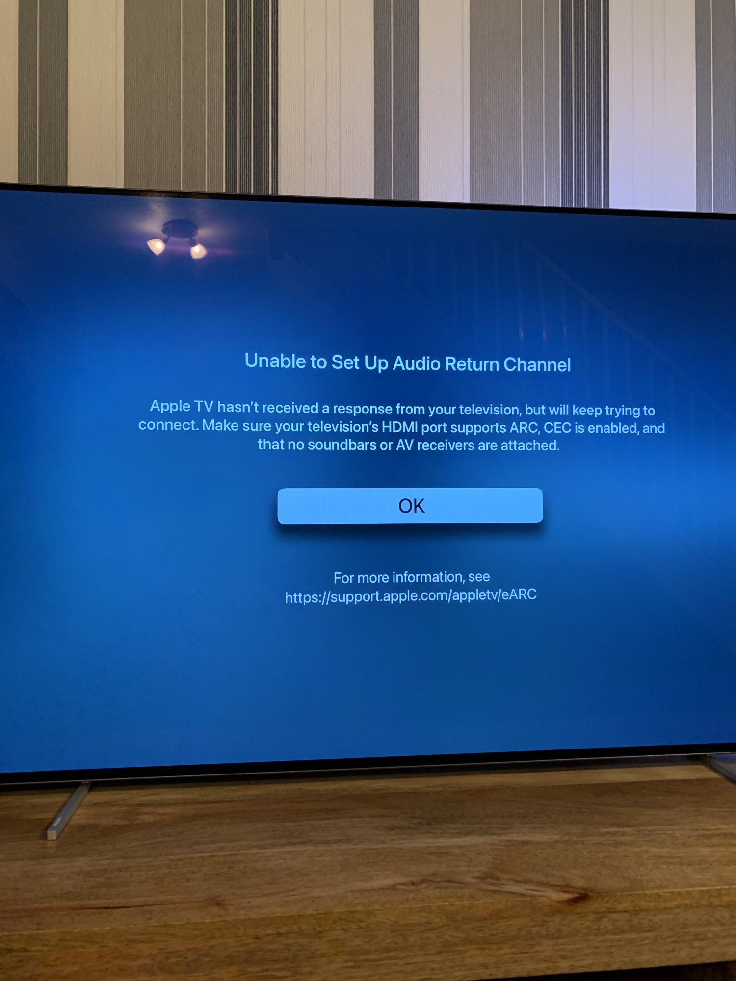

Good morning all.

I am a bit lost by your reply sorry.
To clarify- Apple TV connected to HDMI 2 - earc - Belkin 48 GB cable
Bluray player connected to HDMI 3 - arc with HDMI cable.
What to enable in settings for this to work?
Earc is set to automatic in settings of TV.
Thank you for the help.
Use your TV as an HDMI hub. Plug the Homepods' HDMI cable into the TV's eARC (HDMI) port. Plug all other HDMI devices into the other HDMI ports. Check your TV's manual for its AUDIO settings. Ensure that eARC is turned "on" if not that way by default. Assuming that the Homepods, TV, and Blue-ray player are working properly, you're done.
ATV plugged into earc port.
Bluray player plugged into ARC.
Homepods paired as default speakers.
earc set to automatic.
what settings do i need to enable/disable?

I am lost because Homepods don’t have a HDMI port.

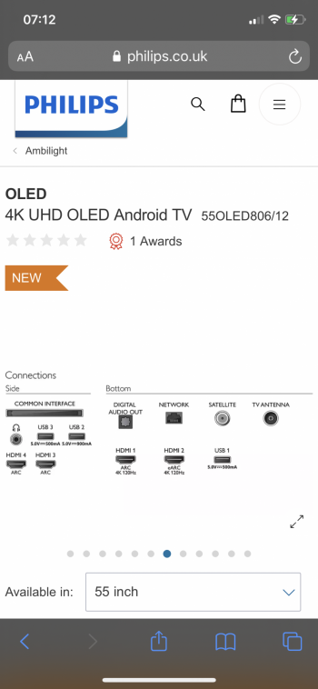

My TV has: one earc port- HDMI 2, one 120 Hz Arc port
Two Arc HDMI ports
The Bluray player is plugged into HDMI 3- Arc
what am i missing here? 😔
Two Arc HDMI ports
