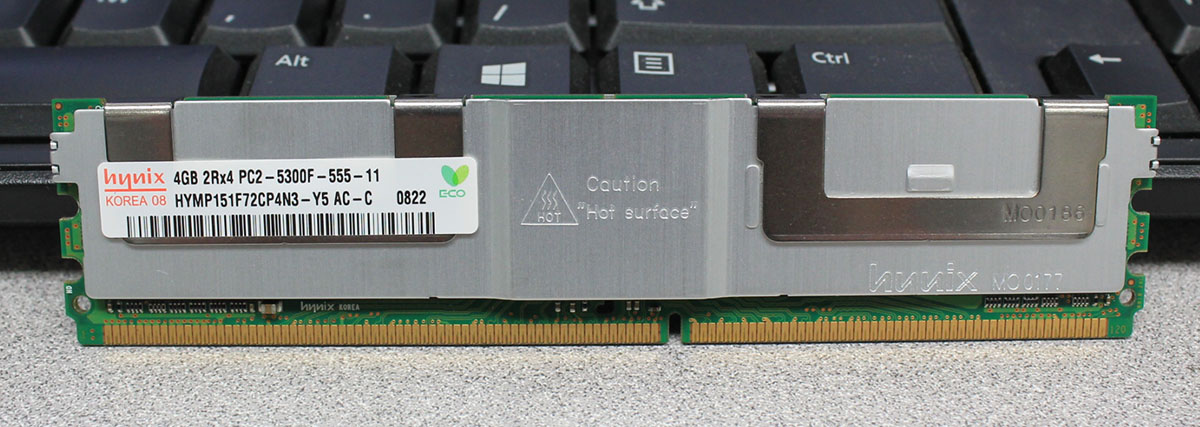

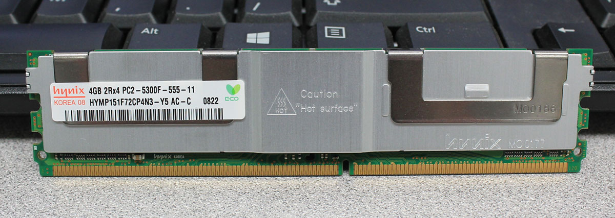

You can get an entire 667 MHz 32GB kit (8 x 4GB) for around 30-40 bucks on eBay .
http://www.ebay.com/itm/32GB-8x4GB-...038711?hash=item2eeca9adf7:g:~GQAAOSwAuNW4a9X
Hynix model HYMP151F72CP4N3-Y5 .
The only thing you have to worry about is the Mac will not detect the thermal sensors of the memory modules , so you might have to manually adjust the case fan rotations with Macs Fan Control .
You do not need those fancy fat heat spreaders qualified by Apple . Flat spreaders are fine .

You can get an entire 32GB kit (8 x 4GB) for around 30-40 bucks on eBay .
