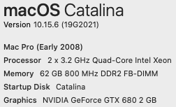

Is there such a thing as an early 2008 dual 2.3 GHz quad-core?
What does it say when you go to About This Mac --> System Report?
Is it MacPro1,1 or MacPro2,1 or MacPro3,1?
I think he meant 3.2 GHz? Like this:

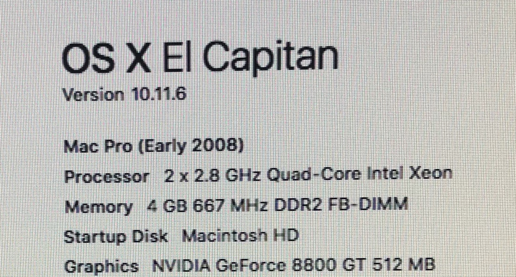

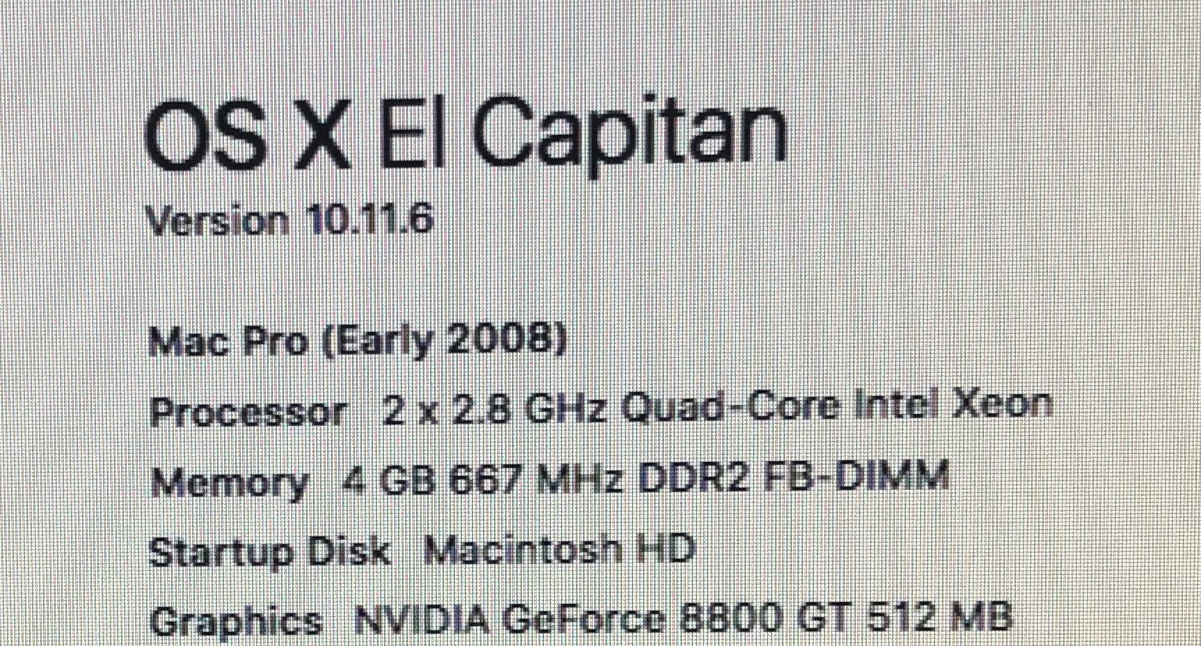

The screenshot post #7 shows 4GB RAM...
So if you installed 8X8GB RAM ,it's incompatible or defective.
If possible install the RAM modules that were installed before ,test and post a screenshot.

The screenshot was taken prior to my installing the new RAM. It was doing the self sleep issue prior to the ram install so I don’t believe it to be a RAM issue. Also it did turn in and I could see all sticks were working properly I just didn’t grab a screen shot unfortunately.

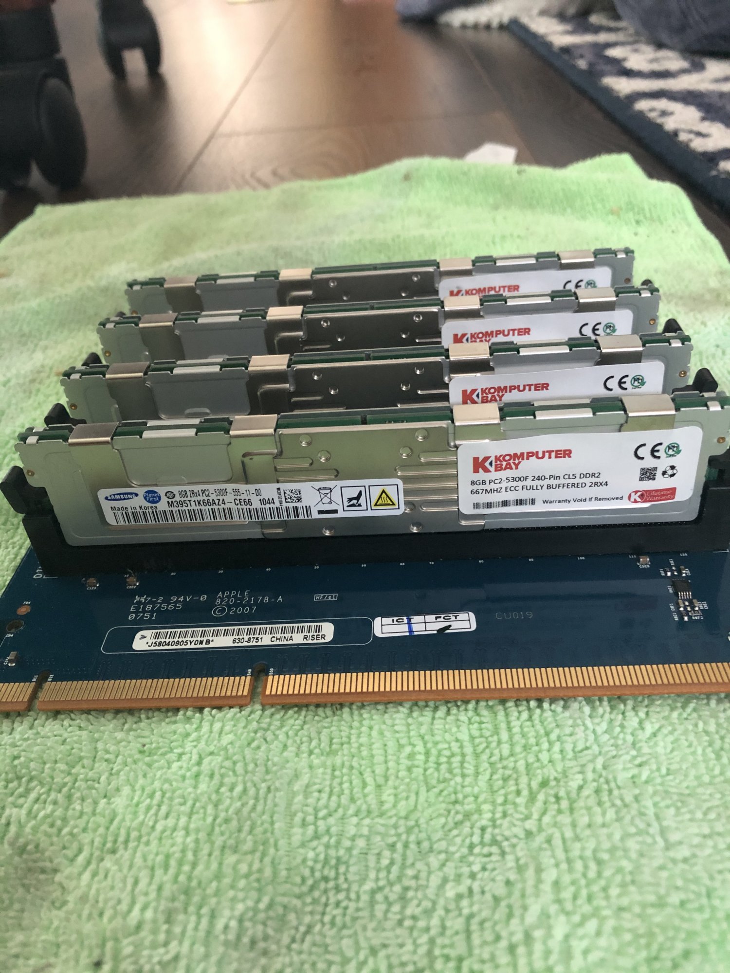

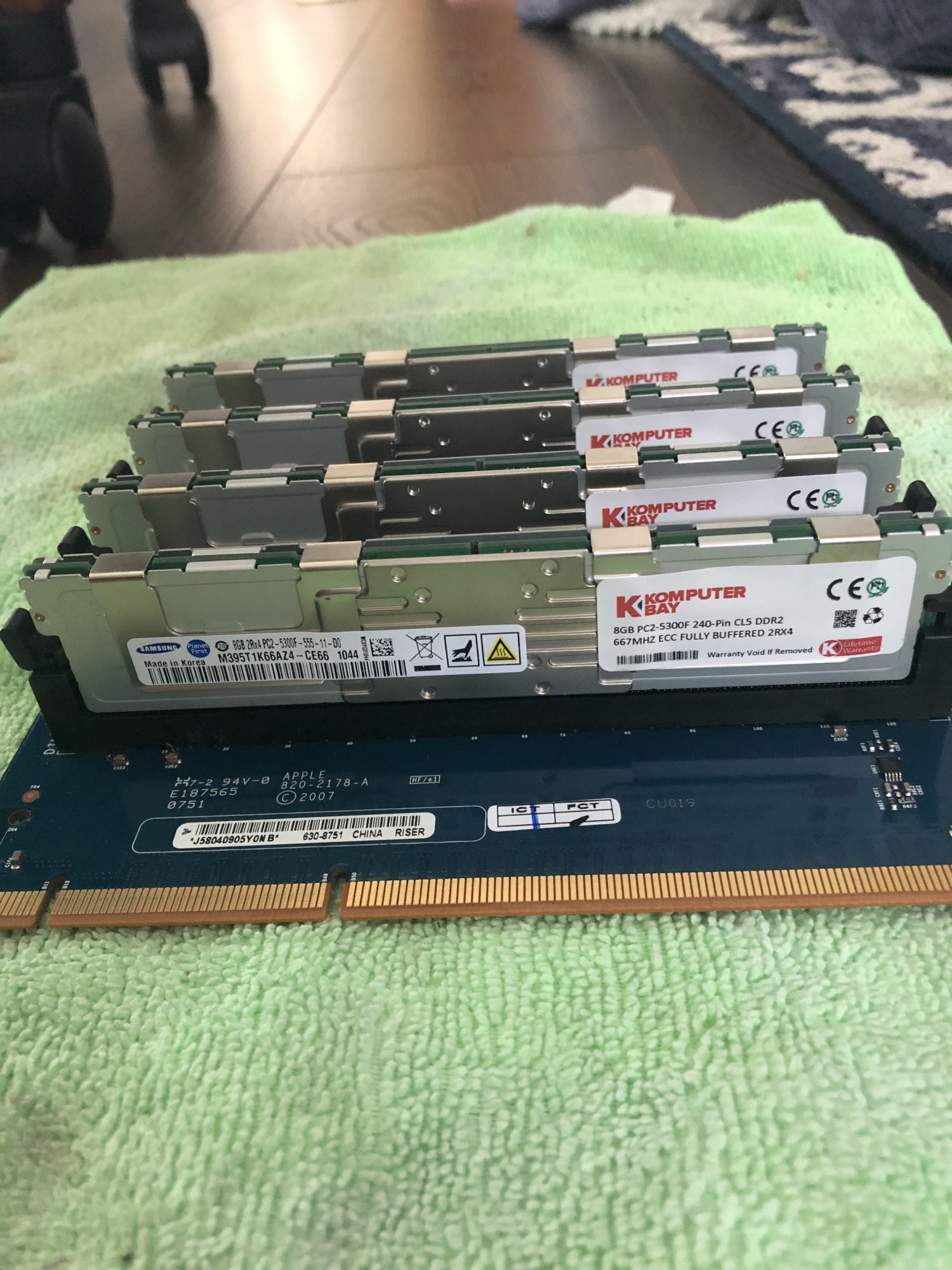

It is certified compatible with Apple, however it looks completely different than the original ram in the computer, (the heat sinks, not the pins). The biggest reason I don’t think it’s RAN related is because it was doing this prior to the ram install. I had hoped giving it more ram would allow it to run better.

It may be something else as you say, but I wonder if there may be something going on with the RAM too, since your screengrab says only 4 GB is detected. Post a picture of your RAM and how it's installed in your risers.
BTW, low amounts of RAM should not cause system instability. El Capitan boots perfectly and runs just fine with 4 GB RAM (if all you want to do is boot the OS and run one or two simple applications at a time). It even boots fine with 2 GB (but speed with 2 GB will suck).
If you have the side panel off, when the machine is on, do you see the red RAM error lights come on, on the RAM risers?
As for "certified", I don't know what that means. There is Kingston RAM that is certified to run specifically with the Mac Pro 3,1 (800 MHz) but there is also RAM that might be certified for older models (667 MHz) that isn't supposed to be used in the Mac Pro 3,1, at least in a mixed RAM configuration. Furthermore, there is Kingston RAM with different heatsinks that is "certified" just by the seller to work in the Mac Pro 3,1 and which will work if installed in a proper configuration, but which can cause all sorts of problems if you don't know exactly what you're doing.

That RAM could be the culprit. It’s not quite the right RAM for your machine. If all is working perfectly it usually should work (at 667 MHZ), but often it isn’t all working properly. And you said you get the red error light. If it’s a persistent red light then there is something wrong.
If you have at least 2 GB RAM with the proper heat sinks then take out ALL of that new RAM and put back the proper RAM. As little as 2 GB of proper RAM will be sufficient for testing purposes. And make sure everything is seated properly before starting up the machine again.

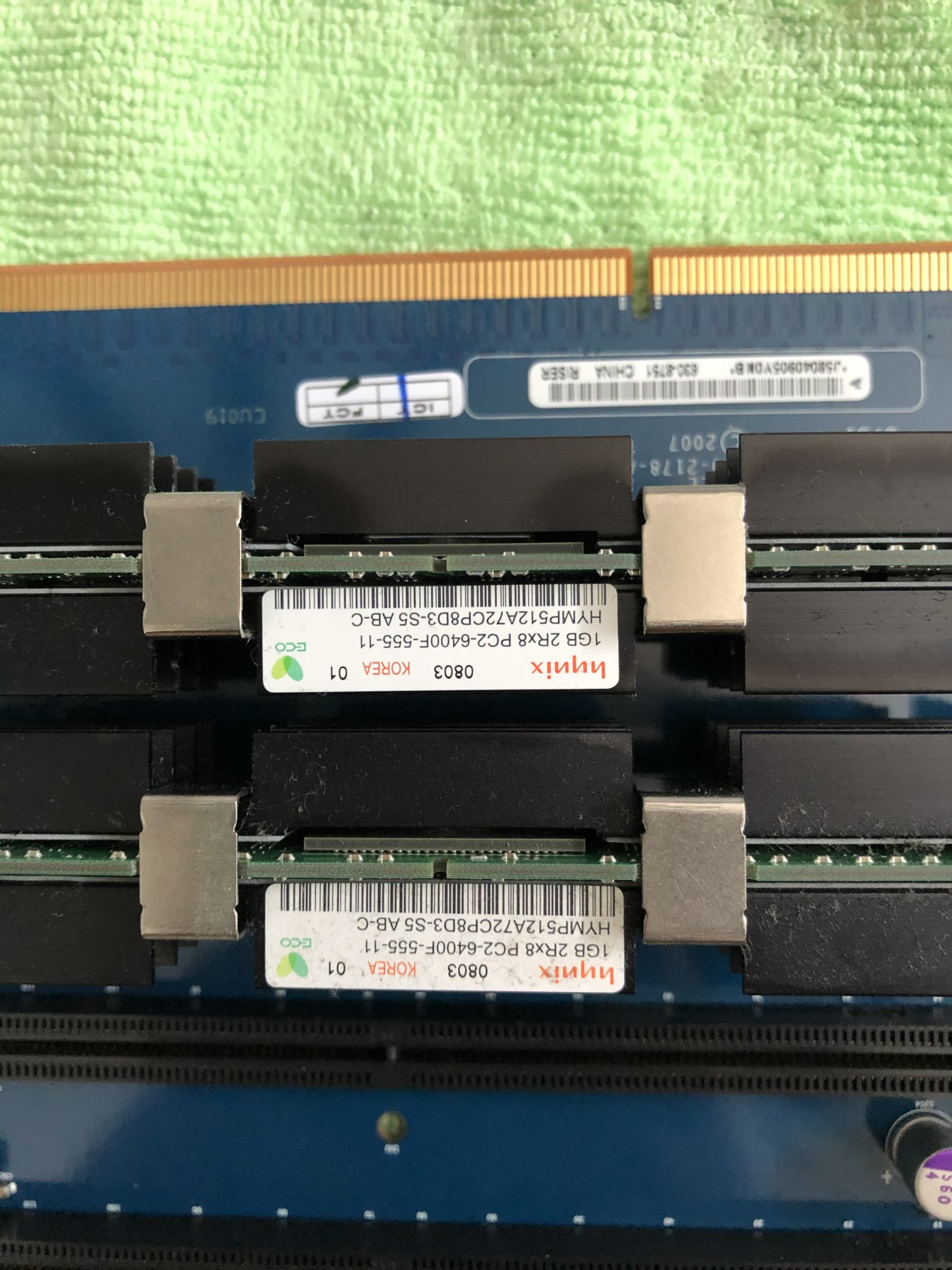

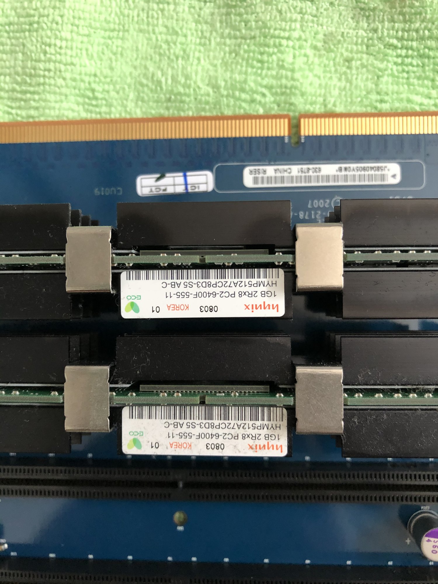

I took out all of the new RAM and installed just the original which I believe to be this
The screen still won’t turn on. The power light is on and the fan is running loud but no start up screen.
Yes that is the proper RAM for you, and you have 2 GB so that should be OK. Hopefully the RAM is still good.
