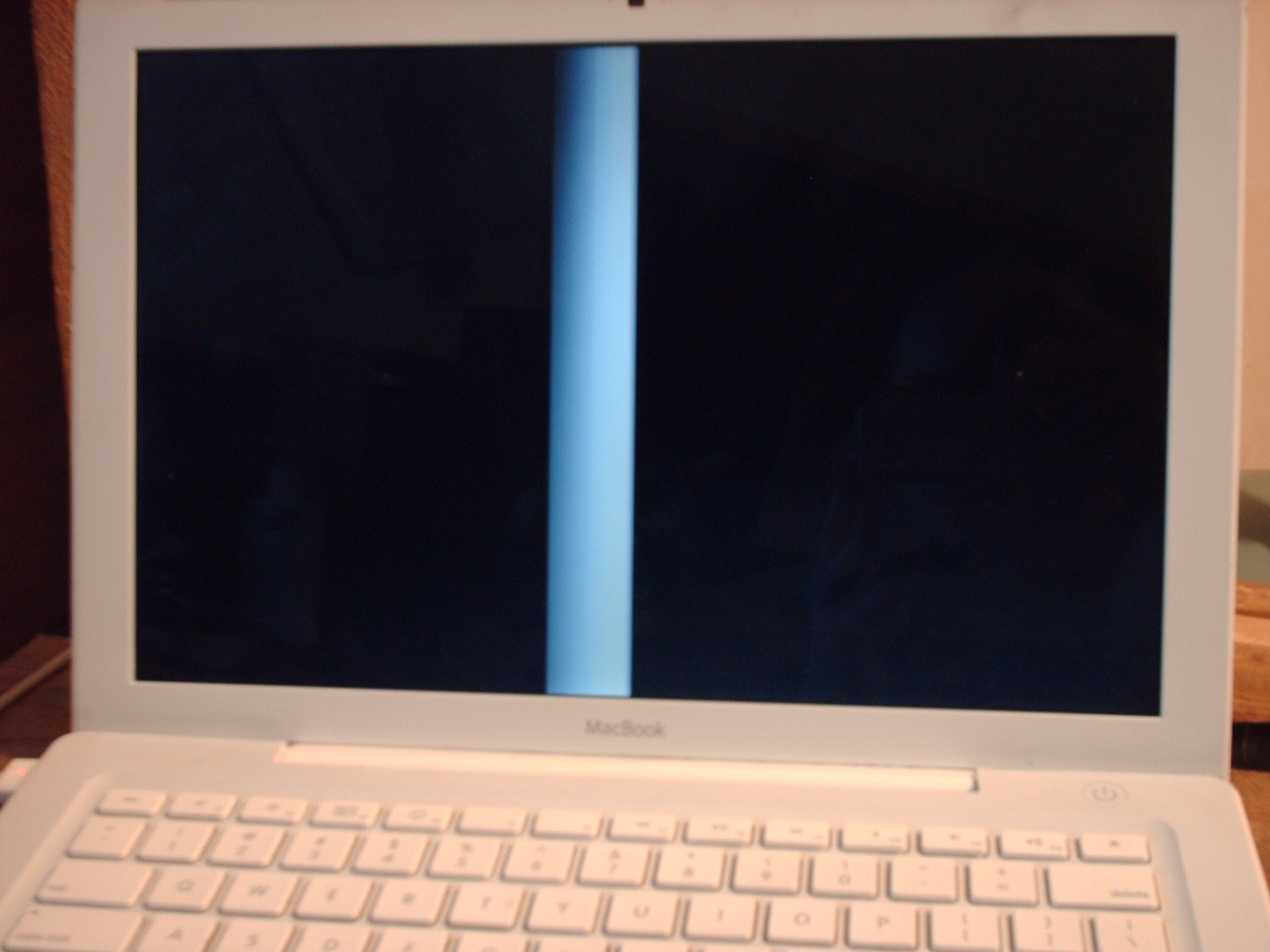

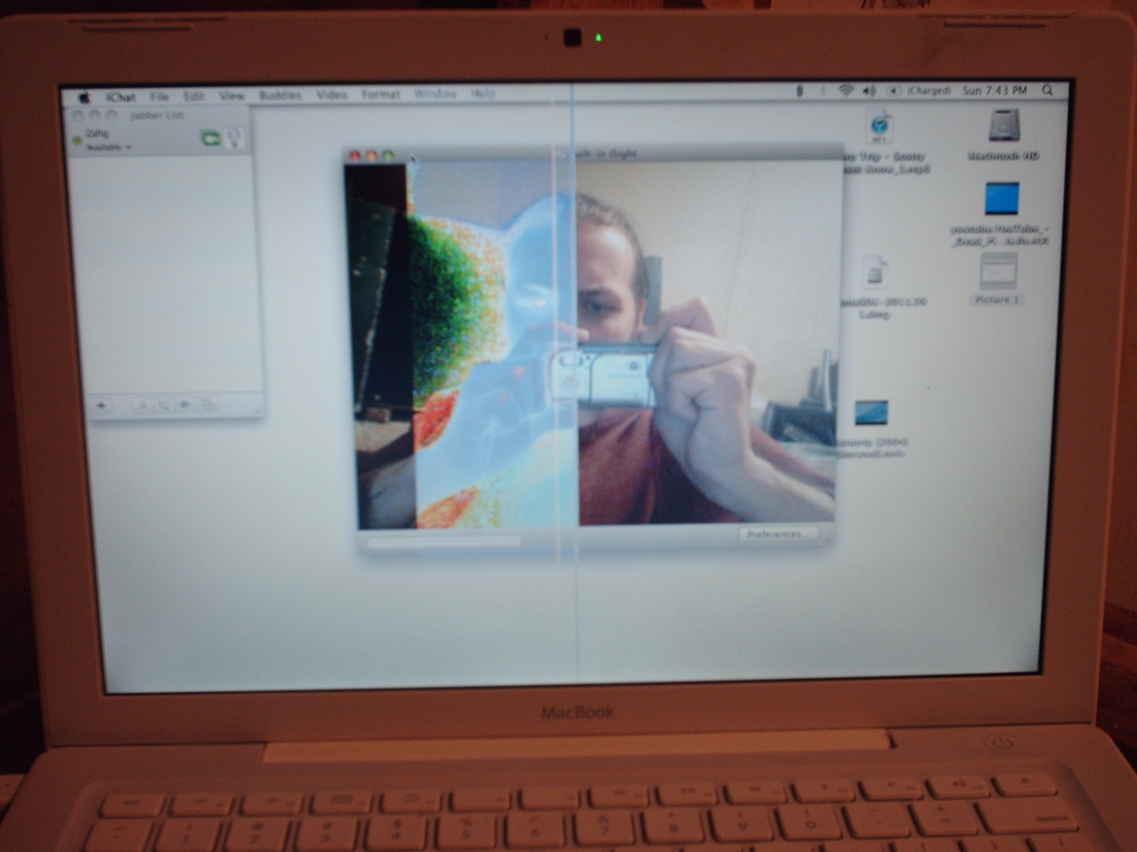

I got this the other day off craigslist for $250 (270 if you count gas money to pick it up) =p.
Anyways, it has this vertical bar from in the left-center of the screen. It's not dead pixels, you can still see 'behind' it, but everything behind it turns slightly negative.
Could this be a driver issue, is it 'image persistence', or should I just replace the LCD?
Thanks.

Looks like an issue with the connection between the LCD and the logic board. I'd open the little bugger up and check to see that the cable is securely attached, and then check the integrity of the cable itself along its length. ifixit.com has many good tutorials on taking apart your new MacBook. Good luck!
Thanks for the quick response.
Reseated the cable, no change.
The cable itself seems fine, no kinks or tears.
Is there a way to un/re install the gpu driver? Besides a full OS reinstall?
I'm starting to doubt its a software issue(booted into safe mode, still there. Does OSX load the same gpu drivers in safe mode? Took a screenshot, it doesnt show up.) But I would like to be sure before shelling out another $100 on a new screen.
If it doesn't show up in a screenshot, then that means that the system is outputting a good video signal, but it is getting mucked up somewhere after the system generates it. If the cable is fine, then it sounds like it is indeed the LCD itself. You may want to plug in an external monitor and play about with that for a little while to make sure that the video system is working properly, and assuming it is, it would seem to be time for a new LCD.
And while you're at it, get that poor thing a new screen bezel that's not all cracked up 😛
