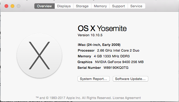

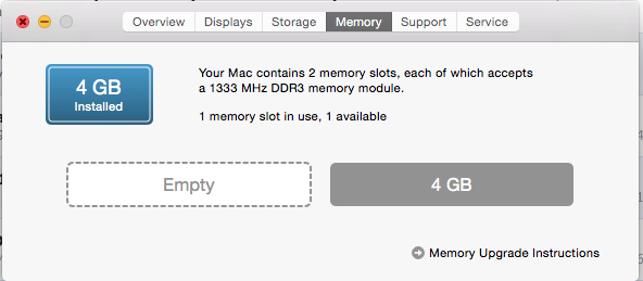

Test result.
My iMAC ran fine with 1 4GB 1333Mhz SODIMM modules. It recognized the SODIMM at exactly 1333Mhz as well.

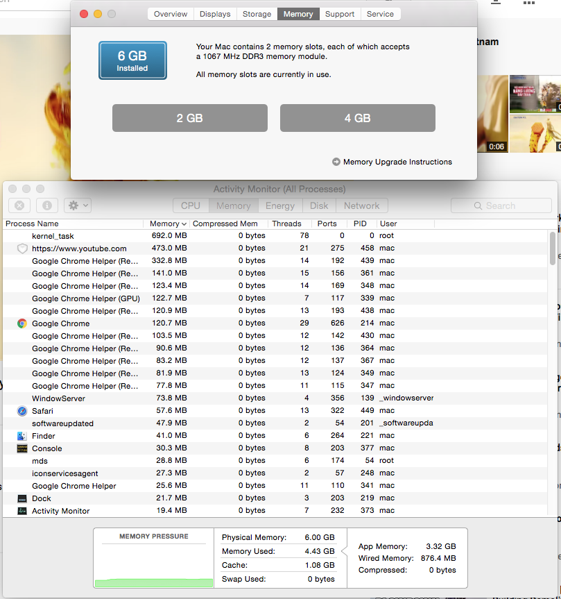

When mixing 2GB of 1066Mhz and 4GB of 1333Mhz, it ran at 1066Mhz. (Brand: the 2GB module is Sk Hynix, 4GB module is Kingmax)

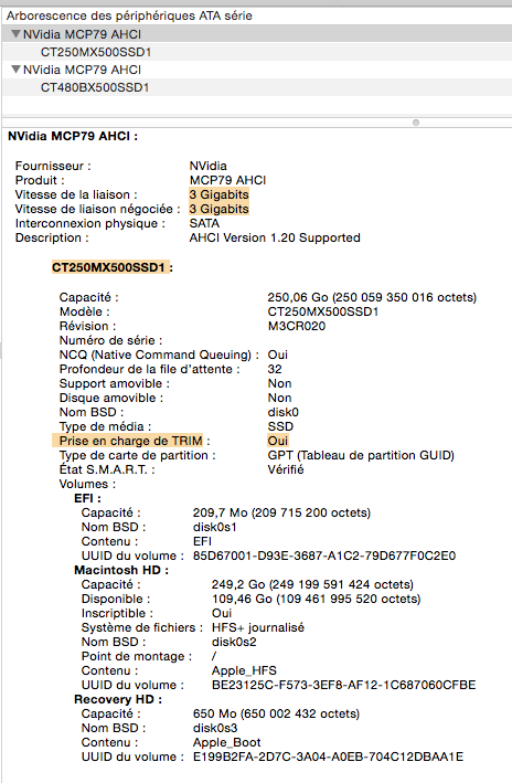

Tested Crucial MX500, ref. CT250MX500SSD1, controller Silicon Motion SM2258
- as main drive, no boot problem, SATA II negociated at 3Gb/s

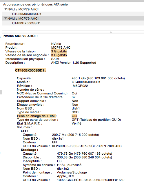

Tested Crucial BX500, ref.CT480BX500SSD1, controller is Silicon Motion SM2258XT (DRAM less controller)
- as second drive instead of Superdrive, check at reboot System profiler, got only 1.5Gb/s, but, I did a SMC reset, then a PRAM reset with 4 startup chimes (bong), then got it fully working @3Gb/s .

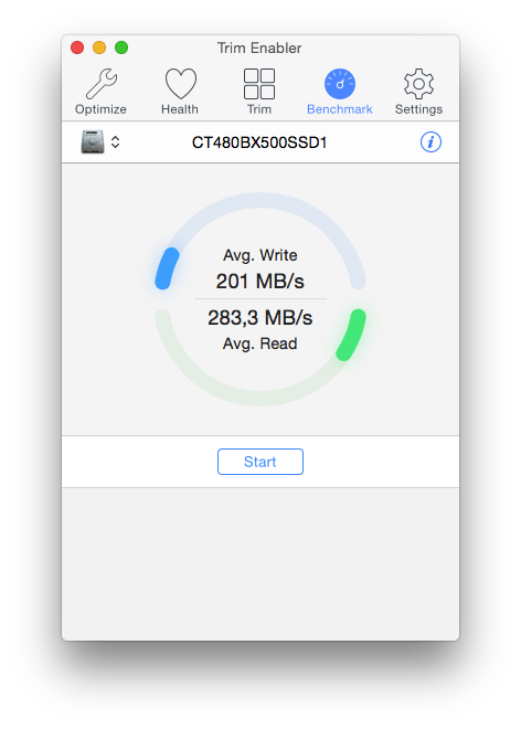

Benches are showing close to the same transfer rates, which I guess, are fully filling the SATA II bus.
I have onlw noticed that both SSDs had TRIM deactivated, and had to activate with sudo trimforce in terminal.
