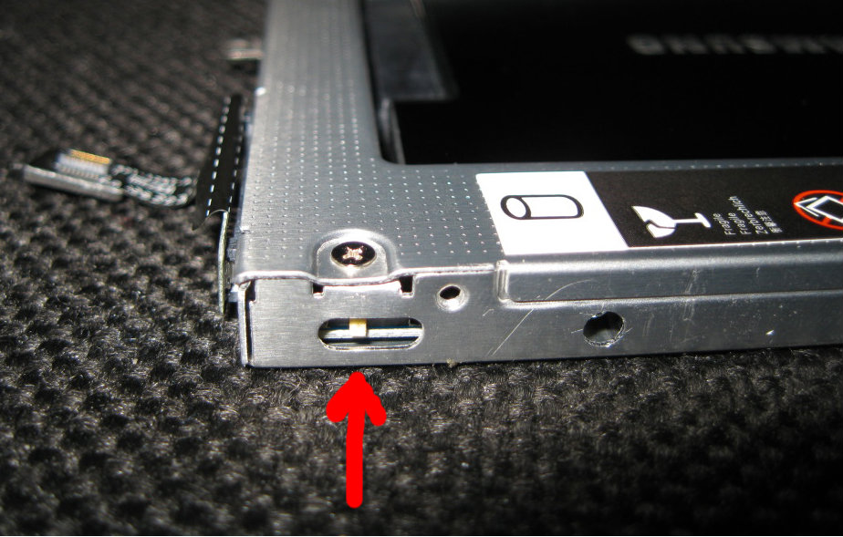

Also, I did notice there was a switch of some kind on the optibay I got (generic eBay optibay, for the record). Attachment a pic of what I'm talking about, any idea what it's for? I tried switching it with each different drive installed, it didn't change anything though...

I have an early 2011 15" MBP with SATA 3 in both bays as well. I bought the OWC data doubler and put a WD Scorpio Blue 1TB HDD into the optibay and had no issues for almost a year now. So one suggestion is to try a different caddy in your optibay to eliminate that as a possibility of your issue.
Not a bad idea, I've also heard the superdrive cable is a weak point, but I reinstalled the superdrive and used it to install windows via bootcamp, so I know it's fully functional still.. The weird part to me is that it makes disk utility fail to even open sometimes (pinwheel until I have to force quit), and even when I boot with the snow leopard install disk (superdrive in external case) I still couldn't even open DU... 😕
